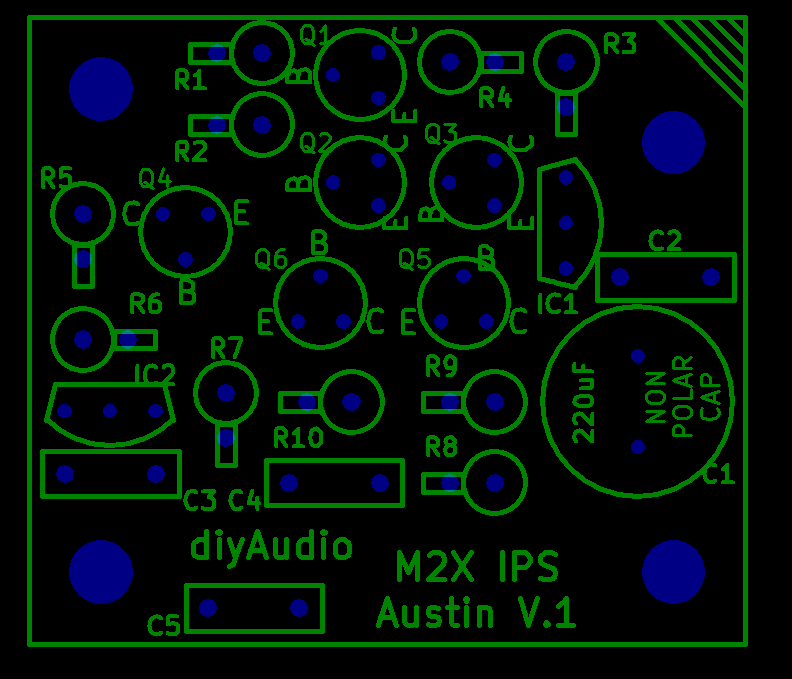

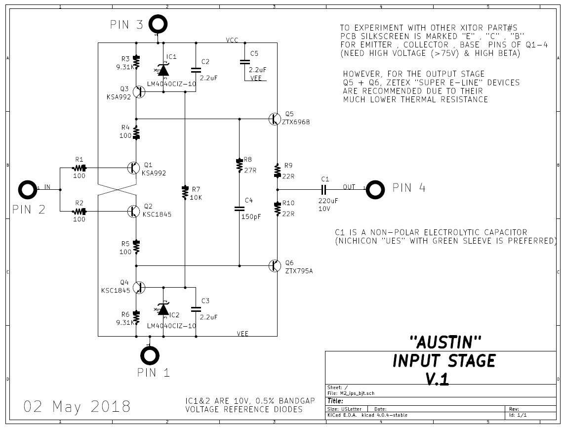

The Austin input stage is especially designed to appeal to the GreedyBoi aficionados of Pass Labs discussion threads.
First of all, Austin anticipates rampant substitution or optimization of individual components: all possible pinouts of TO92 transistors (and E-Line transistors) work equally well in the board layout; their footprints are intentionally symmetric.
Second, GreedyBois and their simulators will (I suspect!) quickly discover which parts to finagle and which parts to futz with, to allow themselves to eliminate Austin's output capacitor. I'm confident the GreedyBoi modification will turn out to be difficult, requiring lots of painstaking care. Perfect for masochists!
Third, there's a lot of components on the board, providing a lot of opportunities to make a soldering error. GreedyBois just love do-overs and revisions.
I added the following paragraph to post #1 at the top of this thread:
AUSTIN is a thru-hole board with 4X more components than the other boards; its resistors are mounted vertically to save PCB area. This permits a Diamond Buffer circuit with high performance, precision current source loads. Builders who love parts substitutions / optimizations will appreciate that Austin's PCB silkscreen doesn't indicate transistor orientation. Instead, transistor pins are labeled B, C, E in a perfect circle; allowing you to drop in Japanese 2SA/2SC transistors (pinout ECB) or European BC transistors (pinout CBE) or American 2N transistors (pinout EBC) however you please. Austin is recommended ONLY for experienced builders. If you're a newbie, hire someone to solder your Austin board!!​

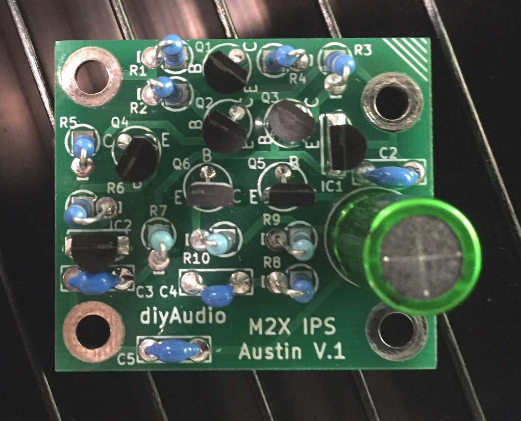

Compared to the other M2x daughter cards, Austin is kinda busy. That's not to say you can't successfully solder it yourself. You can. I did. But it's not especially easy and you need to go very very slowly, check and double check before each component.
My poor quality photograph is below; I'm sure 6L6 will snap at least one very very good photo of an Austin, when he receives my shipment. edit- if you look closely you can see in my photo that Q5 and Q6 are Zetex transistors in the slender E-Line package. All others are TO92.
The good news is: when you build a couple of Austin boards and bolt them into your M2x amplifier, I think you'll be very pleased with the results.

that's Sissy busy ........ piece of cake :clown:
DB can sound very good ..... for now I have it as (penultimate) iteration of buffer in my Iron :Pumpkin: , soon to be effectively replaced ........ not so because of sound , as much because of search for even better TempCo (no caps in signal path) and less mechanical work involved

If 13V is safe and 16V is safer then 50V is a whole lot safer. If you're scared, you could always solder a 1N5247B across the capacitor on the bottomside of the board.
I certainly don't mind spending your money on a capacitor with tremendous excess amounts of safety margin. Not when I know you're probably going to bypass the $3.00 electrolytic cap with an $8.00 (or is it $80.00?) film capacitor.

well , nothing wrong with that sort of thinking
