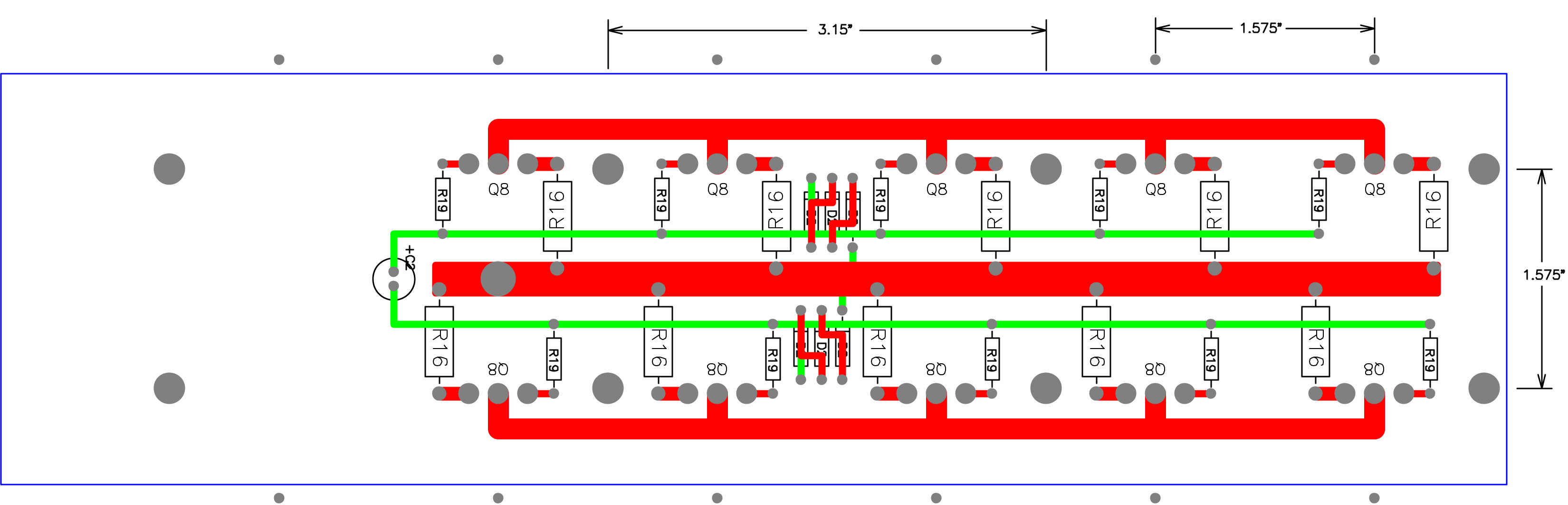

Somewhere, can't remember where, I promised some work on the AB100
pc board by way of update, and later decided that I would try melding it
with a modular output stage that would support an open design and
make it available through the store.
Toward that end I started fitting it to the UMS spec of DIYaudio, and here
it is currently, with up to 10 output devices and room for the 20 pin
socket holding a front end.
At this point I am just entertaining the notion of a layout that looks like
this with something like these dimensions.
These pinouts support complementary followers for TO-3P type packages
in both Bipolar and Mosfet. Digikey shows 95 such Bipolars.
Comments welcome.

Does the 20 pin socket you chose allow for a keyed positioning of the PCB? That would help less experienced builders avoid a mistake when attaching the front-end board.
Also, in the case of the AB100 amplifier, I believe many of the people interested in the project were expecting to hear your recommendations to replace the obsolete devices in the published schema.

Very nice. Its M2X-ish as someone could make a unique input/driver board.
Would any benefit accrue from having hooks in the layout for soldering fat solid copper wires/rods to reduce the resistance of the high current traces?
I could see making the emitter resistors smaller if the output transistors were tightly matched thus making the resistance of the traces a critical path.
You could always re-layout a motherboard yourself, and include both wide traces and also buss-bar layout options. AWG-10 solid copper rods, or horseshoes, might be possibilities. Or machined aluminum bar stock.Would any benefit accrue from having hooks in the layout for soldering fat solid copper wires/rods to reduce the resistance of the high current traces?
The difficult part is circuit design, which First Watt has already supplied. All you need to do is lay out that circuit design on a PC board according to your own goals, with the power enhancements and optimizations that you have dreamed up.
Then plug in one of the front end PCBs using the new DIP-26 interface standard and Bob's your uncle.

Is there a definitive write-up of the DIP 26 interface standard? I spent some time with the search feature to no avail.
