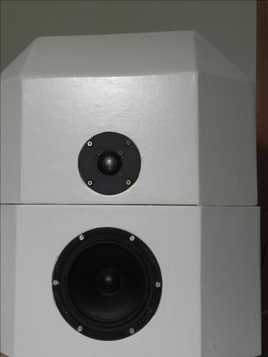

Which is why my latest speaker has a first order series crossover.
Took several weeks "to work" train journeys in PCD to get a first cut (make driver models and all). Then messing a lot with values I found that things tracked quite well giving a huge degree of tolerance before getting bad... The practical implementation too around 2 Hours...
With a digital crossover and more amp's it would have taken a lot less thyme (and parsley and sage and rosemarine), but I do not have three channels of good (not blameless) amplifiers at hand right now...
So always horses for courses.
