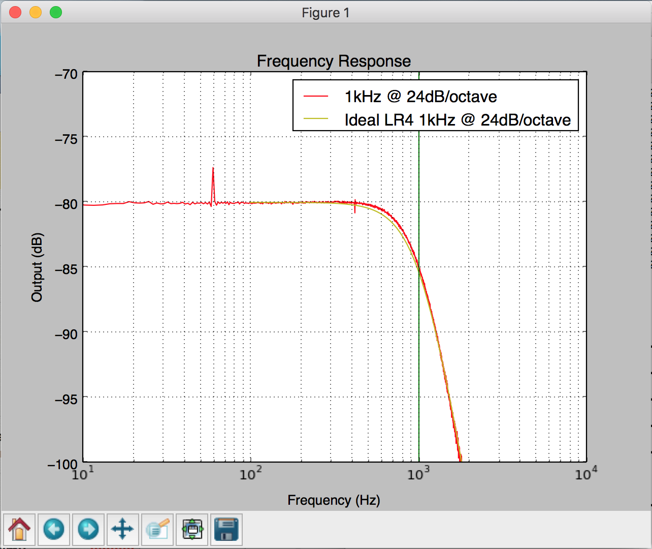

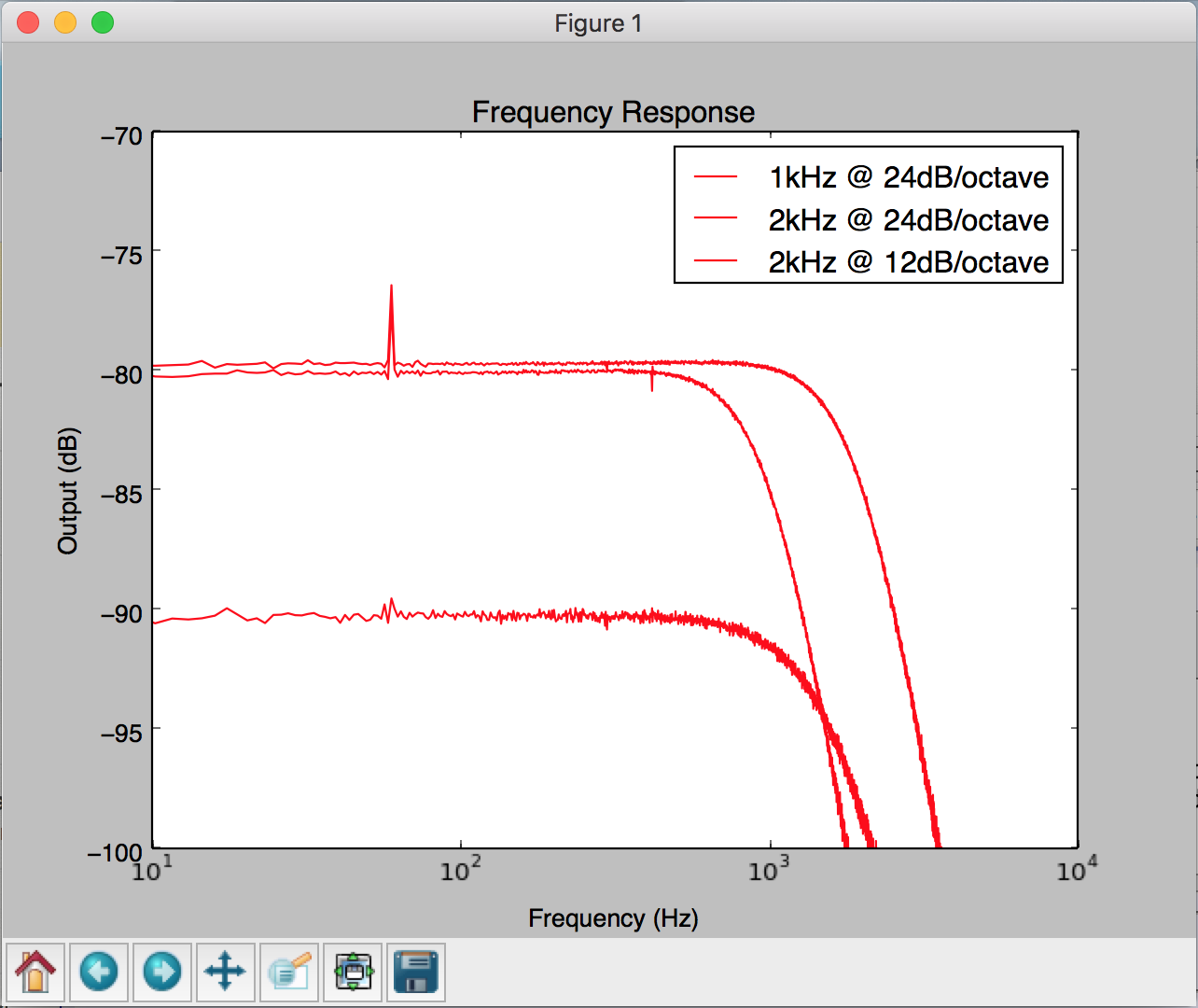

ok, i have a number of measurements from my actual circuit. I'd like to compare them to the ideal function using curve fitting function in Python. My question is, what are the proper functions to calculate gain as a function of cutoff frequency and Q?
I think for second order low-pass filter this would be:
H_LP = K / (-(f/f_c)^2+(j*f/Q*f_c)+1)
Can I just ignore j here (assume it is 1) as I'm not interested in the phase, just the magnitude?
This is for second-order (12dB/octave) and I realize that 24dB/octave is two cascaded together, but how do I get a similar equation for 24dB/octave? Same with the characteristic equation for a first-order and third-order.
I know really simple question, but this will allow me to check my circuit.

Well, this ended up being real easy!
Code:
import numpy
from scipy import signal
def lr(filter_order, w_center, btype='lowpass', analog=True):
butter_order = int(filter_order / 2.0)
num, den = signal.butter(butter_order, w_center, btype = btype, analog=analog)
num = numpy.convolve(num, num)
den = numpy.convolve(den, den)
return num, den
