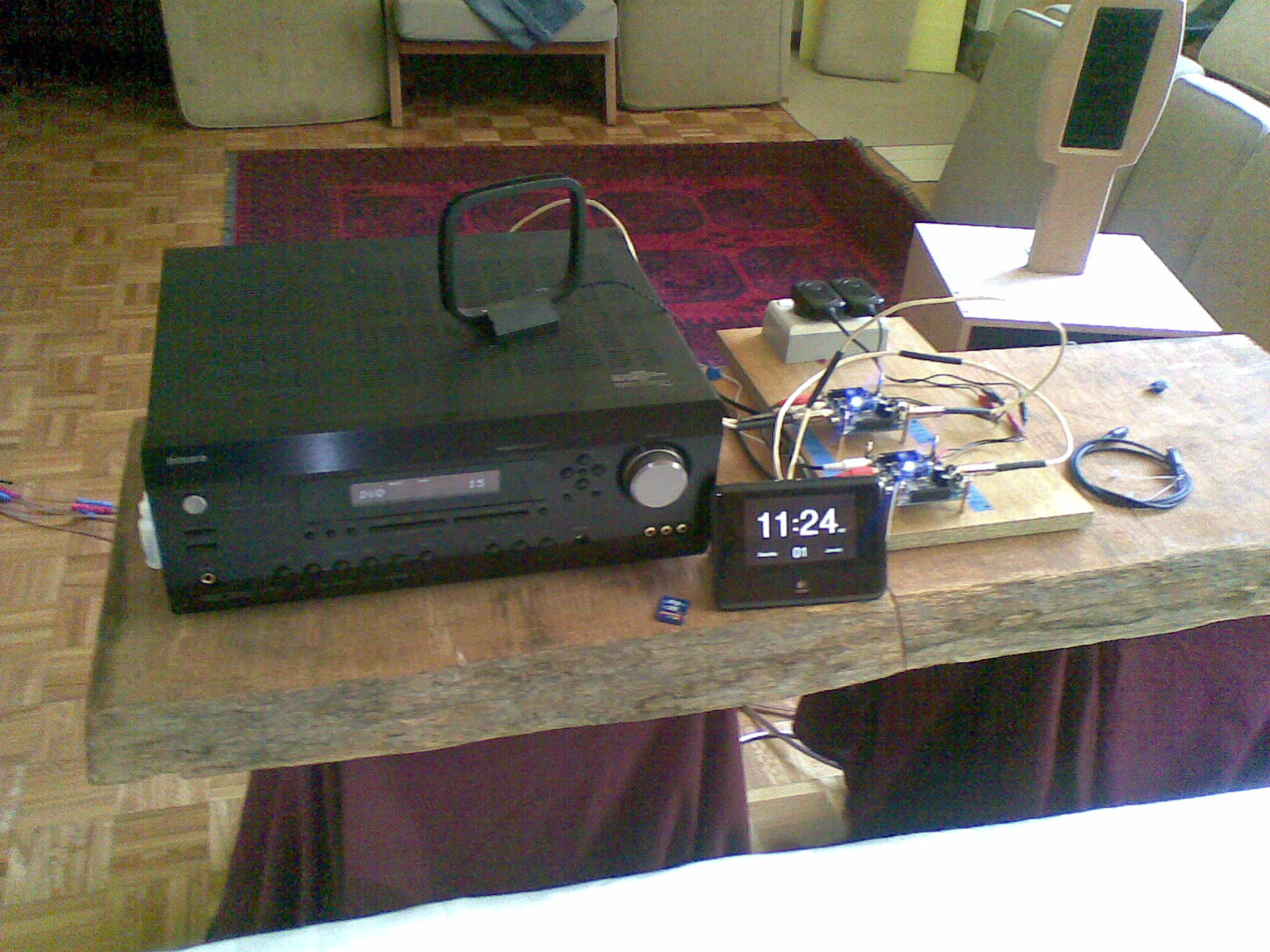

MiniDSP $200.00 for 4w stereo+ two cheap PS (I used old phone charges) & away you go, 1hr & you making all of the changes you probably ever need.
David
PS: except some people might prefer it in a case😀
