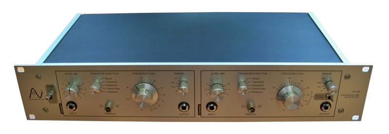

It just so happens that I have a great article for a diy active xover in Linear Audio Vol 1. See pic.
But it'll be some more weeks...
jan didden
