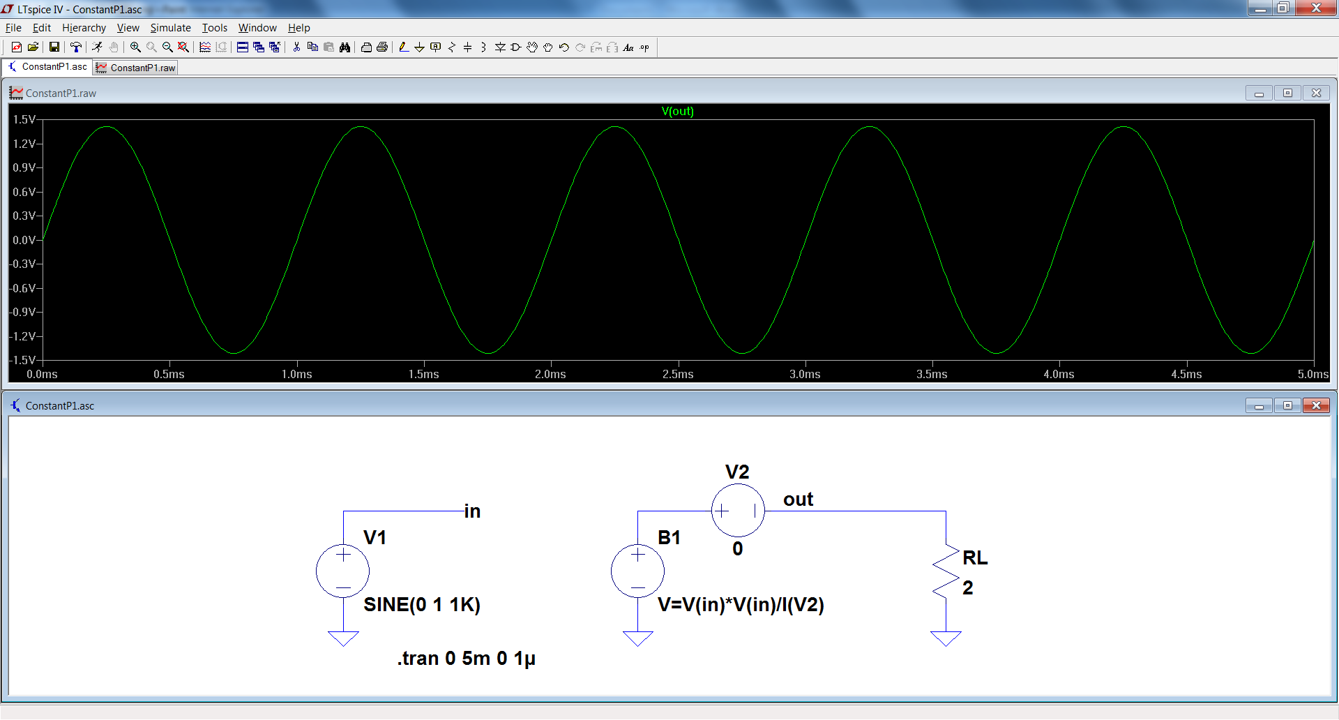

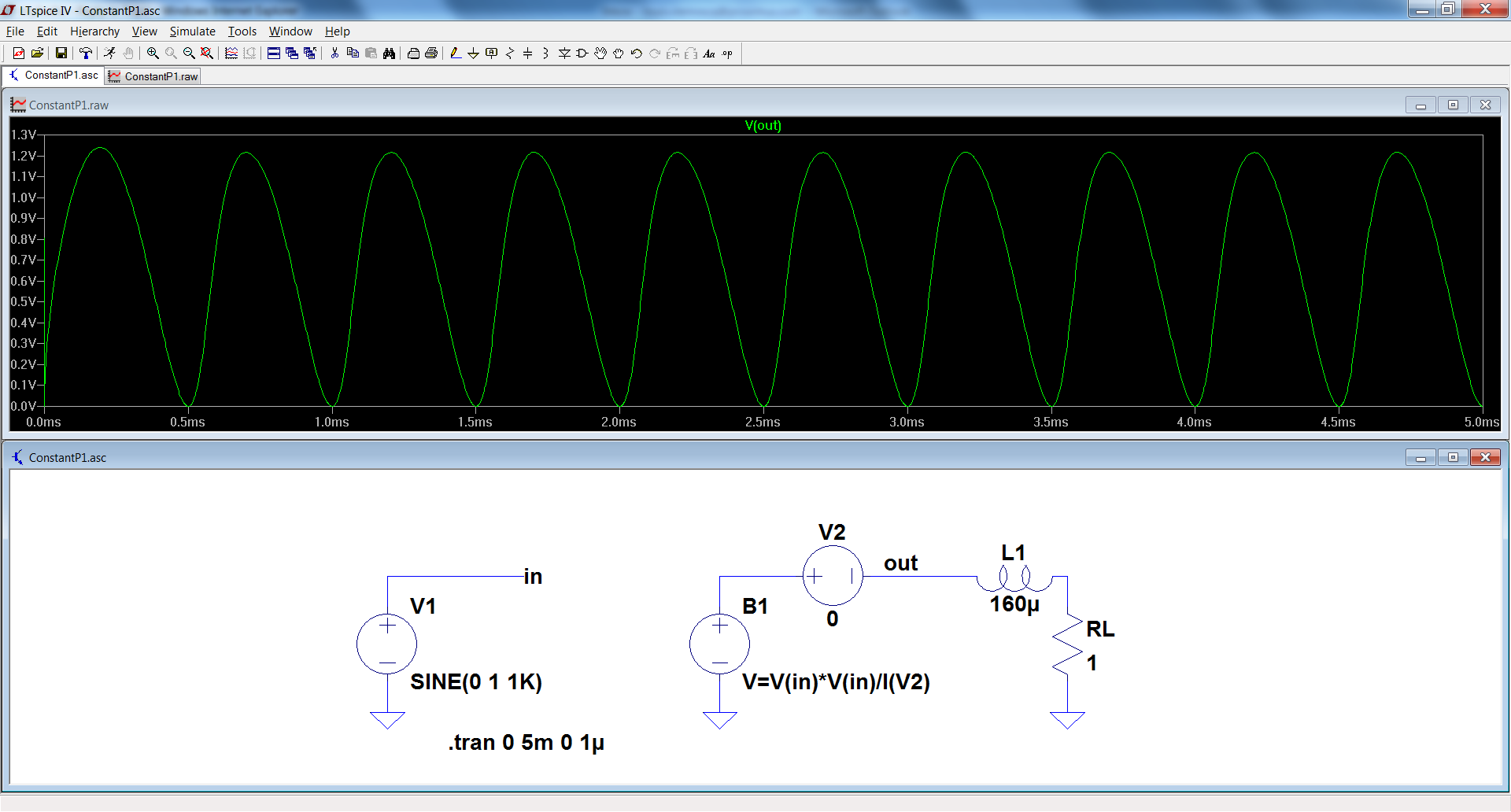

The situation has changed completely: the circuit now shows its non-linear nature: to keep the power constant, it needs to alter its output impedance, leading to severe distortion of the current into the load.
Well you ask the amp to deliver a constant power, and then you complain that the current is nonlinear. That's not logical.
If you want constant power, you must look at the distortion in the power. How does that look?

In my conceptual circuit, there is a strict proportionality between Vin² and Pout (which comes as no surprise since it has been designed for precisely that purpose). It is therefore perfectly linear.I know - I agree. But still, if you want to test an amp designed for constant power for linearity then you should look at the power, not at the current.
The problem is that the output impedance is non-linear, and if the load generates any kind of emf, through electromechanical transduction or reactive behavior it generates huge amounts of distortion, which somewhat defeats the usefulness (?) of the scheme

It doesn't matter: if you do the voltage dual implementation instead of the current one, the end result is exactly the same:I think if you are able to sense current and adjust voltage to get power, it might work. But looking this is better digitally done..
First pic is "your" voltage implementation conceptualized.
Everything looks nice and shiny: if we double the load resistance, the voltage rises by √2, as expected.
But as soon as we introduce a reactive element or back emf, things turn sour.
It is the concept itself that is intrinsically flawed, not its implementation
