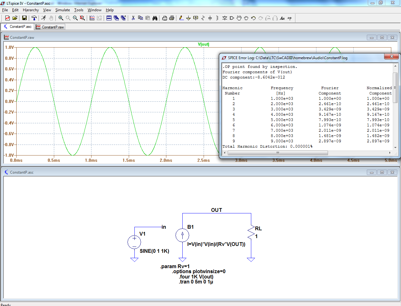

The first pic below is such a device in its spice-idealized, canonical form. It is easily visible by simple inspection of the equation that the circuit does indeed perform the task.
Rv (R virtual) is an internal constant required for scaling and dimensional consistency. Here, everything is unitary as the circuit is simply meant for theoretical analysis.
We see that apparently, in this perfect form, the circuit performs perfectly: the THD is LTspice's floor for these settings.
Everything perfect then?

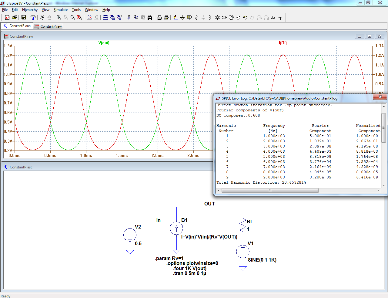

Not really. The sim shows the situation for a purely passive, resistive load. An amplifier is supposed to drive a speaker, which is far from this ideal: amongst other things, it generates back emf after it has been excited.
Let's see the behavior of the amplifier's output when it is subjected to a back emf.
The instantaneous input voltage/power is set at some level, 0.5/0.25 times the maximum for example, and the stimulus source is placed in series with the output load.
The situation has changed completely: the circuit now shows its non-linear nature: to keep the power constant, it needs to alter its output impedance, leading to severe distortion of the current into the load.
These results are general, and not linked to this particular implementation of the scheme (which is canonical anyway): this behavior is required to achieve the constant (instantaneous) power constant.
This means that such an amplifier will necessarily have an output impedance having the following attributes:
-Finite
-Variable
-Non-linear
That is a killer combination, even if the hardware does its job perfectly.

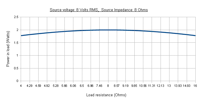

FWIW, you can get fairly constant power over a fairly wide range of load impedance just by using a linear amplifier with a modest damping factor.
Indeed. But I am not sure sacrificing the damping factor is worth the result.
