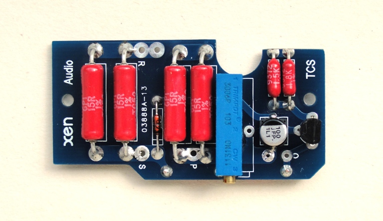

I made a small layout mistake with the TCS board, so we need new ones made.
I am waiting for that right now, but it wil take a few weeks at least.
So patience.

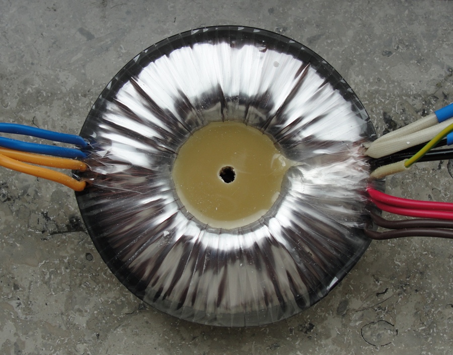

A custom made transformer from Toroidy for the DAO.
There are 4 secondaries (+/-Vs for 2 channels).
2 of them were wound between from o'clock, via 12 o'clock to 3 o'clock.
The other 2 from 3 o'clock, via 6 o'clock to 9 o'clock.
There is also a electrostatic shield between primary and secondary.
This is an attempt to minimise cross talk between two channels.
But the Tx was rather expensive.

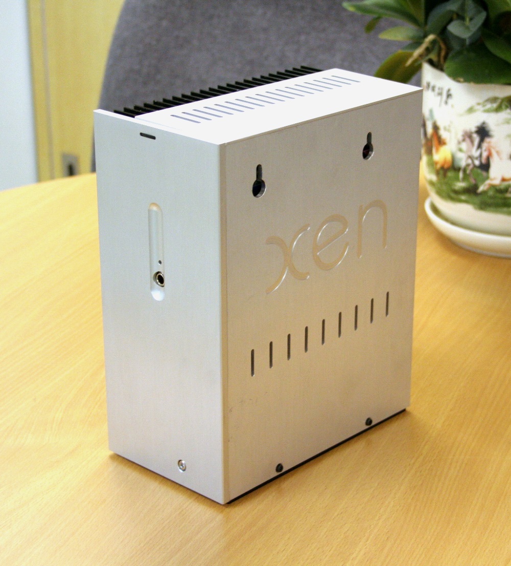

Some miracle happened yesterday.
Mark has finished his first prototype after 2 years +.
Clean square waves to 20kHz (limited by his func gen), with or without load.
The case is special version for his own use (wall hanging, volume control, etc.)
