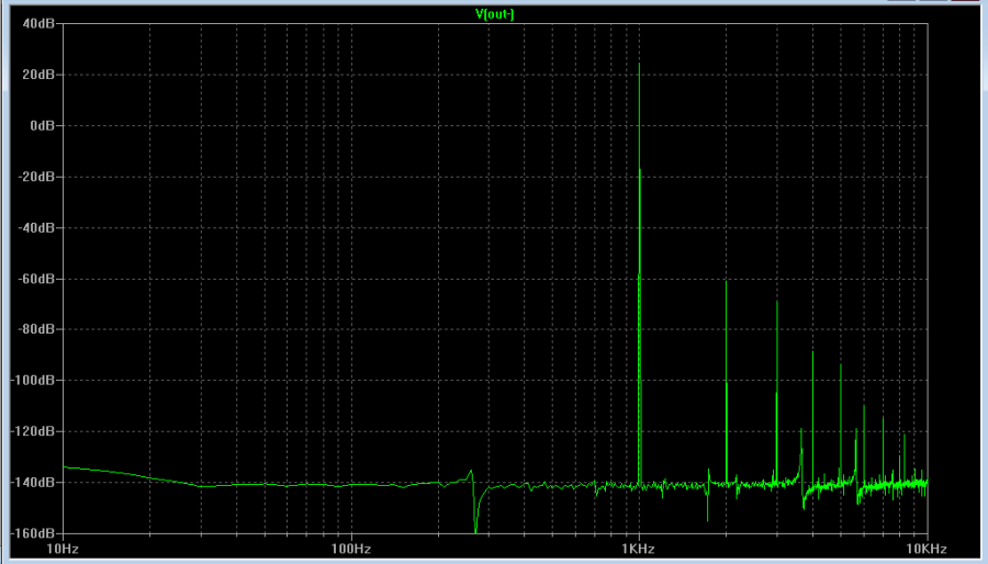

My estimates in post #40 is pretty accurate, at least according to LT Spice.
3 pairs of JFETs with total bias of 600mA. +/-35V rails.
Input signal +/-25V 1kHz sine.
Patrick

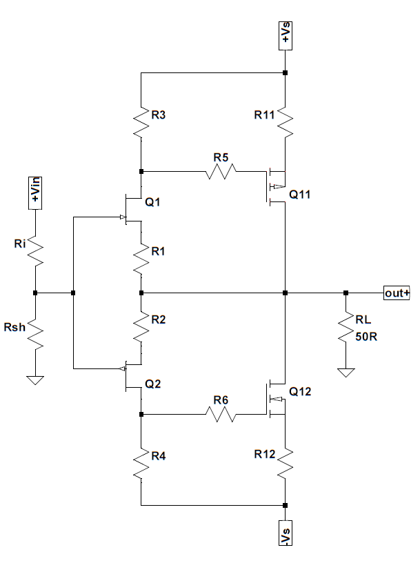

Actually it is done.
If I had to do this for myself, then I would not consider using the DAO for this particular application.
As already show in post 42, you can use 3x DAO in parallel to achieve very decent performance.
The price is high dissipation, as this is the brute force approach.
You can combine the gain stage and the buffer into one by using a F5X-Mini.
3 pairs of 2SK2013/2SJ313 as output devices.
But this is a global feedback amp.
Or you can use the attached circuit.
It is essentially a JFET / MOSFET CFP buffer, similar to the John Linsley Hood Buffer but with MOSFETs at the output.
1st stage is 2SK170/2SJ74 at about 8mA bias.
2nd stage can be 3 pairs of 2SK2013/2SJ313 with a total bias of 350mA.
Rail voltage is +/-25V.
THD at +/-20V 1kHz sine on 50 ohm load is below -80dB.
The local feedback of the CFP is responsible for the low distortion despite the low bias.
Easy enough to wire P2P.
Dissipation per channel about 18W, so you need a larger heat sink than the one shown in post#1 (That will only do about 20W).
But 18W is still about half of 3x DAO in parallel.
Only simulated, so build at own risk.
You can email me for more details, if you are serious about building.
Patrick

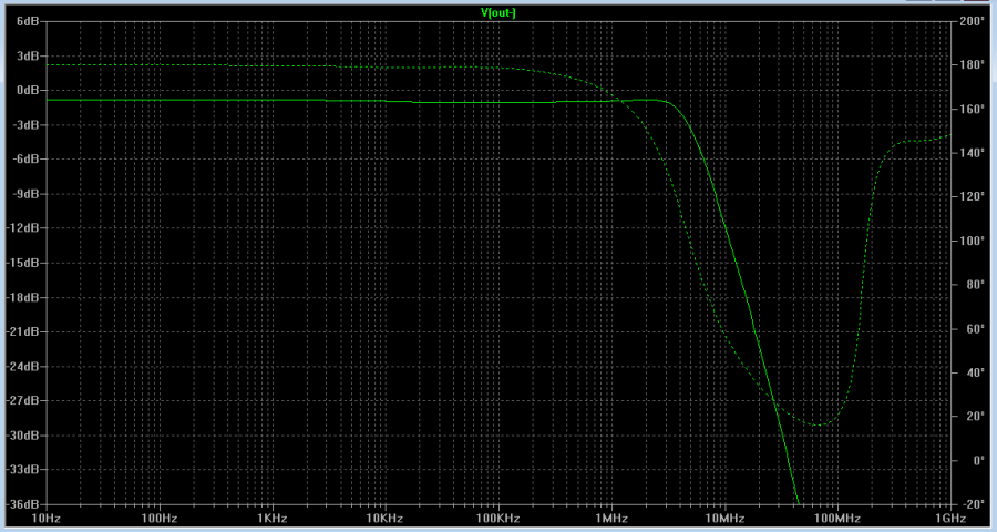

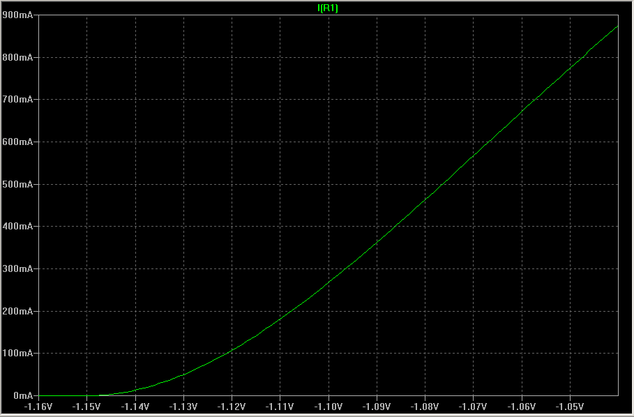

A version of the DAO as it is will do 11Vrms and 150mA.
It will be described in Part 2b of the article (after Xmas).
So I consider the AKG 600 covered.
The HE-6 I also now considered solved, at least in simulation, using 5 active devices per channel.
The driver device is still an LU1014, cascoded by a higher power MOSFET.
The trick is then to get the LU1014 to work in triode mode at a bias of ~500mA.
In simulation, at full +/-25V swing into 50 ohm load, 2nd harmonics is -85dB, 3rd -100dB, 4th -105dB.
Bandwidth -3dB is 2MHz.
That is respectable performance, even only in simulation.

I have been asked to show a simulated FFT plot of the HCLI (High Current Low Impedance) version as described in Part 2b.
Here it is, with 22V p-p output into 40 ohm.
I consider harmonics < -80dB at such output levels to be very respectable for a headamp.
Especially achieved just by a JFET source follower with ZGF.
Patrick
Patrick
Patrick
Hmmm
Can you post a plot with 4V output?

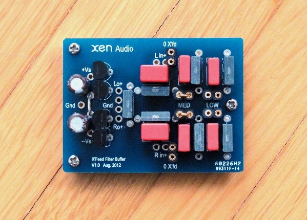

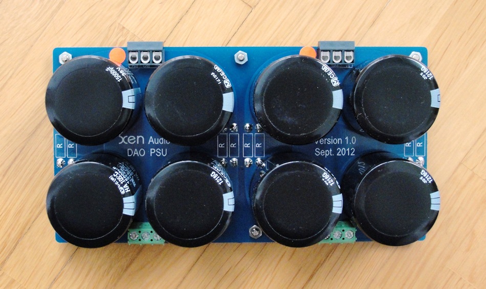

Part 3 of the article, plus a couple of finished PCBs.
In case you wonder why the amp PCB has not been shown, I have been waiting for PRP resistors from the US for 2 months !!!!
Patrick
Patrick
