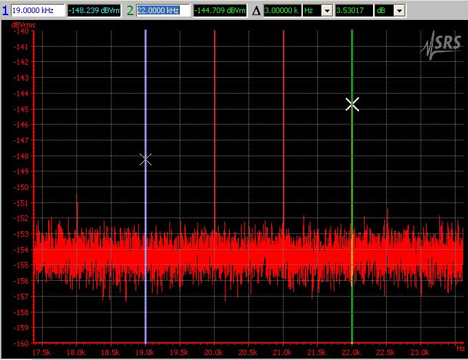

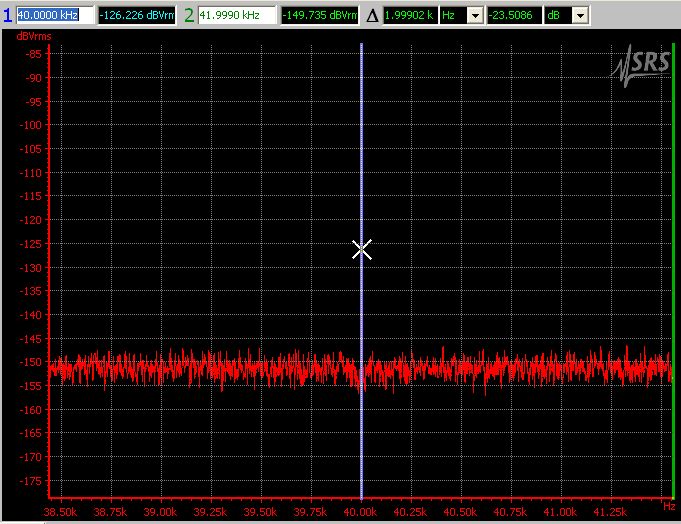

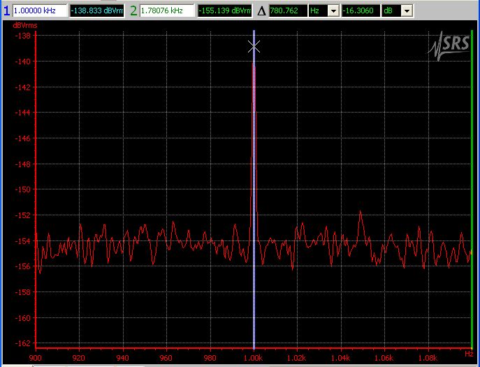

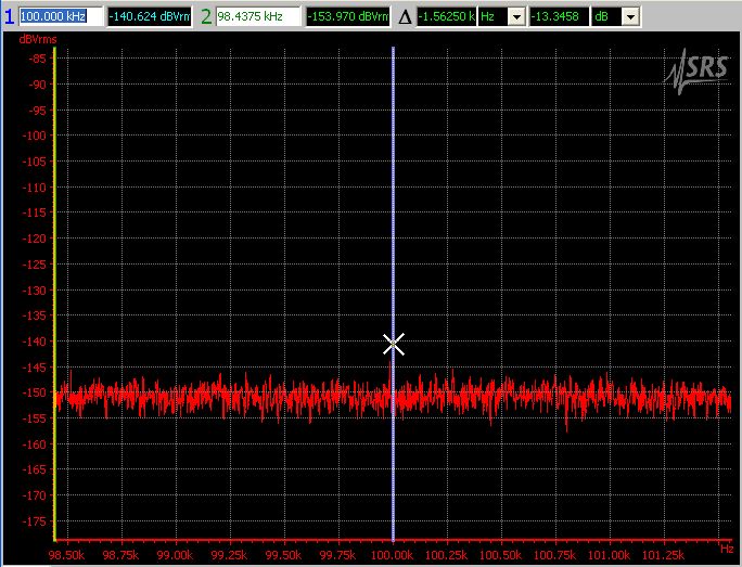

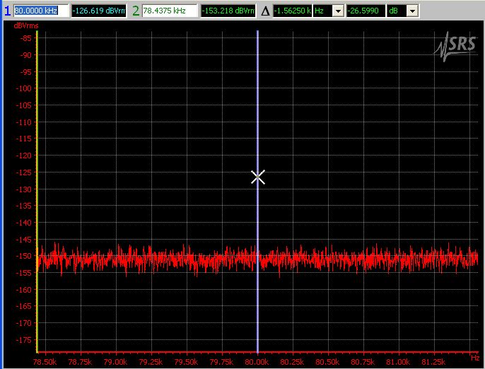

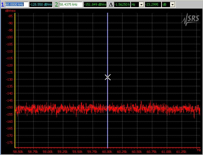

It is started a while ago, more like a joke. Attempt to show that with a pretty simplistic nested feedback loop concept and a bunch of NE5532 it is possible to achieve a 0.1ppm distortion level for 20kHz signal at 33Ohm load and couple of Vrms. I sort of achieved the goal, with an exception of a few "but". Of course one of those "but" was, as almost any early stage proto, it looked ugly as hell:
Long story short, I managed to squeezed it into a 50x50mm PCB (sorry, no imperial units allowed!) to get PCBs for cheap from the Seedstudio. So, here it is. It is green, it is still somewhat ugly, and someone called it "a crocodile", so I decided - Crocodile it is :)
Although I didn't stick with 5532 this time. Tried some different opamp, to see how it goes.
There are some measurement results on a 33Ohm load. In case of the 20kHz signal, the output amplitude is 4VRms (+12dBVrms), for the IMD test it is mixture of two 2Vrms (+6dBVrms) signals.
It is not hard to make something better using the same number of opamps, but the moto was "as straightforward as possible" :)

OK, I see now. Well congratulations on the measured results! Pretty impressive.:) It looks like you have a switcher on there for the power supply and none of that (switching frequency) seems to be making it into the audio.
