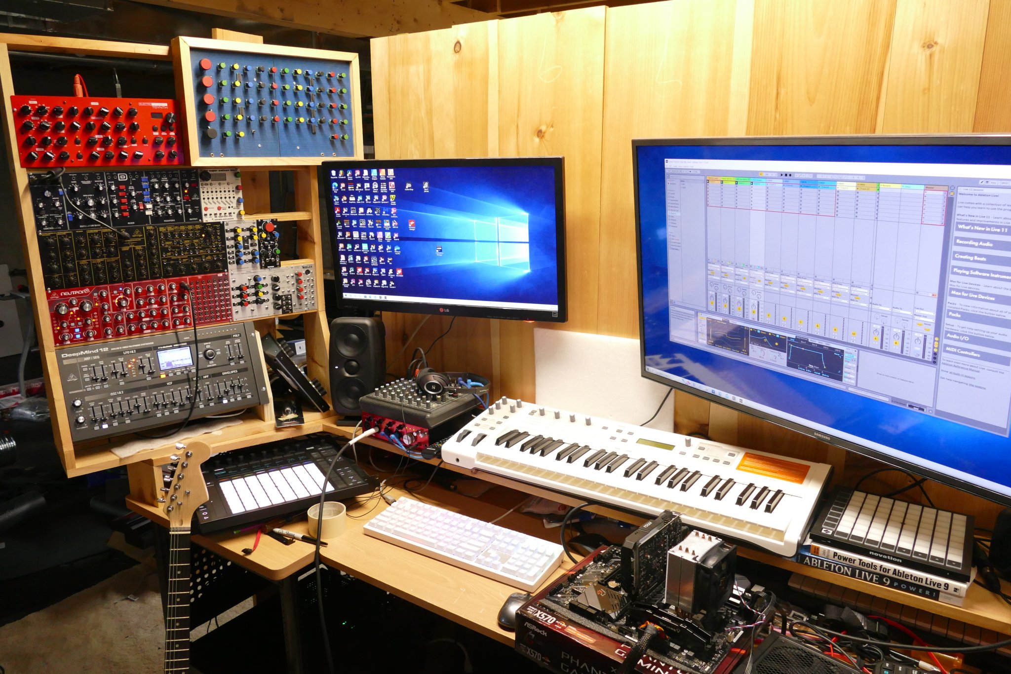

My "music PC" runs a Ryzen 9 5900X with a mild overclock 32 GB of RAM and a GTX 1660 video card and I can still run both CPU meters up into the 70% range. It is by far the most powerful PC I have. I am not a "power user" either, just a musical experimenter.
My "synth lab" experimenter box gets used mostly for compiling Teensy code that I write for some DIY music synthesizers I have built. It uses a 4th gen Intel core i7-4790K with a GTX650 video card and a mild overclock. I does well with the tasks I throw at it which involves writing and compiling Arduino compatible code, programming the synth, running a simple DAW (Mixcraft 10 or Anvil Studio) to send musical notes to that synth, while playing some other software or hardware synths.
I have another PC that is just a guitar amp. I plug the guitar cable into a Focusrite interface, connect a set of DIY speakers to the PC through a simple Parts Express chip amp, and run Overloud's THU amp and cabinet emulator. It does a nice job on the reverb heavy 60's surf music that I learned on.

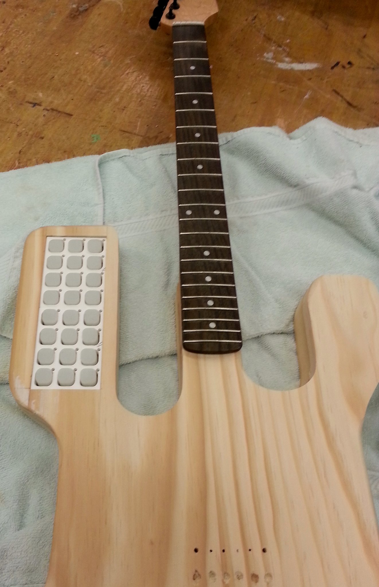

The big blue synth is a "virtual analog" synth of my own design. It uses a Teensy module for the brain and the Teensy drag and drop audio library for most of the code generation. "Blue" and its smaller companion ("Micro", not seen in this picture) are polyphonic synths with the usual set of controls found on an analog synthesizer.
The Teensy modules are small 24 bit CPU modules that run up to 600 MHz in clock speed and are supported by an "audio library" that does the heavy lifting for music making applications.
