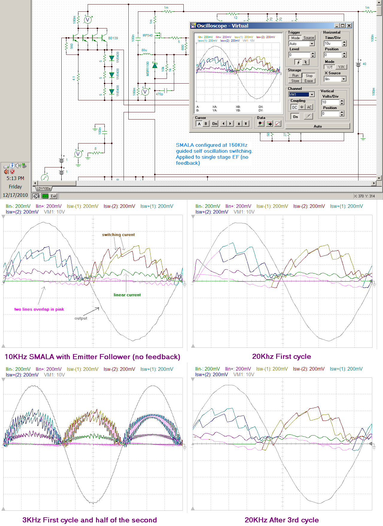

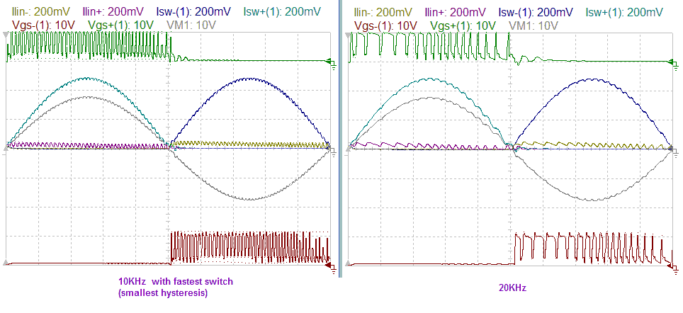

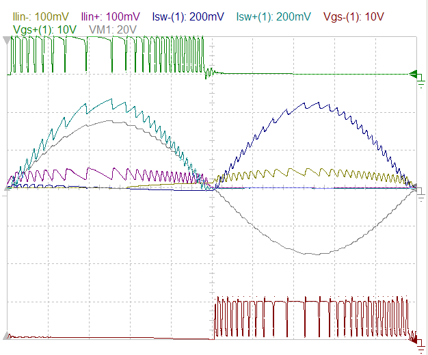

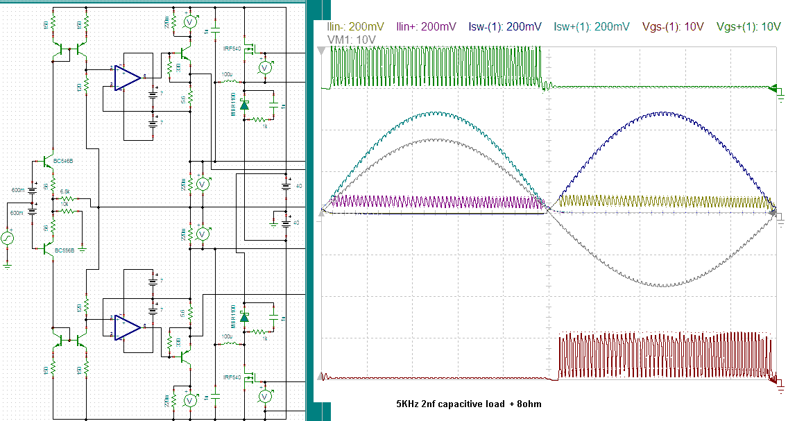

This is fastest switch I could reach,
Note: Isw is total current, not inductor current, as in schematic previous post.

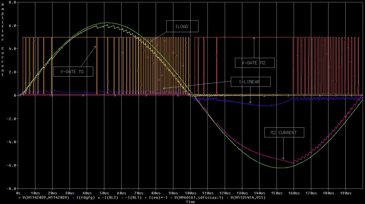

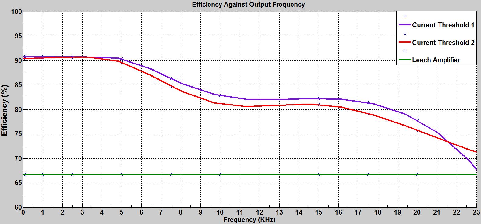

Those sims are looking good.
Efficiency can be calculated from:
SUM(ABS(AVG(losses ))) / SUM(ABS(AVG(loss + power output)))
I used Pspice not Tina, so i dont know how easy it is on that.

Not a lot of interest now it seems, maybe this thread would have attracted more attention in the Class-D forum?
It's a 50-50 mix of linear and Class-D so it was a tough one as to where to post!

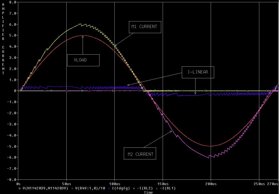

Ontoaba, did that method of efficiency calculation work for you? what kind of efficiencies are you getting with your system? You'll need to run the simulation over a few cycles to get a steady average efficiency, if Tina is slow maybe LTSPICE is faster??
You will be able to lower the THD many times using NFB, the output impedance of the linear amplifier is important here, but at the same time so is the bandwidth!
A large concern for maintaining efficiency is the nominal impedance of the load, low impedances will cause efficiency to drop off at lower signal bandwidths (reduced power bandwidth).
In my report I investigated envelope tracking aswell (including the Carver magnetic field amplifier!), this might also be of interest, although I dont think it is as good a scheme as the parallel connection.

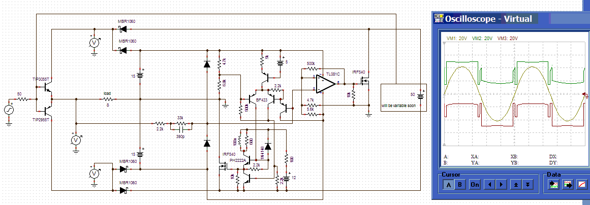

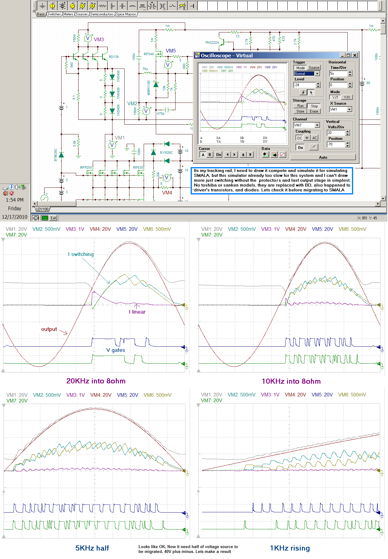

Hi, Thanks your link is work.
I have problem with how to use tina-ti multimeter it always show zero AC voltage, may be I should make some sensor with low pass filters, and waiting its steady state(one cycle is very long for this circuits). I am not going to do that, your thesis is already show some efficiencies results that help in prediction.
Series connection has more lost power in its ripple which dissipated at linear stages. Carver using three tiers, may be he has some problem with fast rising current demand or something. Combining them like EEEngine (yamaha) and classBD (labgruppen) also help, but not much, I am using interleaved switches that help each other both in current rising and ripple reduction, but it become more complex. Mackie subwoofer using single tracking rail for both +/- supply that may help me in this.
🙂There is no perfect things in this temporary world, but we may try some improvement. Series connection has less efficiency and this parallel connection has higher ripple to be reduced, need twice voltage rating for devices and need better error correction. ClassD also has very low efficiency in low power operation, when heated inductors and its switcing losses dominated.
Low efficiency at low impedance load also caused by inductor limited dI/dt, lower the inductor value or use higher chargeing voltage will solve it. Or simply use interleaved as in my early post with two switches, it handle up to 2 ohm for 8ohm design.

The problem with low impedance loads is a tricky one to get rid of, if you raise the supply voltage of the class D stage then you also raise its dissipation, and increase the switching frequency. Lowering the inductor will also cause the oscillation frequency to rise. Efficient Power bandwidth is reduced at lower Z loads.
I guess the frequency of oscillation needs to be capped / better controlled to stop it rising too much in this scheme.
