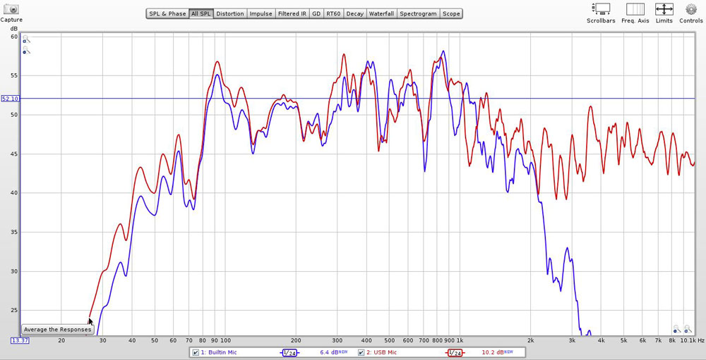

Today I thought I'd compare my Umik USB microphone with the builtin mic on the CLAC card to see if it could be at least a sometime substitute.
I've included a very very rough comparison of mic'ing a two-way where I tried to place the CLAC mic at the same spot as the usb mic. It's good up to the higher registers where the CLAC starts dropping pretty rapidly. Not bad.

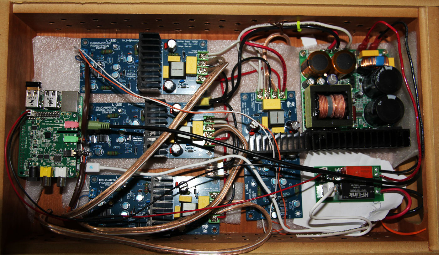

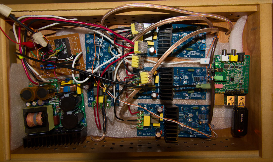

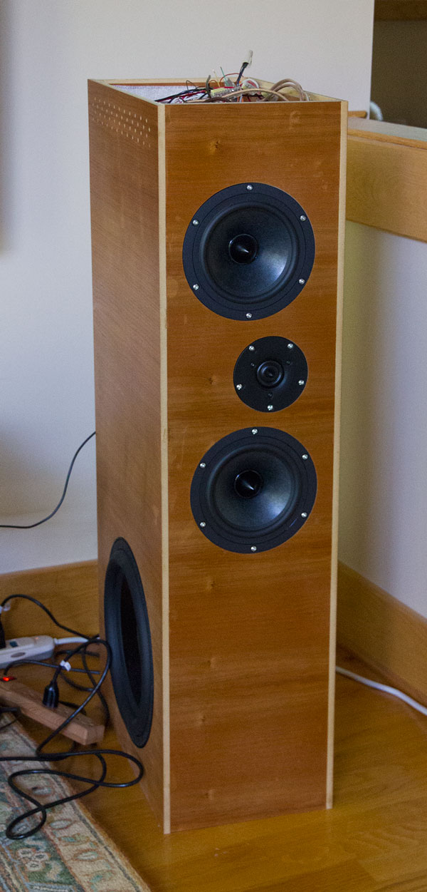

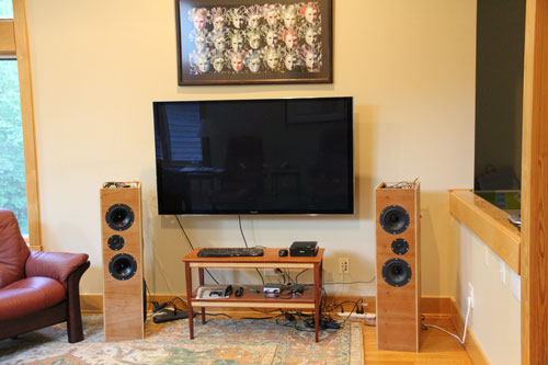

I thought folks might like to see this in action. My test setup is two 4-ways (around my tv) driven by a little Intel NUC. The NUC generates analog output that goes into the Cirrus Card line-in, gets processed by the Rpi2, and spit back out to the Cirrus Card where it becomes 4 channels of audio (sent via line-out and headphone-out) - to 4 mono amplifiers. Oh, and there's a breadboard with a relay and a always-on 5v supply while I wait for my boards to get sent.
The wired input to the speaker is power (at the bottom via a switched IEC) and whatever analog input I want (you can see the cord coming from the NUC). And, yes I know all of the electronics is on plastic wrap... i'm getting there.
See below:
See below:
Yes, one pi2b+clac per speaker. I've just got a 3.5 y on the front of the NUC and the a male-male 3.5 mini to the line-in. You can see the cable coming in the back on the amplifier photo. And I'm very proud of my wiring
By the way, it's hard to tell this but the rpi is raised about 1/2 inch by an extra plastic which reduces the tweeter amp noise caused by rf pickup to nil from annoying.
