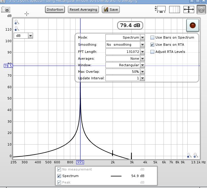

Distortion Sweep: I did a real distortion sweep (still with no chassis, line-in to headset-out) using the 5V wart supply and measured pretty good numbers:
at 192K sample rate
.13% at 20Hz
.045% at 40Hz
.04% at 60Hz
.04% to 5KHz
.055% at 20KHz
at 48K sample rate I got a reduction at higher frequencies instead of an increase (probably clipping off the higher order harmonics).

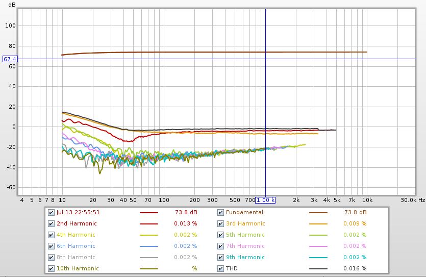

Today I ran a sweep via playback and measured distortions
20Hz - .013%
40Hz - .008%
5KHz - .008%
rising gradually to about .016% at 20KHz
I'm pretty sure it's better than my measurement system and probably hitting the .0035%@1KHz spec they provide.
Just for grins I tried playing through the headset and simultaneously recording then I measured playing the recording back - so out head, in line, out head and got almost uniform .032% (better than my tests using the 8039 oscillator and better than the board spec).
Summary is that unusually enough the board spec seems spot on, or at least within engineering tolerance, and it's awesome for the price.

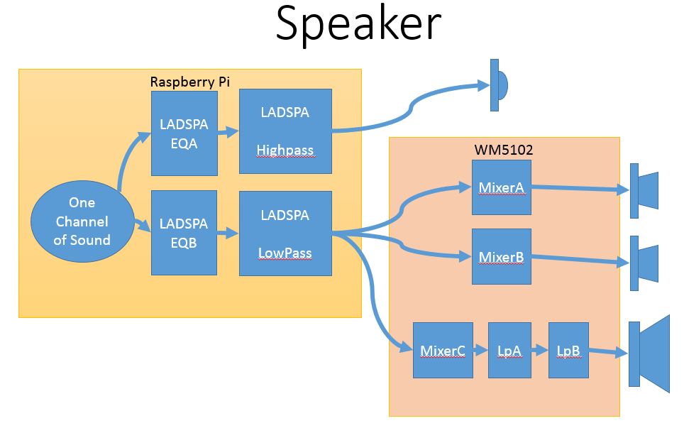

Today I got my three-way/four-driver crossover working just using the Cirrus Audio Card and my Raspberry Pi. I've included a picture showing how it works. I use LADSPA as a two-way crossover (which is a Pi hardware limitation). I then take the low end and run it through 3 routes in the WM5102 to generate the two woofers and the subwoofer filters. Works like a champ but I'm cheating and using the woofer box as the lowpass filter for that driver - which works just fine : )
I got Alsa working nicely with my CLAC to do the first part of the lowpass (see http://www.diyaudio.com/forums/pc-based/274331-ladspa-plugin-programming-linux-audio-crossovers.html) and it was trivial to program the WM5102 using alsamixer.
The WM5102 settings - this is primitive and will probably improve over time... are attached.

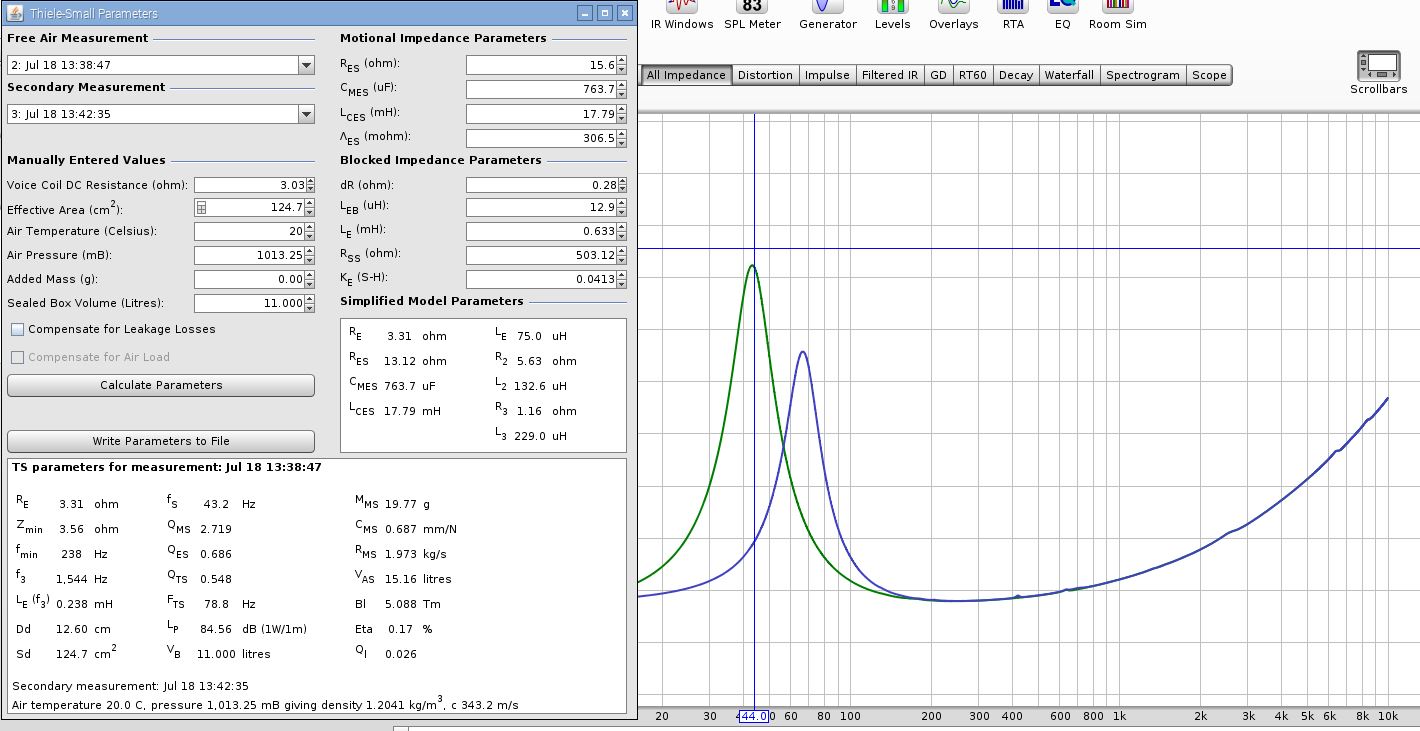

First, I tested the speaker output on the card. You enable this by providing a reasonable +5V/2A to the card (which then powers the Pi). I tried for quite a while to get it to work and it kept sucking down 1.8A (heating up the card noticeably) while doing not much. Apparently my scope ground was short-circuiting it and the card seemed to just shrug this off. Pretty good.
After not shorting it out I tried using it with a real speaker and it wasn't bad at all. I drove a 7" woofer to low-but-ok volume with the speaker and the current never went over .3A and the board stayed cold. You could easily drive an efficient 2-way just with the Pi and CLAC.
Anyway, then I tested the impedance of my woofer using the CLAC with Room Equalizer Wizard on the Pi and it worked like a champ (other than REW's annoying inability to measure twice). So, with an Amp it's a standalone speaker tester :) I used a budget IRS2092 board and a really noisy power supply and it didn't phase the linein at all.
I've included a view of the REW screen after openair/sealed tests.

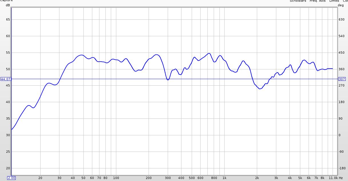

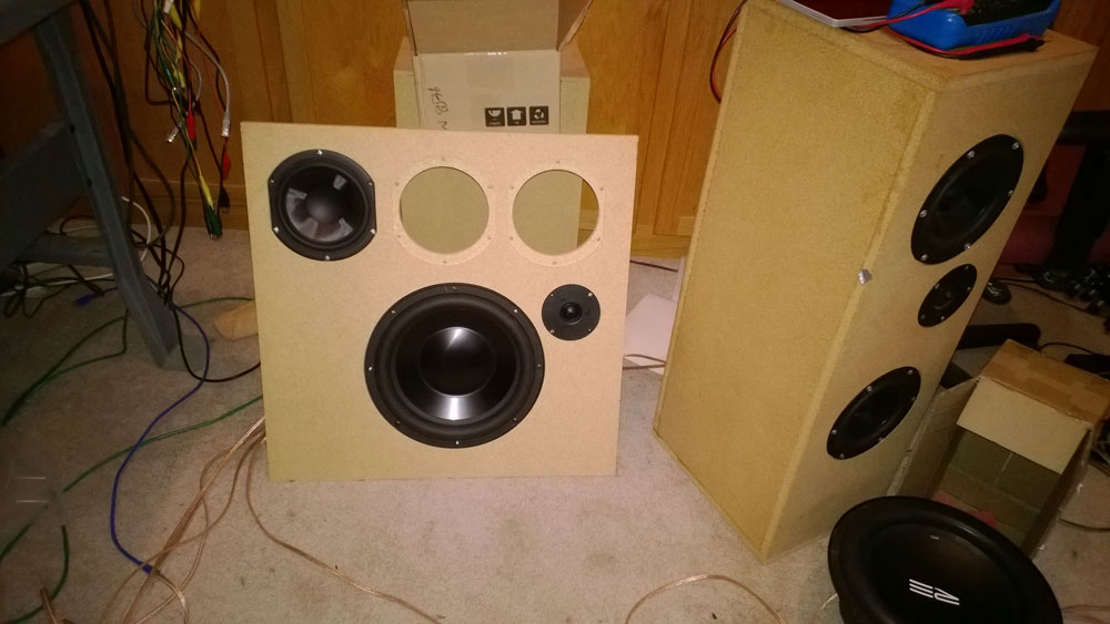

The strangest thing happened today. After reading some of the discussions about dipoles it seemed reasonable to try one with the CLAC. Oddly I had built exactly that kind of faceplate when I was testing out my CAD drawings for the drivers. So I refilled the faceplate (taking drivers out of their sealed-box homes where I was testing them) and ran it through the drill.
I hooked up a 4x100 7498 amp and my CLAC/Pi then built a circuit to drive my faceplate to flat response (at my position). The response curve shown is measured 1/6 octave smoothed.
I ended up with an .asoundrc file with 5 filters. The crossover and then a few eq filters to try to smooth stuff out based on doing acoustic testing with my mic and REW on the Pi.
Then, I played some music.
Wow. This is the ugliest dumbest speaker I've ever built and it's glorious. Yes, it has some warts at the moment but it hits such high points. I love technology.

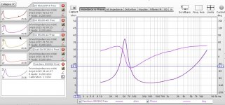

I tried using the Cirrus Logic card as a measurement tool again today. I wanted to see what range I could get, so I used it to find all sorts of driver impedances and it worked flawlessly. The headphone out impedance is very low - it easily measured a 2 ohm driver. Here's an impedance plot showing all the drivers.
This is really awesome. A little 5vusb-powered automatic loudspeaker tester, impedance tester, that itself runs REW and can run at 24/96 (or 16/48 if you prefer). It even has a mic bias on the mic input, although i'm using a usb microphone. I can run it/control it from my tablet using Vnc and I just plug it into a network.
