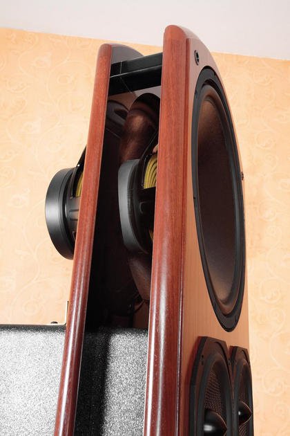

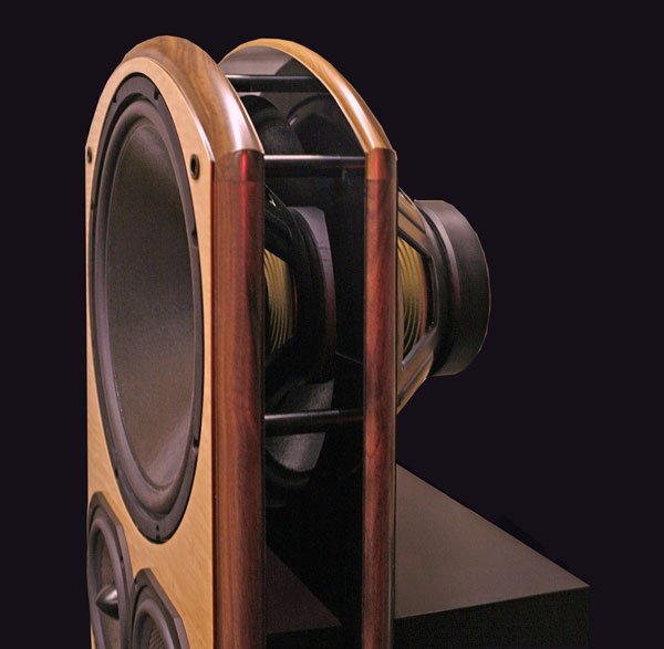

No magic lost even if the space is bigger. Please see commercial, and great sounding speakers like Legacy Audio Whisper.

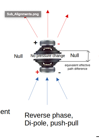

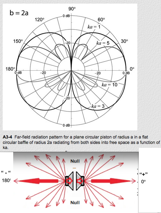

Semantic issue? This set-up is almost the same as a single speaker but it has an offset between the woofers. The effective null is 90 degrees to the side caused by the wave from the back of the bottom woofer interfering with the wave from the back of the top woofer, the gap has a neutral pressure and no sound is emitted. From a system view there is no sound to nullify. Is the front chamber of an isobaric woofer a null? The pressure is constant, the pressure change measures zero and is null. This system with woofers facing each other and placed very close is almost an isobaric system.
The sound emitted from the woofers is nullified to the sides in the listening room, the sound in the middle is null because there is no pressure change to begin with. Also, it doesn't affect the sound from the back and front of the system. There are two phenomena causing nulls. So to be more clear on the drawing I said there was no pressure change in the space between the woofers. Null is defined as an empty value so the area between the woofers is a null because there is no pressure change, the value is 0. The null's to the side aren't really nulls because they change depending on frequencies and room effects. So cancellation, or better destructive interference is what happens at 90 degrees to the side of the system.
So, did I get it right this time? If so I'll draw it over. Words mean things, we should be accurate in what we say to limit confusion.
Are there any colorful simulations to show how the clam shell configuration is more directive than a regular di-pole?
No, because it is no more directive than a "regular dipole", as long as the separation distance between is small compared to the wavelength of radiation.
Note the polarity on the left is 180 degrees different due to the reversed polarity of the opposite sides of the dipole.
In two dimensions, the dipole polar pattern looks like a figure of 8, in three dimensions, a torus (donut) shape.

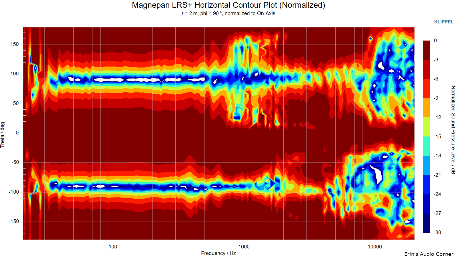

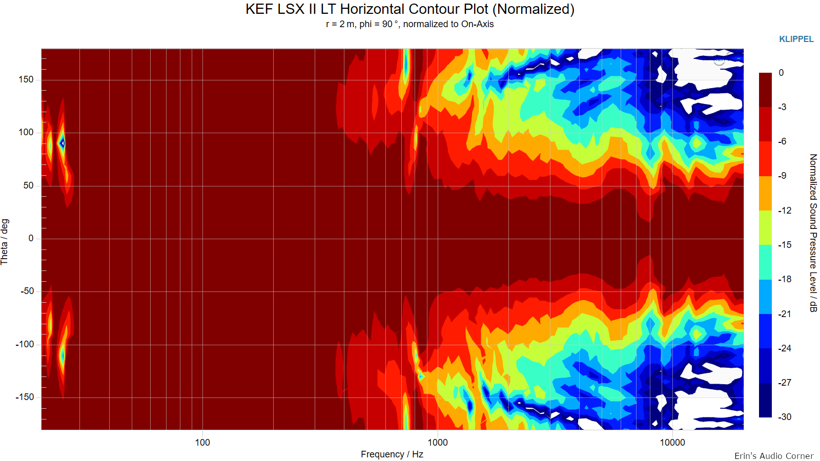

Practical examples, from Klippel NFS scans done by Erin
A small coaxial with BR port on backside
- omnipole to 400Hz, monopole above it (exception is port resonance at 900hz)
Dipole planar 2-way
- dipole pattern constant up t0 900Hz, then scattering of interferences
- negative polarity of backside radiation is not visible here!

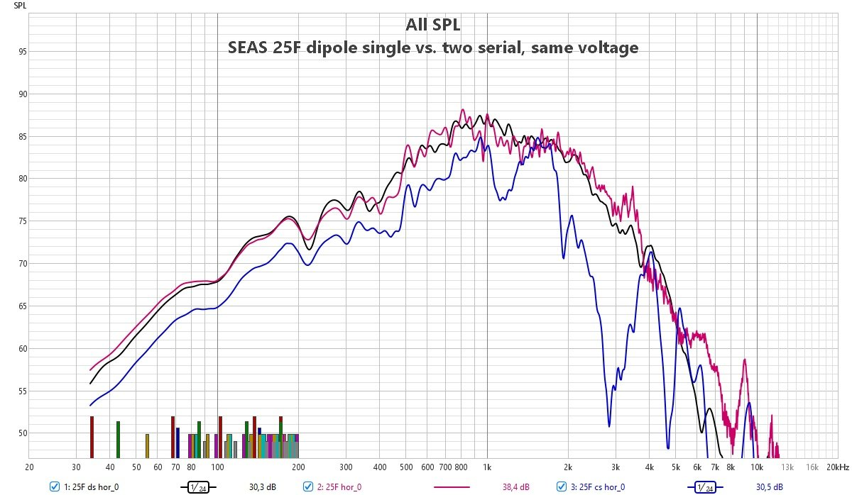

Connecting two drivers electrically parallel to same amp will reduce inductance which leads to higher spl with same volume pot setting (voltage), compared to a single driver.
Acoustical efficiency of two drivers side by side is better than clamshell. Notice how bad is spl response of clamshell above 1kHz, because of "motor" obstructing sound and causing interferences. CS is clamshell, DS is side-by side. I used serial electric wiring!

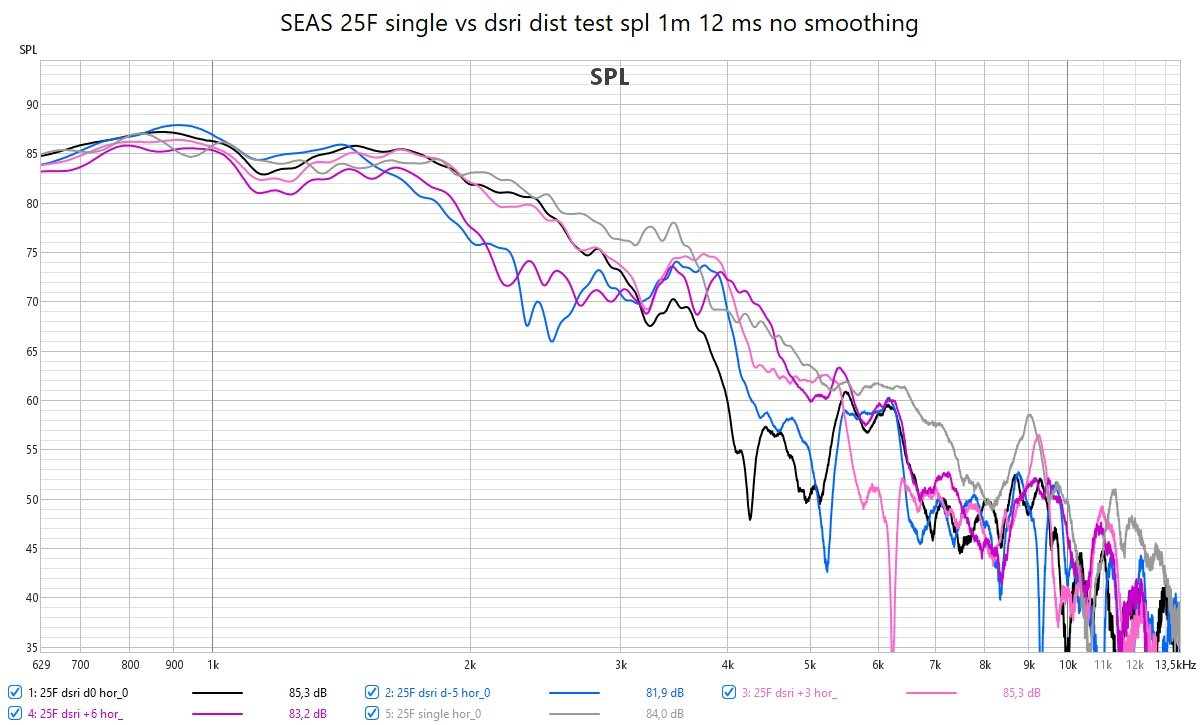

Increasing distance of clamshell drivers makes more interferences in high freq, directivity is similar below that (constant dipole pattern)
Link to my tests https://www.diyaudio.com/community/threads/various-nude-dipole-arrangements-measured.418853/

My conclusion from the tests above were
1. clamshell is waste of resources and worst possible acoustic behaviour
2. clamshell has the motor making obstructions for high freq
3. two side by side has less distortion than single. Also more spl if connected parellel electrically.
4. two side by side other reversed has even less distortion
