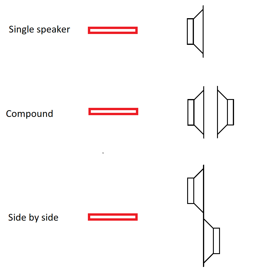

OK I have just had a thought Erik - if you are measuring that close did you account for the change in distance from the radiating surfaces?
In other words - as soon as you remove one subwoofer - depending on which one you remove the measurement distance will change.
That could well explain it indeed. The measurement setup I used is shown in the picture. For the compound dipole I just added the 2nd woofer facing the first, so its "acoustic center" is quite more away from the mic.
I am quite happy with this outcome, as it allows for more compact building and hanging the compound woofer is much easier than single units! I do not have a direct use for it now, but knowing it can be done may inspire some future action.

It's folly to measure a dipole bass system so close. I do my dipole measurements at two or three meters indoors or five meters outdoors. Mic always on the ground to eliminate floor bounce. LP measurements are always good to add to the mix too.
It does appear there may be an increase in sensitivity. I wonder if this translates into a 6dB increase in maximum output, or if max o/p is essentally the same as a single driver.
Outdoor measurements are best of course, but not always possible. Distance to mic can be surprisingly short with no-baffle woofers, I have tested that too naturally. Room modes and first reflections cant be avoided indoors with long gating, but they are consistent in measurement results (off-axis by rotating source and trying different eq and xo slopes), so they can be easily eliminated from analysis.

My reasoning goes, if two radiating membranes are close to each other and vibrating in same phase, the pressure variation between them is zero (when wavelength is longer than gap) . The summed radiated power will be same as a single radiating cone, and effective volume displacement and cone area are the same. Only benefit will be better motor control of cone movement and perhaps less distortion. Max spl will be the same because Xmax is the limiting factor. Bi-amping, parallel vs serial electric connection will make a difference in spl per voltage (sensitivity of the system).

"My reasoning goes, if two radiating membranes are close to each other and vibrating in same phase, the pressure variation between them is zero (when wavelength is longer than gap) . The summed radiated power will be same as a single radiating cone."
I do get this viewpoint and understand the reasoning behind this, but this is not correct - as confirmed by multiple measurements and SL's modelling.
I think if the space between the drivers were enclosed (i.e. the two subwoofer faces connected by a sealed tube) it would behave more as you suggest.
