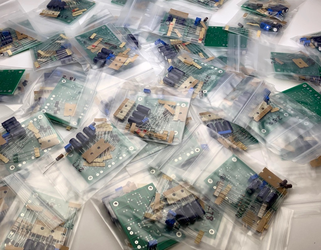

The Christmas 2019 H2 giveaway! (and BAF fundraiser)
Finally got my H2 wrapped up and playing music. Super impressed!!
