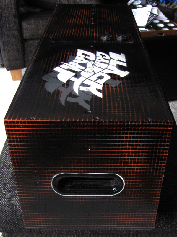

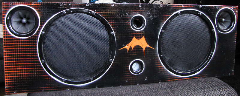

Pics:
I was not involved in selecting colors, logo or patterns, and I did not ask him to paint me inside the lid : ), He made that as a surprise.
Thomas (a friend and camp member) had full creative control and this is what he ended up painting.
It's sort of a "cartoonish" steam punk look to it I think. Unfortunately there is a lot of dust and crap in the clear coating which does not look very good. But after all it is a Roskilde boombox, it will be scratched and get dirty sooner or later.

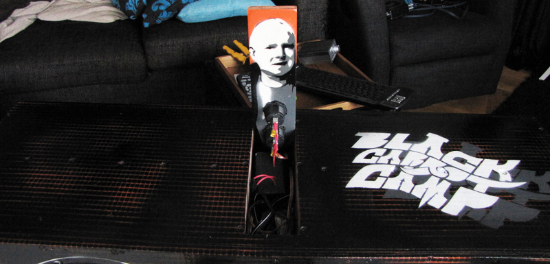

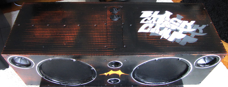

Hello again, I finally got the boominator back after the paintjob.
So yesterday we had the first field test at a party.

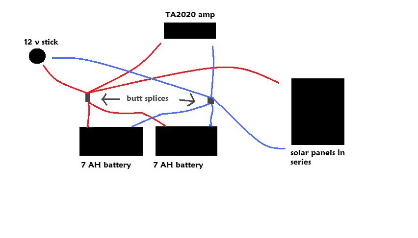

So... I'm gonna ask, like many others, about the wirering 🙂

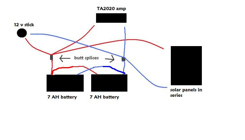

I have bought a 6W solar panel Rated 0.4A @ 14.5V.
Can i connect this directly to my battery, without a charge regulator?
I will be using 2 Yoasa 7,2Ah batterys, don't know if i should parralel them?
Yes.
You should parallel the two batteries to form a 14,4 Ah 12v battery (acting as one big battery)

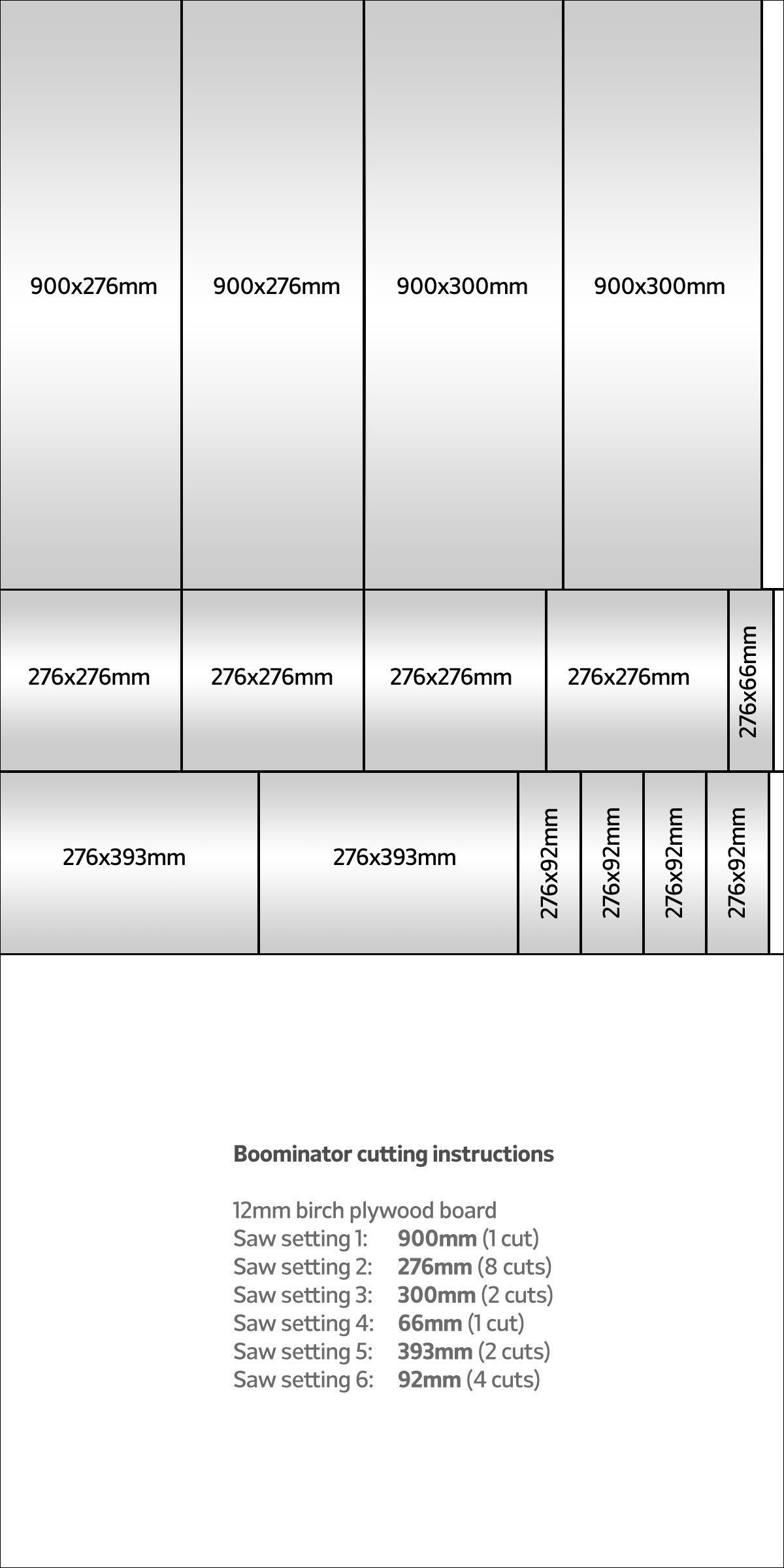

Cutting instructions by an user
http://www.diyaudio.com/forums/atta...b-ultimate-party-machine-boominator_cuts2.png
