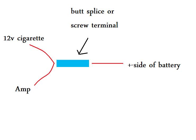

Since Roskilde is nearing and i am at the last stages of my boominator build, i would love to just make sure that i am gonne do the wireing of the whole thing correct, so if someone qualified could just tell me if i am doing it right by doing it this way, i would be very happy!
ImageShack® - Online Photo and Video Hosting

Yup. Looks right. Just note that on the amp6 the negatives are the 2 middle connectors, and plus is the outer connectors.
Thank you very much!
And about the Amp-6, that is duely noted, just didn't have it laying around til check it out, what i really needed was to know if my parallelling of the cables was right.
Aagaard
