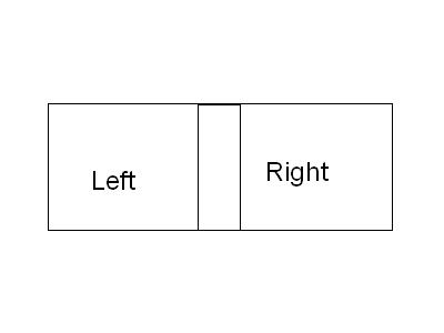

So i'm guessing it's something like this:
(i know, some people are amazed by my paint-skills
Well, thanks for really cutting it out for me.

Now I am being triple careful with the wiring. When wiring up the parallels - should I parallel the two speakers in the same "box" or so the same side is parallel'ed? Or even cross it so I get proper left/right orientation?
You want the stereo effect when standing in front of the boominator. Therefore each channel should play in each speaker compartment/cabinet. And you should be able to wire it like this... At least that's what I did. Should this wiring not be proper, I apologize beforehand.
EDIT: The small speakers on the drawing are the piezos and the big ones the HP-10W
Congratulations on the good news btw 🙂
Just to cut it out in effing cardboard for me - we agree on this form of connection right? Speakers with blue wire are paralleled, speakers with red wire are paralleled.
one left one right for each side, asked the same thing some posts ago 😉
Then you read the answer wrong.
One end is left. The other end is right.
That would make more sense - the same signal would be sent to each pair of glued speaker, and they would play precisely the same thing, right?
It would take a long time to explain but having 2 different channels in the same cabinet especially when the drivers are put directly opposite eachother would be problematic for a long list of reasons.
Note that some people do exactly that when they build a Halfinator. But I have never condoned building it, I have just been saying it's the better option over splitting it down the middle.
There would probably also be some problems regarding a signal only going through 1 channel and then having a 24 L cabinet to fill that with instead of 1 shared signal in the same cabinet.
