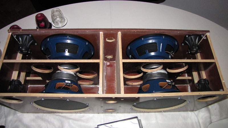

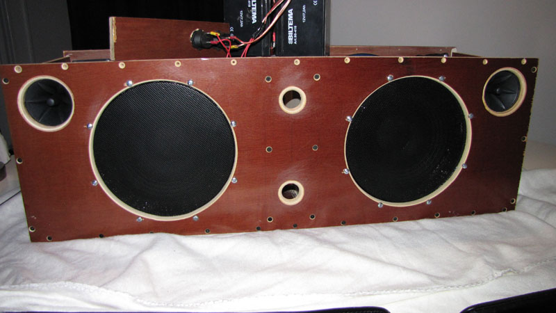

Are you sure silicone is gonna hold it in place?
Before I close the box I test it with everything connected and put the top piece in place without any glue or anything just to listen to it shortly. I've experienced that the top piece rattles.
Of course if you put screws in it also it will not rattle as much or hardly not at all. But like the idea of the box being absolutely shut apart from the port.
Not that it's me to answer, but I'm quite sure that no dampening material is used in the boominator.
Basically what Rubenn said. Except I must stress not to use silicone with acetic acid (the stuff that smells like vinegar) or you will need to open it up later and replace everything inside.
You must not use dampening material of any kind. This is pretty important actually. It will be a long theoretical discussion why it would be a very bad idea though so I'll leave that for another day, if ever.
Could you go into detail about what exactly is the problem with specific types of silicone?
Do you mean that the fumes could ruin the woofers even though the box is vented?
Not could. Over time, I'm 100% sure acetic acid fumes will ruin your drivers, as well as all exposed cables inside.
There's a reason why acetic acid silicone is completely forbidden to be used in or near electronic circuits.

Bostik Universal Silicone:
http://www.bostik.se/BostikTDS/SE/P0457_SE_TDS.pdf
Hardener: Alkoxy
Safe or not?
Ger ej korrosionsskador.

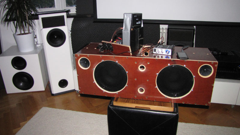

Good, I already sealed the box with it and was really scared there for a few minutes : )
The boominator is playing, nothing is rattling in the box and its about 10 times better sounding and louder than the old boombox so Im happy.
Thanks for all the support along the way Saturnus, I owe you atleast a few bears, see you at the festival : )

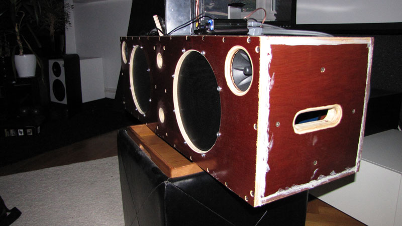

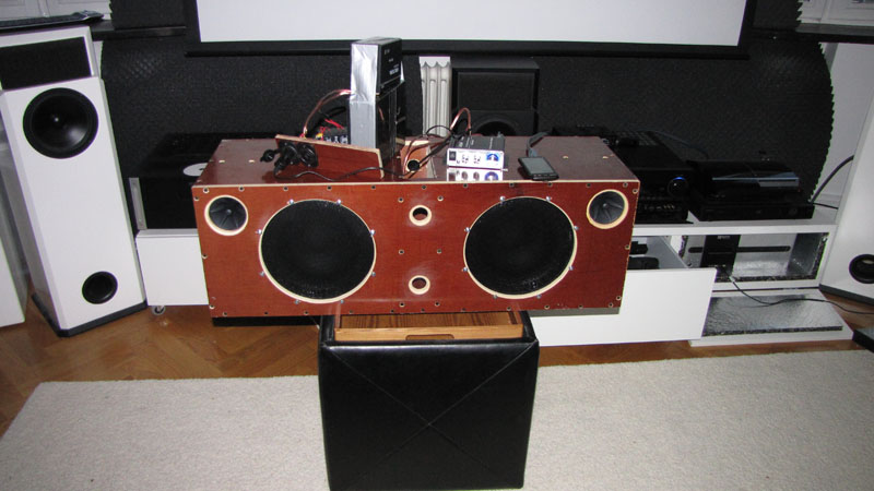

Here are some pics.
I need to sandpaper all surfaces, the glue, uneven edges and the silicone and then paint it. But not long now : )
Here are some pics.

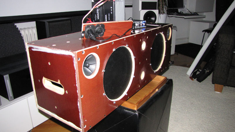

Here are some pics.
Cool.. Looks like you are making progress Looks good..

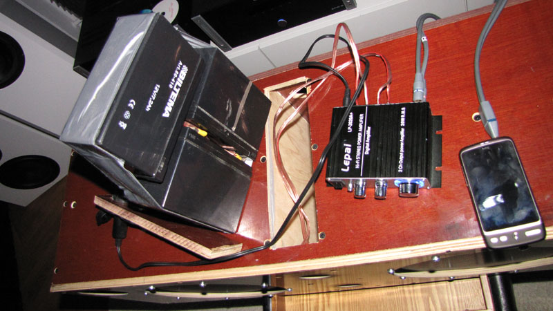

I was wondering.. Will it hurt my batteries to let my boominator charge without music playing? I've noticed that the voltage easily climbs to 15-15,5+..
If you don't remember, i'm using 2 x 8Ah sla's and 2 8v 5.2w panels in series..
I seem to recall you mentioning something about its just trickle charging the batteries.. But I do think the voltage is a bit high.. Need I not worry?
You could have a 4 times larger panel and still not worry. As long as the effective charge to capacity is 1:10+, there's absolutely no reason to worry. Yours is 5: (2*8*12) ~ 1:40.

Can't wait to see the final result. Btw, did my calculation end up being correct in that you could glue the magnets directly on the 12mm centerbrace and it fits in width? If so that's great news for making it even simpler for people to build.
No unfortunately not exactly, I needed to fill the gap with a piece of masonite or similar and fill up with glue. But its pretty close.
I wont be doing the actual painting myself, we have a artist (painter) in the camp and I gave him complete artistic freedom over the paintjob. So Im just as excited to see the final result : )
