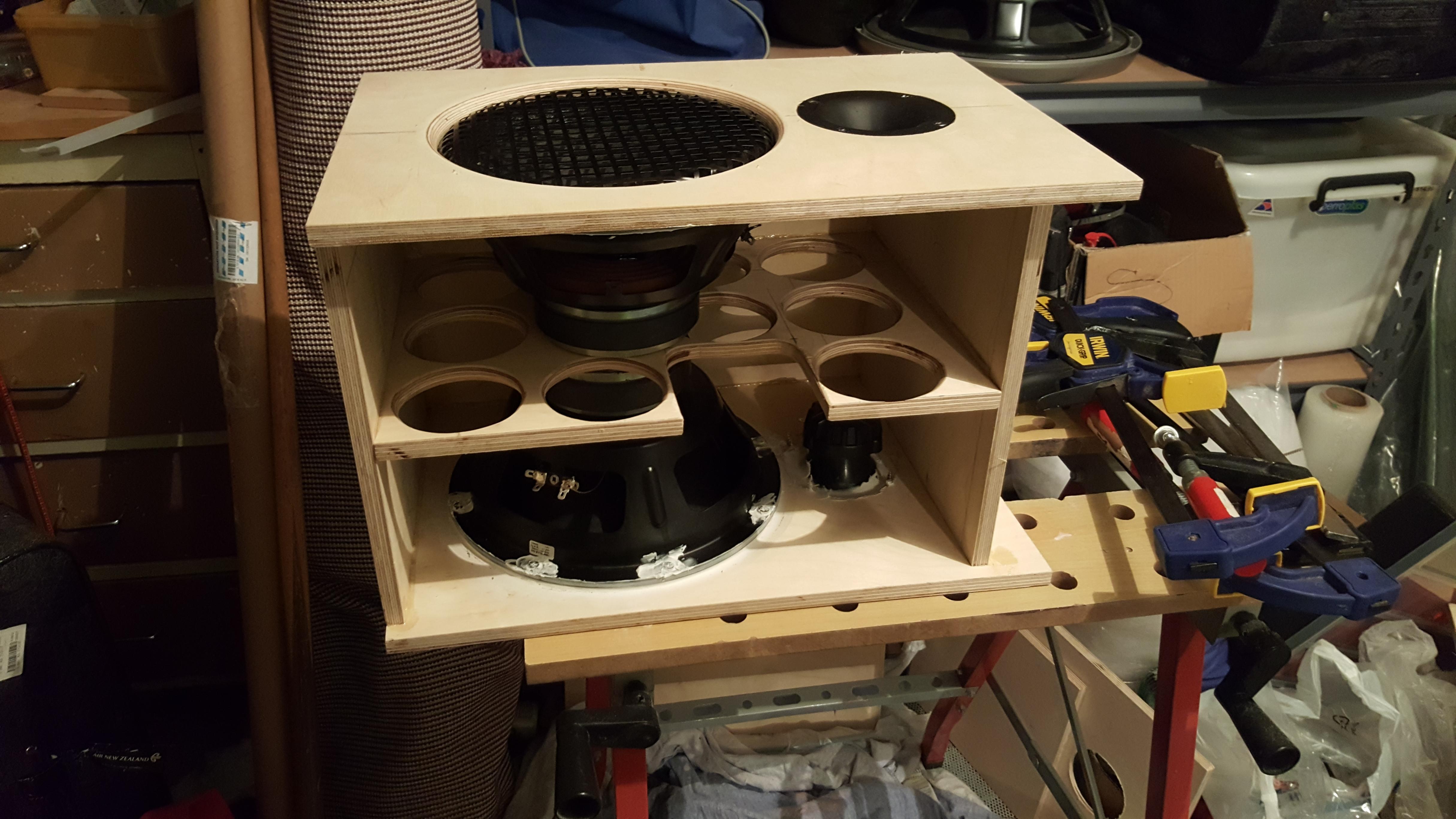

I'm about to glue it all together in the weekend. Just to make sure I understood everything right:
I will use 2-component epoxy resin adhesive to glue the drivers to the center brace, acrylic sealant for drivers and tweeters to front baffle and wood glue for the cabinet.
Between front baffle and speaker are grill and gasket, can I just fix them all with acrylic sealant?
I will round over the edges of cabinet, handles and driver holes with a radius of 12 mm using a router. Right?

Hi
Low modulus silicone sealer to glue the drivers to the baffle, remove the rubber surrounds from the grille and sandwich the edges between the drivers and the baffle, the silicone sealant squishes through the grille holes and hold it all together.
2 pack epoxy "liquid metal" to glue the driver magnets to the centre brace
2 pack epoxy glue or strong wood glue for the cabinet....
Hope this helps

First steps:
Boominator DIY 2016 - Album on Imgur
Now it's glued together! Front panel and solar panel are yet to come.

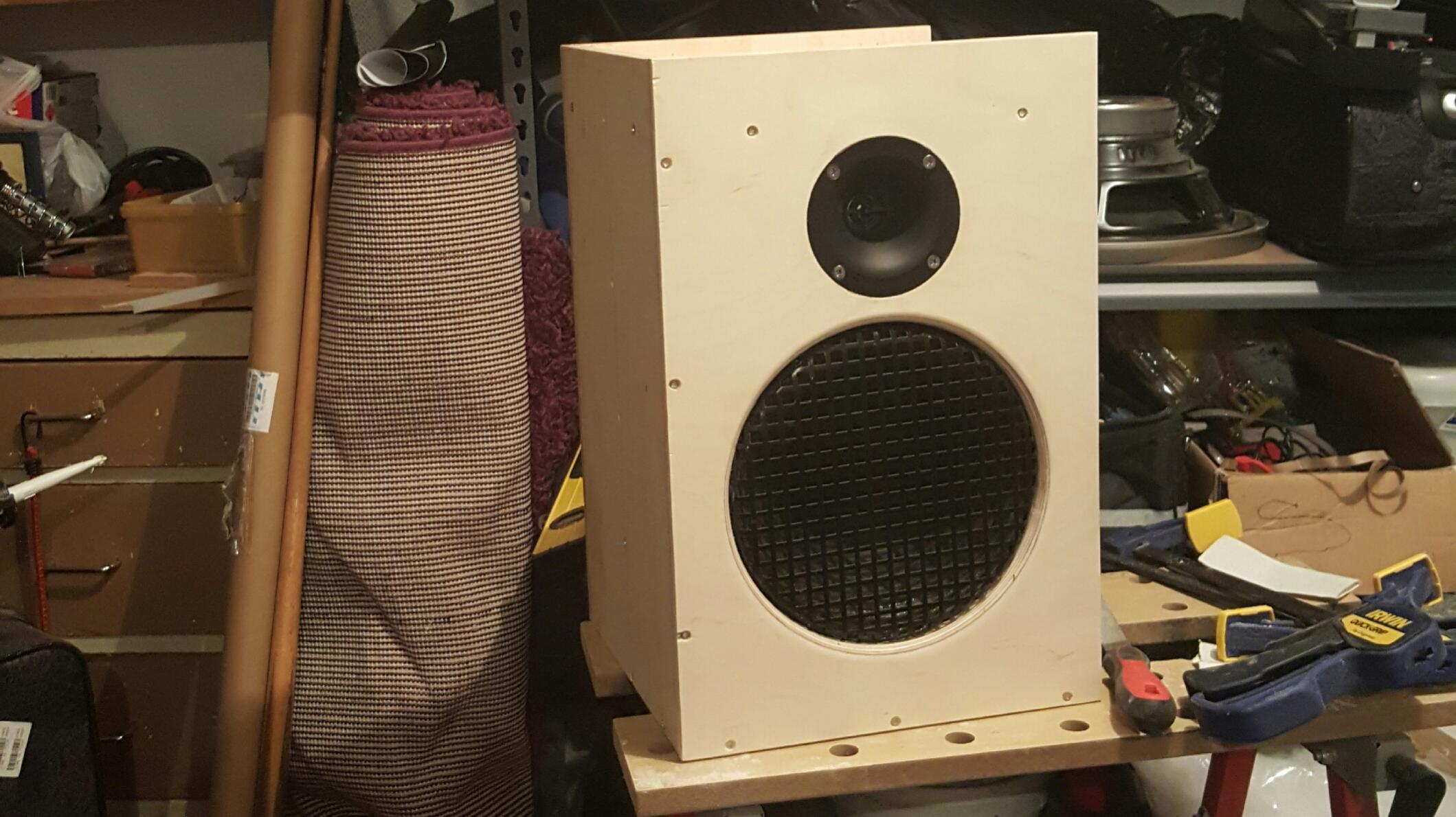

Ended up going with holes in the center brace, coming along really nice. I modded the electronic component to be a little smaller as well as rearranged the speakers/port position, so it's standing up and using pht407n but all of the internal dimensions are as the original. Love the wood finish think I might varnish it. Just waiting for the amp, xo components lifepo4 battery to arrive 🙂
Love this speaker so far and I haven't even heard it going yet.

Nice build Camerong.
