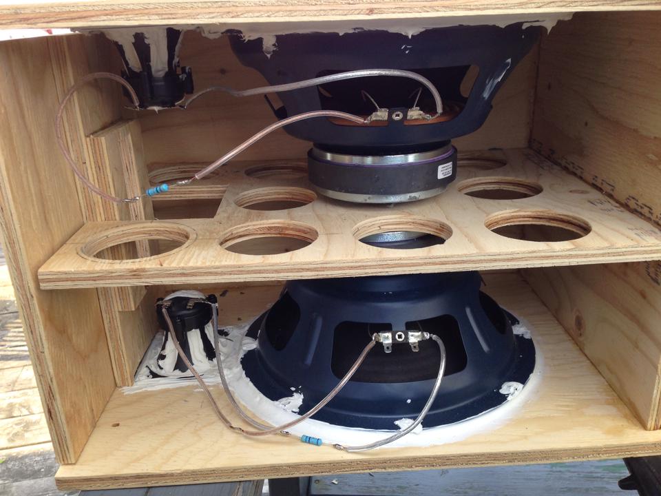

1. In this picture you can see how long ive come with the soldering. I guess my next move is to solder the tweeters together?
2. Do the tweeters also need a resistance between the positive poles?
3. And then i take one positive pole from one of the drivers to the amd, and a negative from the otherone to the amd? 🙂
4. I have a Indeed Hifi amp. Does it matter where I insert the different drivers into the amp? Like is there different + and - poles? ( Indeed HiFi TA2020 - Canopy Sound )

Saturnus said that A option was correct, so I just devide the + cable and the - cable from the amp into two?
