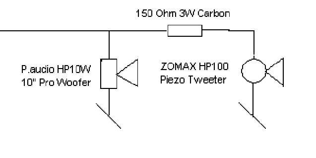

You don't need a filter. Just a series resistor on the piezos between 50 and 150 ohm. 250 ohm would probably be too much. As stated many times before though, I wholeheartedly recommend NOT using power resistors but metal film or solid carbon types.

I am now almost done with my halfinator, I only need to connect the speakers to the amp. I am not sure how to do it? Is this http://img685.imageshack.us/img685/7118/koppling.png the right way to do it?
Thanks!

I've been looking for the right size resistance to use with the KSN-1005A and I've found 2 values: 33 or 47 ohm, 3W metal film. Would that be correct?

I think so. I have the Motorola KSN1005A piezos (same as KSN1001A), and i'm bying both 33 and 47 ohm resistors, and choosing the best, if any difference at all 🙂
Saturnus recommended 33 or 47 ohm for these piezos in an earlier post:
http://www.diyaudio.com/forums/clas...b-ultimate-party-machine-243.html#post2810510
No, like this (ignoring the different values)
What do the cross lines mean? Is it just to connect the to each other and connect it to the amp?
