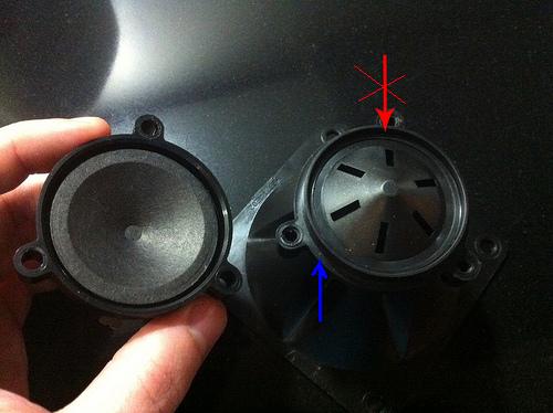

Just opened one of my KSN1005A Tweeters which and now have another question about the whole sealing-of-the-piezo's part:
Do i just put some of the acrylic sealer where the arrow points and, before it hardens, screw it back together?
(Yes, i'm sure this is an obvious question, but i really doesn't feel like ruining the tweeters when we're starting with the building tomorrow..)
No. On the outer rim of the horn part. And it's not acrylic sealant there. It's plastic superglue preferably two-component.
If you feel really adventurous you can file the slots too but I really don't recommend trying it unless you've had practice on a few replicas first.

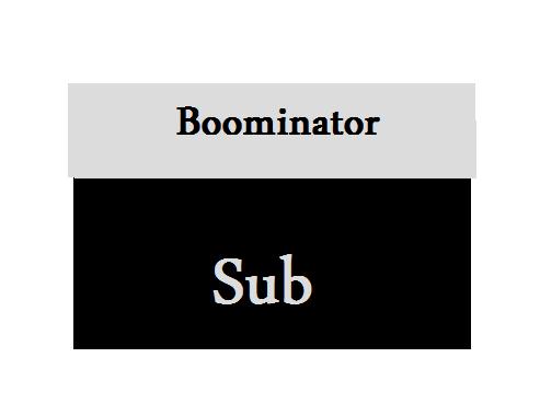

So, something horrible has happened. I have gotten the idea of "upgrading" the Boominator with a dedicated sub solution.. and I figured that I would be needing some kind of low-pass RC filter to filter higher frequencies. The problem is that I have no idea of how to calculate what components I would be needing for this filter, as it is my first time ever making one. That is also why I'd prefer it to be as simple as possible, i.e a RC filter.
I have attached an idea of how I imagined the sub solution would turn out to be. I am wondering if I should get 2 or 4 speakers for the subwoofer. I was thinking of using 12" speakers in 8 ohm, parallel connect them and get them into 4 ohm. This case with subwoofers would also be running on its own seperate TA2020 amplifier.
This brings me back to my question - where can I find some sort of tutorial on about how to create such a filter and calculate the values of the components needed?
Thanks in advance, this will turn out to be an interesting project for a beginner such as me. 🙂

You could solder capacitors in parallel with the feedback resistors on a TA2020 amp.
My only concern here is power - making bass carry far outdoors is hard, you might need a bit more than a TA2020 based amp.
Well, I was thinking of using 4 HP-12W's, which by the spec sheet have 97 SPL. These will be fed with 20W RMS, and paralled into 4 ohm. Are you sure this won't be sufficient? I have considered getting a amp9b, and going into 24v, but this requires alot of battery capacity, and so far I do not believe my budget can afford that.
Where should I put my low-pass filter? 120 Hz? I have no idea where it should start cutting frequencies, so do you have place where I can gather information that enables me to calculate this? And should I get a high-pass filter for the Boominator, that in this case will be playing mid-range and the high frequencies, or just let it play the lower frequencies aswell?
