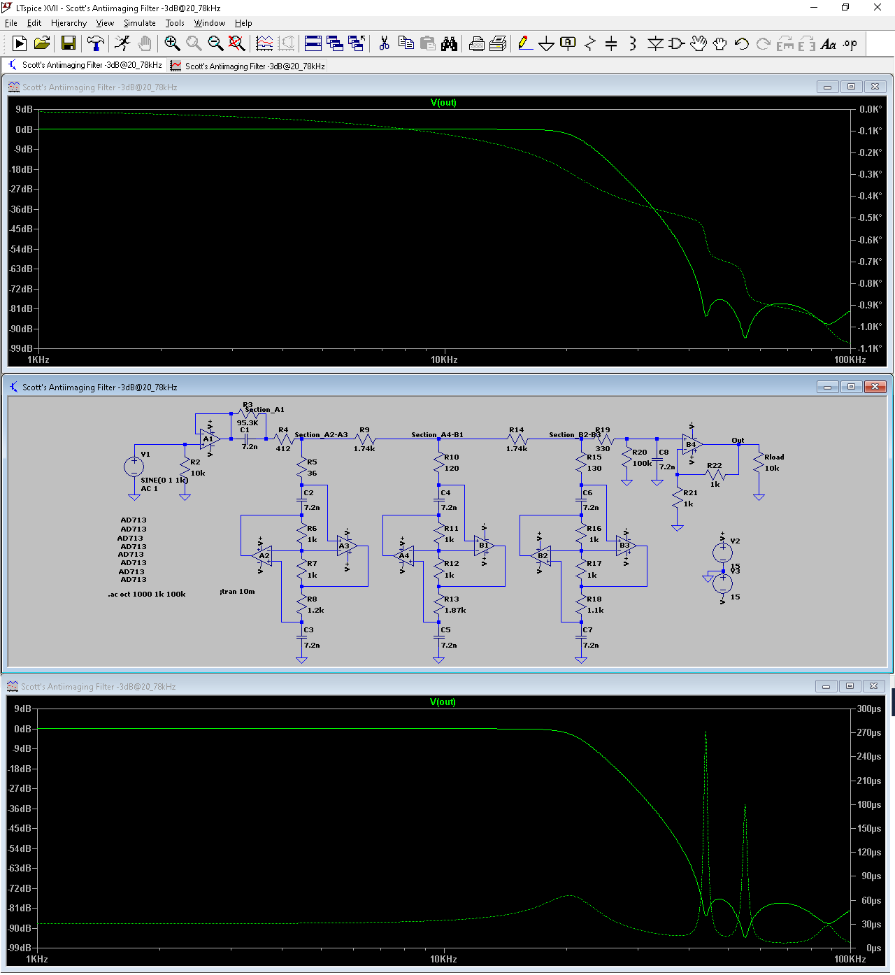

I did some more sim runs. I used standard capacitor values.Of course, but the group delay benefit would still be preserved even if you'd scale the networks for a slightly higher cut-off frequency; it is always a compromise between bandwidth and risk of aliasing in a 44.1 kHz system without oversampling ....
4.7nF//3.3nF (=8nF):-3dB@18.5kHz
5nF//2.2nF (=7.2nF):-3dB@20.78kHz
4.7nF//2.2nF (=6.9nF):-3dB@21.71kHz
At the end it depends on the music genre(s), recording technique (did someone say microphone bandwidth? 🙂 ) and ones own listening impressions.
Very true. A lot of variables influence the outcome.

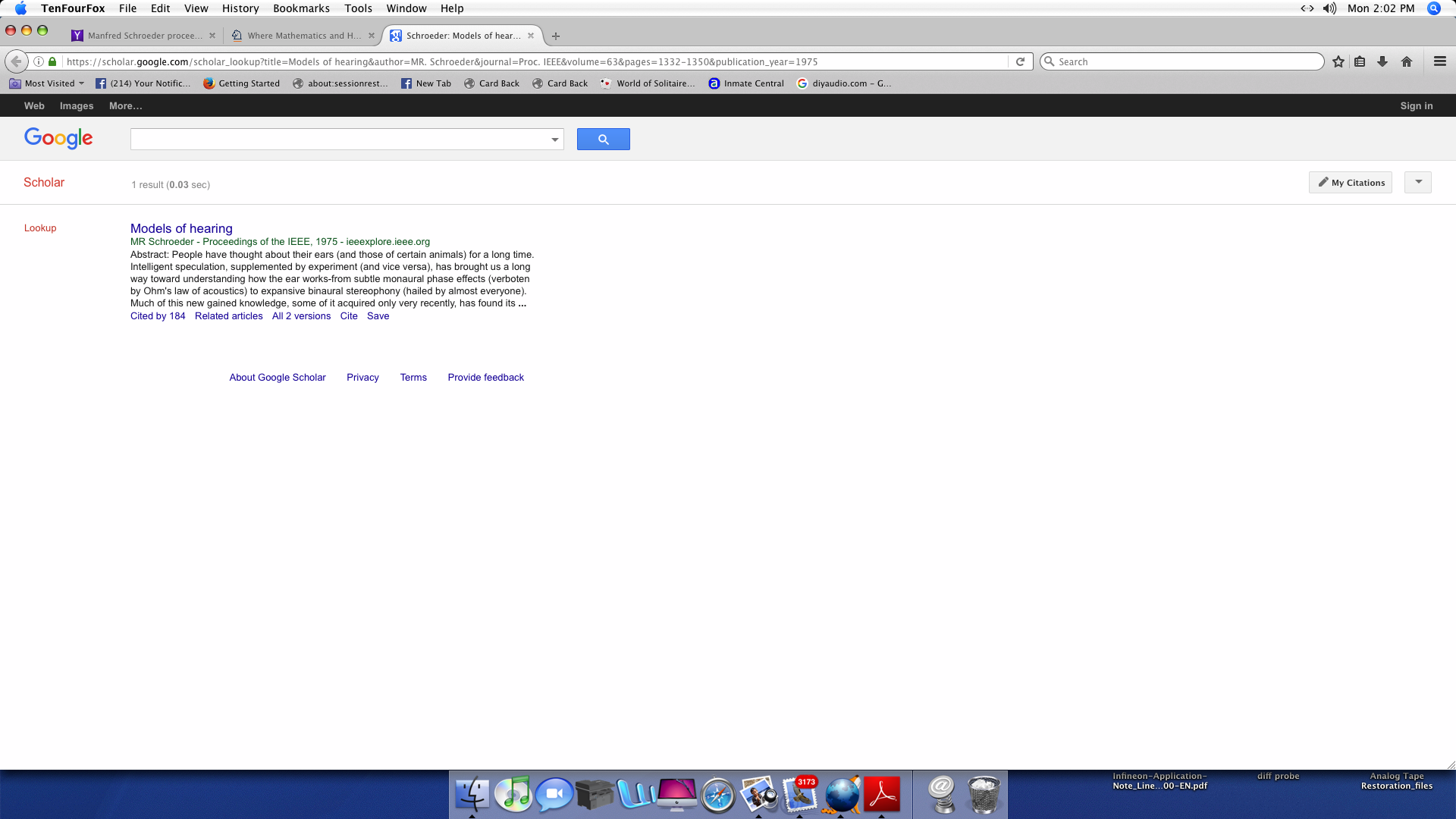

As far as phase sensitivity is concerned, Manfred Schroeder wrote a wonderful article in 'The Proceedings of the IEEE' in 1975-76 of what hearing was capable of, now 45 years ago. Anyone out there with a copy? I have misplaced mine. Ohm's 'Law of Acoustics' is obsolete, as is stated in that article.
