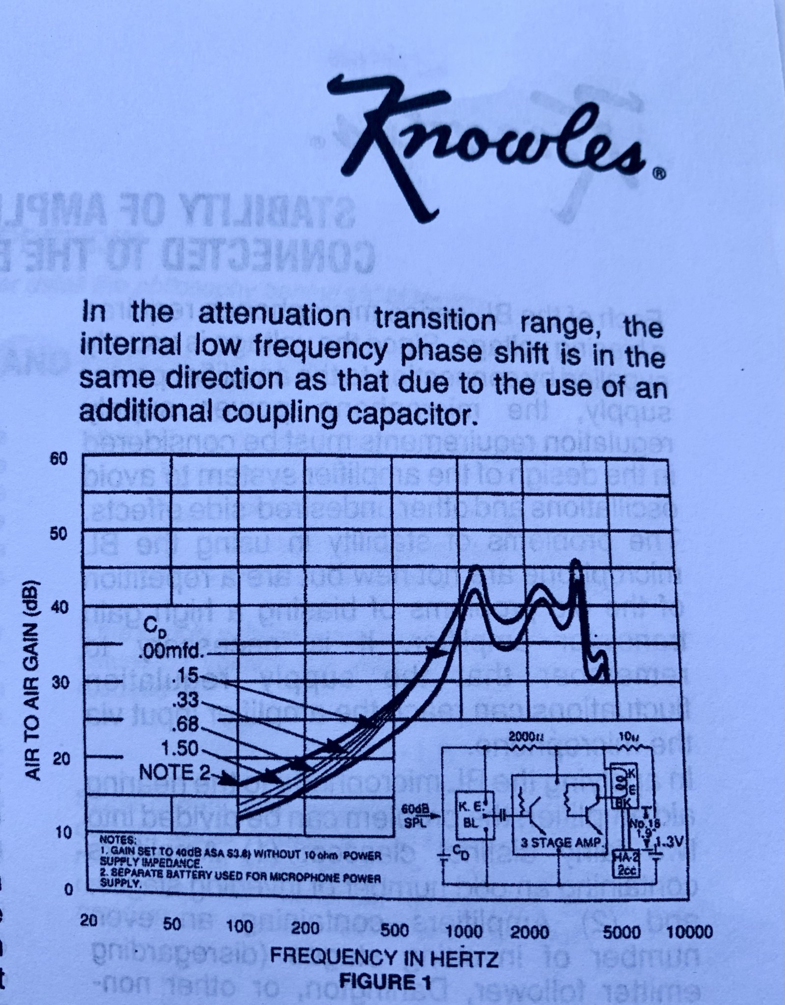

Now I’m starting to understand why sound quality of hearing aids is so disappointing.I would look at Knowles for smaller units
With the FR of a jojo this isn’t exactly studio quality.
Hans
The balanced armature looks to be tuned to typical hearing loss. The fixture is not necessarily going to give a flat response so be careful about making judgements. I suspect most hearing aids today use MEMs mikes. They are much more uniform and consistent than ECM mikes. https://www.knowles.com/docs/defaul...eet-rev-g.pdf?Status=Master&sfvrsn=76bd77b1_4 You can see the resonance at supersonic frequencies. They have help info for the external acoustics to control that.
