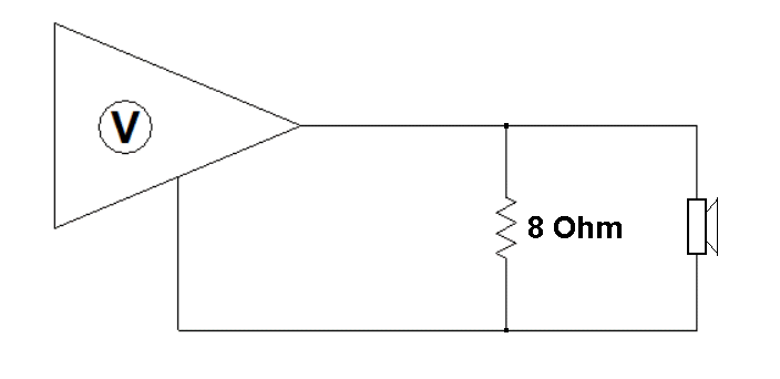

So I (That's I - not someone else...) put all the parts onto a board to mount behind the amp. I found it clear that the impedance transformer didnt like the speaker cable load, so I ripped it all apart and put each tranny just below the driver.
The speaker cable drives the 8 Ohm "ballast" resistor, while the Hi-Z output connects to the speaker through short 'n spread wires.
I'm guessing any capacitance presented by the longer parallel wires of the speaker cable - reflected back through the transformer - was a no-no.

Richard suggested the circuit below. It is really tricky, when analyzed. Regarding current drive...
I recall that I posted a diagram where it was a voltage source and not current, at which Richard said he and others had heard the effects of that 8R resistor in my diagram. See attachment below, this was what Richard was commenting on when I posted it back there.
I am sure you didn't mean to, but you tried to change history. But your example behaved exactly as it should and I have used parallel resistors that way too.
The attachment below is what Richard saw and said he had heard the effect it had.
So if it is audible, then what is that 8R parallel resistor doing?
Do you not believe this is a valid question to ask?

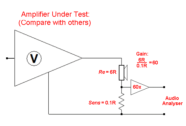

BTW, when you say in your tweeter tests on your website, that it was the speaker's current that you measured, didn't you get that wrong?
Please let me explain. The tweeter doesn't produce current. The amplifier does. So you were comparing the distortion of the voltage side of the amplifier, and with your 1R current sense resistor, you were measuring the distortion of the amplifier's current. So the current output of the amplifier is distorted by the non-linearities of the driver. You then measured the acoustic output (I have done the same) and sure enough, there it was, the amplifier's distortion on the current side turns up as distortion that is heard.
So the added distortion you get from the voltage source, is a combination of two things. But with current-drive, you are left with the non-linear distortion of the tweeter, only that. The added distortion comes from using a voltage source because the amp can only precisely control the voltage, but to do that, it has to relinquish all control of the current, so now the tweeter can affect the amplifier and distort its current. This is the key to understanding the lower distortion you got with current-drive.

I do believe that parallel 8R resistor would have shown up if they were incorporated in your measurements. In terms of distortion, it might have been a half-way house?
I wish you had. The distortion of the tweeter would not have been reduced (that will always be there, no matter how it is driven), but the distorted current would have been reduced. And you proved that can be measured. But I would use a smaller current sense value than 1R, but I know how much more tricky that is.
Please see the two attachments, one that RNM commented on and the setup I use with 0.1R and using s small low distortion side amp.

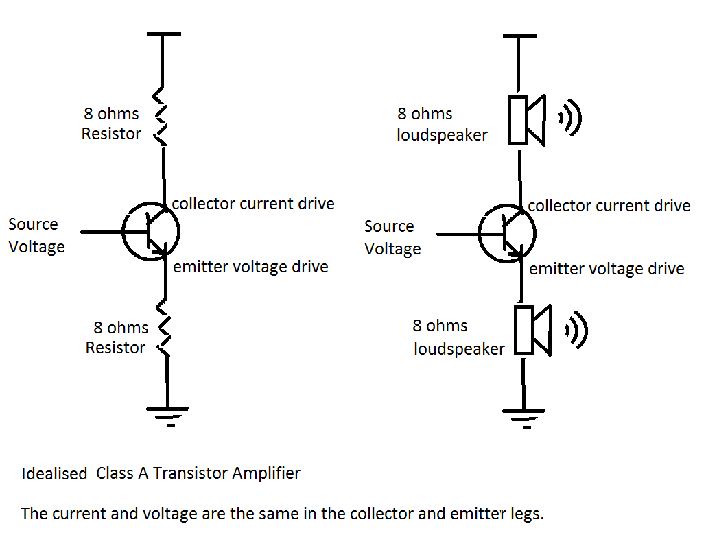

Joe, I am very good at amplifiers in a general sense. I was employed as a system engineer on a 50 ohm submarine telephone cable system. Everything was 50 ohms. Even the plugs. No problems with echoes, group delay or anything. Almost perfection apart from lossy cables on 3 mile runs.
I mentioned my thought experiment on amplifiers:
See, one loudspeaker gets current drive, the other gets voltage drive. They end up the SAME! There is no other conclusion if the transistor has good gain!

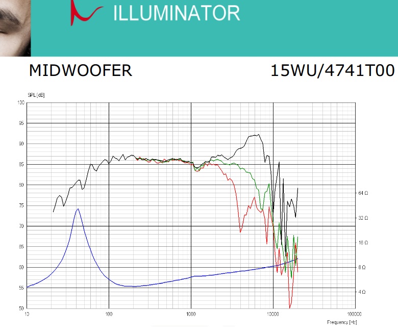

I must agree with Joe that good driver selection will make life much easier for your average diy-er who has not a clue about the mysteries of X-Sim and such.
They rock up with some difficult driver like an expensive Scanspeak 15WU-4741T00. Actually a very good sounding thing in the right hands, and darn good at (green) 30 degrees.
Enlightenment – Scanspeak 15WU with Morel CAT378 – AmpsLab
But clearly is going to need a 5kHz notch, impedance correction and bafflestep. Mike Chua knew what to do with it on what is a first order crossover. And yes, I look at off-axis myself. Because I listen off-axis mostly. But the typical designers only look at on-axis don't give much thought to dispersion or power response.

Such a driver is a good example why high impedance drive can make a difference. When you have a 5kHz -10dB notch, and let's assume it's in an active XO preceding the amp, it does nothing for the H3 motor distortion at 1.6kHz (or H2 at 2.5kHz) which still get this free mechanical boost.Enlightenment – Scanspeak 15WU with Morel CAT378 – AmpsLab

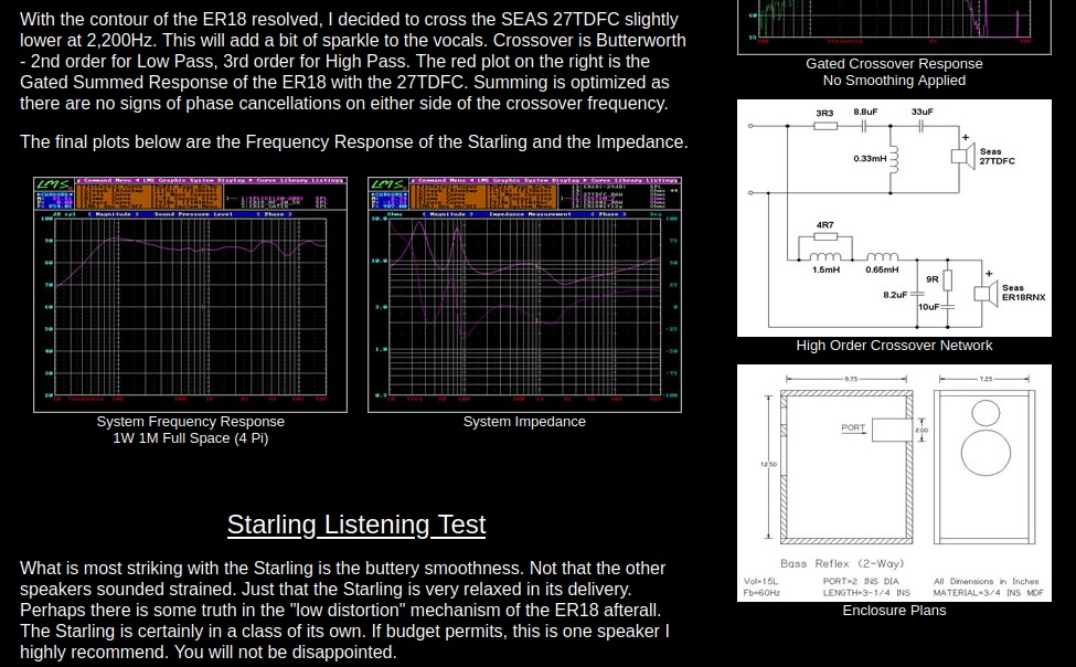

You can get high impedance drive with careful bafflestep design. I was interested in this example by Mike Chua, the Starling. Passive bafflestep. 4.7R on the midbass filter in effect.
Seas ER18RNX with 27TDFC
Solves a lot of problems, Bafflestep mucks up most filters and the source impedance seen by the bass. He remarked it sounded smooth. Sorry its hard to read.
