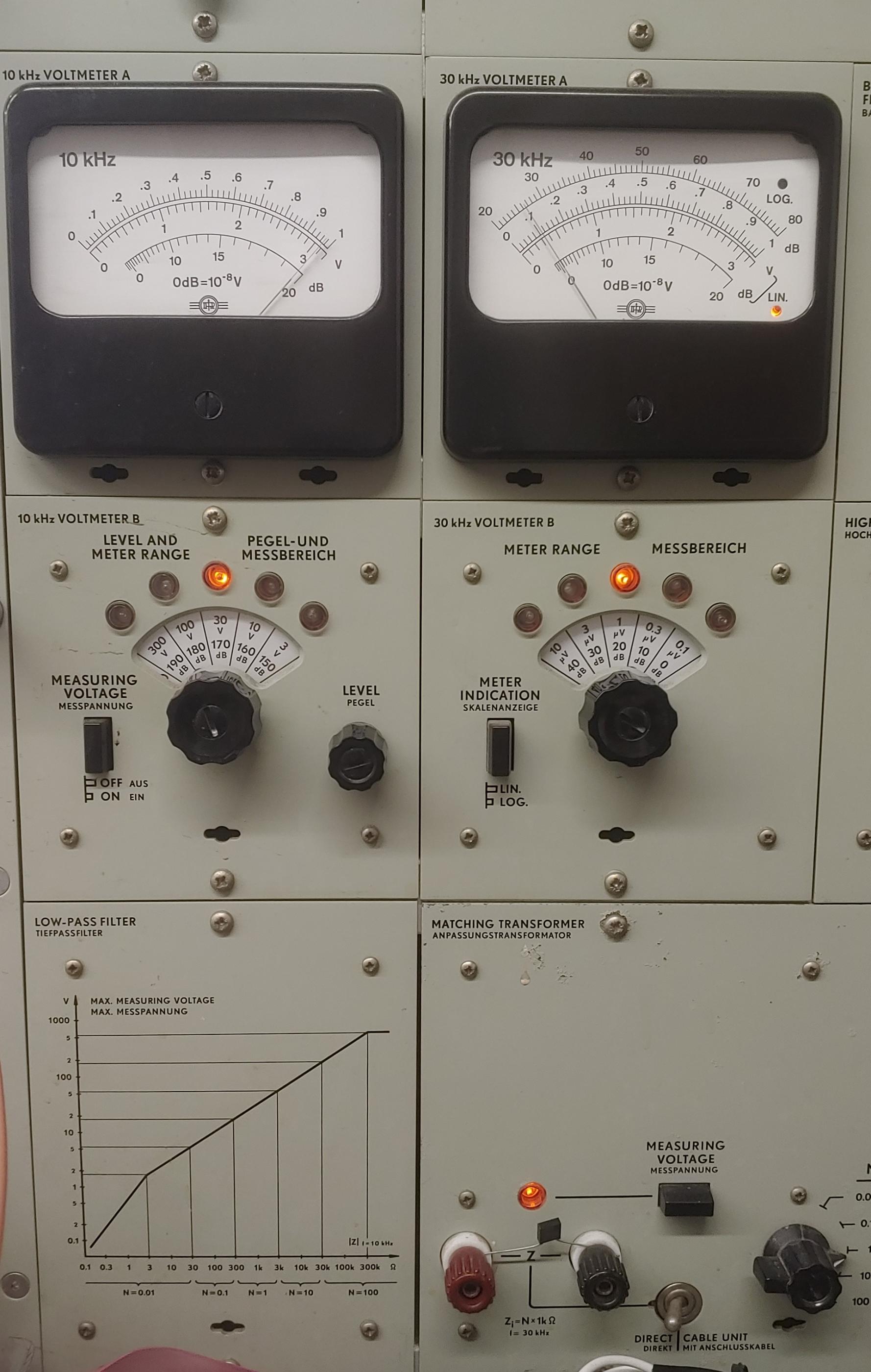

Pics or it didn't happen. 😉
Radiometer CLT-1 component linearity Tester
10V across 20K Vishay S102 -170 dB HD3
Left meter is the 10KHz 10V (170 dB + 20 dB on the meter).
Right meter is the 30 KHz harmonic (1uV full scale) (20 dB + 0 dB meter reading)
190 dB - 20 dB = 170 dB. Which is the noise floor of the 30 KHz filter.
Demian,
I read the test voltage as 30 ish volts and the harmonic as .1 uV ish which does give -170 dB ish results. Not bad. Looking at my results for a similar value, similar type, I measured -145 and dropping with frequency at 5,000 hertz for a 31,600 ohm Vishay. Extrapolating to 30,000 hertz I would expect -160 dB for the third harmonic! 25 volt test signal. Looking back at my notes, I thought most of the distortion was from my test amplifier limiting me to a best level of 170 dB and not the resistors under test absolute limit. Just might have to make a passive filter if I want to look even lower in the dirt.
You probably do need a passive filter. The CLT-1 is a product of the late 1960's really. It started with Siemens as a way to find potentially defective parts. Its all passive LC filters and discrete amps.
I can switch ranges up to 25 V and see what happens. The instrument can deliver 1000V but the floor is not as low, and I'm not comfortable working around it on those ranges.
PM me if you want a copy of the manual.
When the IEC was updating the resistor test, they acknowledged my method but did not adopt it as they really didn’t understand it and thought it too complicated.
Thanks for the manual offer, but I have the original standard and the inductor data set. I actually have some inductors that are good enough and shielded. The funny shields that don’t have hysteresis.
I can go up to 150 VRMS. I noted you had the transformer module. Can’t imagine why a kilovolt on binding posts makes you nervous! 😉
