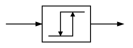

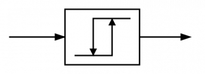

Yes, but OTOH applying the linear theory to Class D has it's unique set of challenges. Like, for example, applying negative feedback to a system (an open loop class D amplifier) with a "dead zone" transfer function (in the time domain).
Isn’t that called bang bang control 😀
