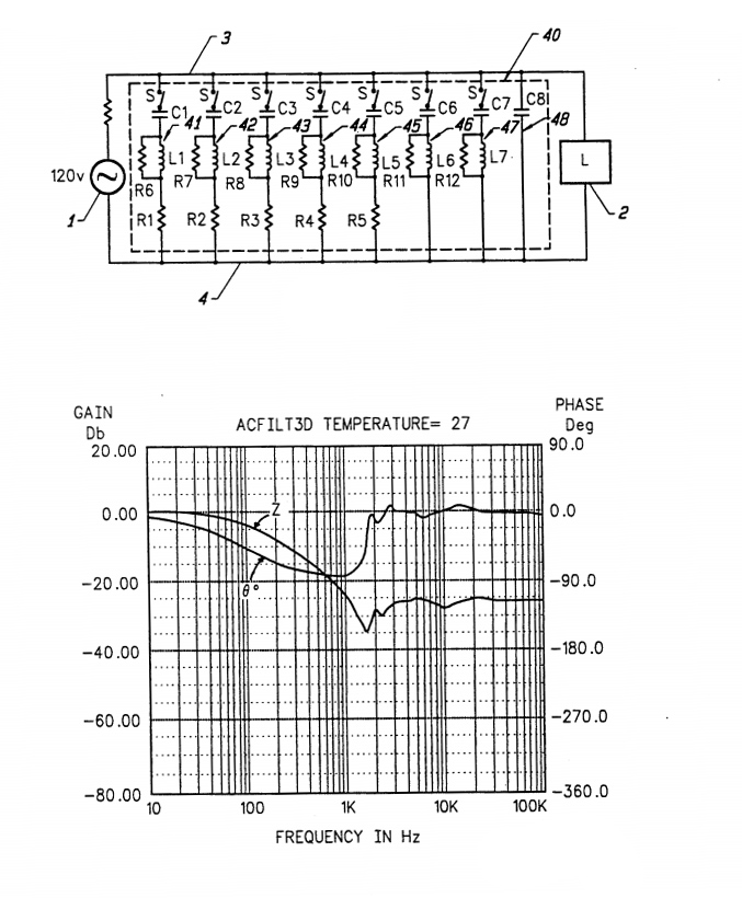

Just by coincidence, I came across two patents.
# 5.227.962 from july 13, 1993 and # 5.260.862 from nov 9, 1993.
Both patents are identical in describing a power line filter with 7 notch filters on the 60Hz mains harmonics plus an extra cap to correct the power factor to become close to 1.
These two patents are claimed to be owned by MIT Cables and used for their power conditioners.
But guess who's the inventor of these patents, yes indeed, it was the one and only R.N.Marsh. :D
Hans
