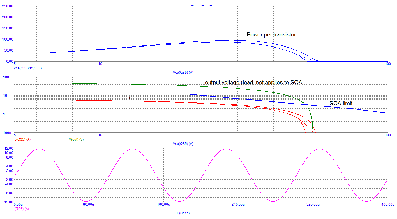

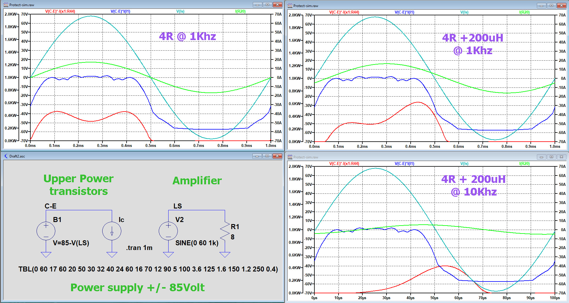

The objective is always to stay within the SOA of the output transistors.
For that purpose you could put this SOA in LTSpice in a current source with a PWL file.
The voltage source in the simple circuit at the left bottom generates in this case 85V-V(Ls), being the VCE of the upper output transistor.
When driving the amp with whatever load, this circuit follows the SOA, in this case the blue line with V(C-E)*I(I1), while looking at the amp you get the real power dissipation in the upper output transistor with V(C-E)*I(Load) represented in red.
In the first example with a 4R load, the dissipated power at @1Khz and 50Vrms is completely within the the Soa. When adding 200uH, representing the LS cable in series with with the 4R, the red line already touches the Soa.
However the same situation @10Khz exceeds the Soa, and a breakdown is to be expected.
For all different sorts of load, whether capacitive, inductive or a combination of both, this setup shows exactly what's within or outside the Soa.
Hans

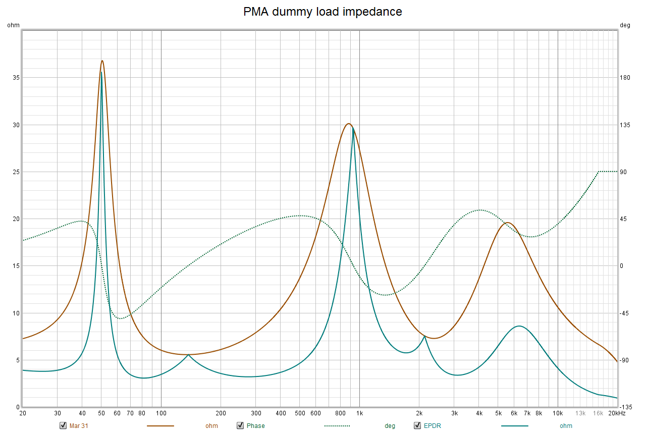

Hi Howard, thank you, you probably mean a kind of REW features that I have not tried yet. I posted the dummy load impedance plots and of course I have Microcap simulations. I will have a look at REW to find out which kind of measurement you mean.
Hi Pavel,
Here is an REW graph showing static impedance and EPDR:
Interesting concept with a pretty long historical background...
Cheers!
Howie

Hi Pavel,
Cheers!
Howie

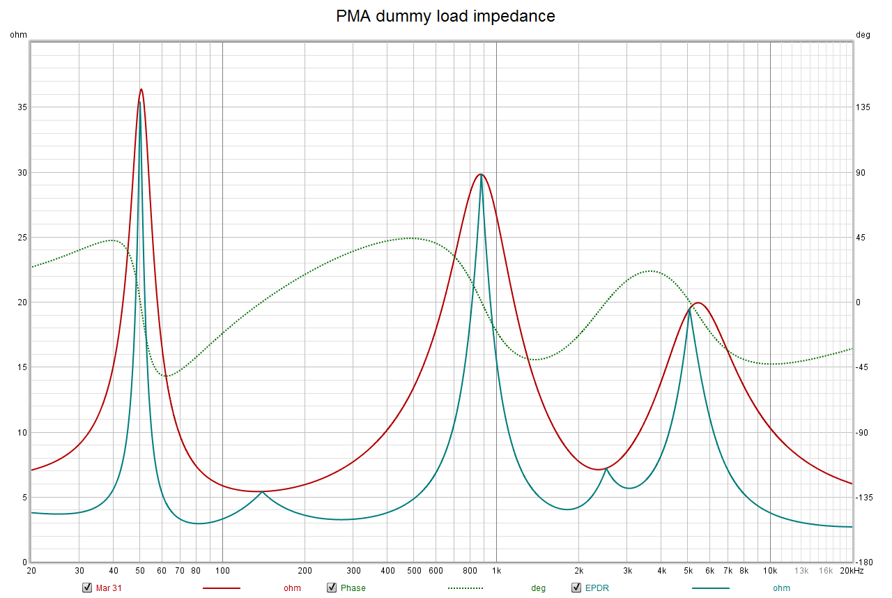

Hi Howard,
thanks for the hint, got it, here is the dummy load impedance with the EPDR curve. It helps me to understand why some amps have issues with it at high frequencies.

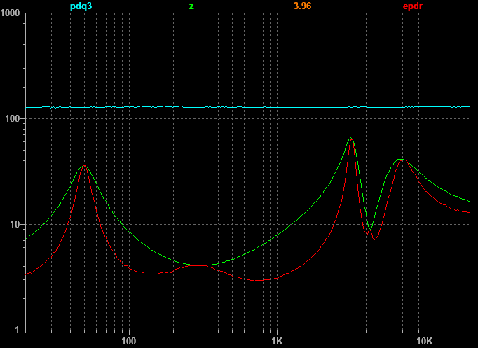

I've been looking into this EPDR stuff and those charts don't look right to me. I don't think the sharp peaks are correct. You can simulate EPDR and the result looks more like the attached image.
I suspect there was an over application of calculus and trigonometry when common sense would have been sufficient. The output stage dissipation is just the total power minus the power dissipated in the load... For a given load impedance, phase angle does not change Iavg or total power, so any reactive power not dissipated in the load must be dissipated in the output transistors instead.
I loaded the paper's equation into LTspice and it does not match the simulated EPDR.
One could argue that if you are sending out 50V RMS at 10kHz playing music you have bigger problems than SOA? At least in a domestic environment.
I know it's popular to build audio amplifiers that can pump out 100W in the LW band but how much does that matter when you are not driving a pathalogical speaker or running a PA?
Hi Howard,
Anyway something went wrong with one of my soundcards (see phase in the previous measurement).
This is corrected with another card used.
I know, my question is if it was related to my amp. The SOA at 10kHz and 4ohm+L is below, there is still enough space.
There is. And when you add in crest factor and the frequency distribution of music it gets even bigger. Unless you are Ed you won't be pumping 250W into a tweeter for very long until it stops being a tweeter.
My example was a reaction to this EPDR thing, not to PMA's amp.
EPDR is rather vague IMO and looking at the Soa gives a much more valid result.
And yes, 50Vrms at 10Khz is not what you expect while playing music, but large peaks caused by whatever nature might cause this, potentially resulting in a broken amp for this specific amp, a ML23.5, which happens more than once.
Hans

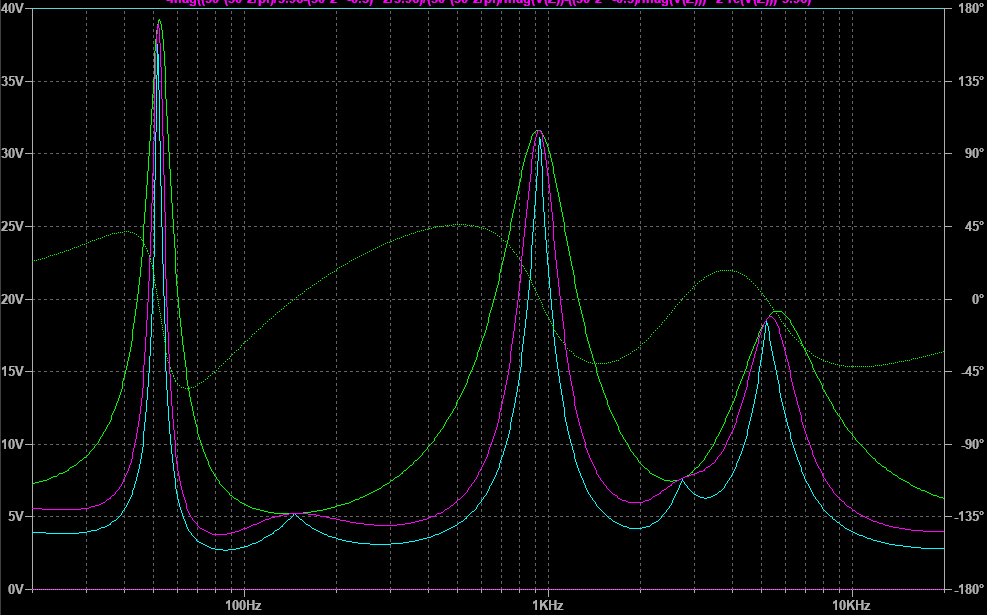

My problem with EPDR isn't related to your soundcard, but since you fixed the measurement and there is a schematic on your page, I decided to plug it into the EPDR simulation. Looks like I transferred the equation correctly (cyan curve), but it doesn't match the actual simulated EPDR (magenta curve).
I have the charts size matched so you can flip between them to compare...
