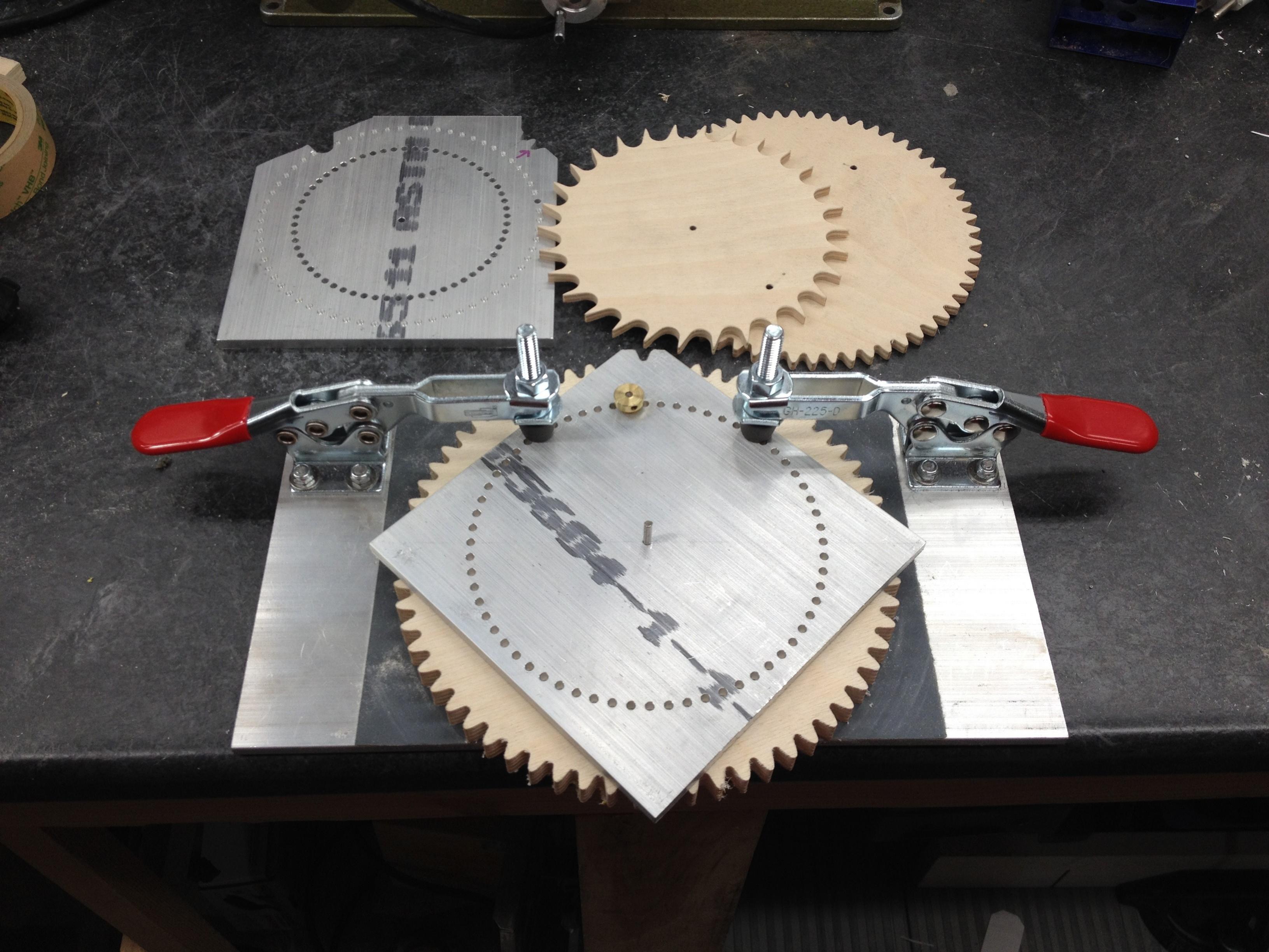

Yes. It only takes me about an hour using the pin router. The guide fixture is the difficult thing, I make it in aluminum.Let's see if I understand this, a skilled craftsman could cut the gear by hand in way less time than the software would take to load?
The pin router fixturing is at that level. By hand, I would probably sever a finger.My machinist training says a skilled craftsman can keep an accuracy of .005" by hand.
None of the gears in a clock are involute, this due to friction. Cycloidal and epicycloidal rule, with slight mods of course.What pitch angle are you aiming for? Seems with four or more axis and the right bit routing out a gear should be much easier.
My pin router fixturing includes indexing plates. I have a 60 and 64 tooth set. If I need a count not available, my mill software comes with software that can setup N holes on an arbitrary circle.I do have an indexing head that uses guides. Of course for a bit of change you can get a continuously variable one.

Here's one of the fixtures. Base is .250 alum 6 by 12, 600 grit emery glued to it to prevent sliding, plates are both indexing wheel and tooth profile. Granted, I can only do maybe 8 tooth profiles depending on radius.

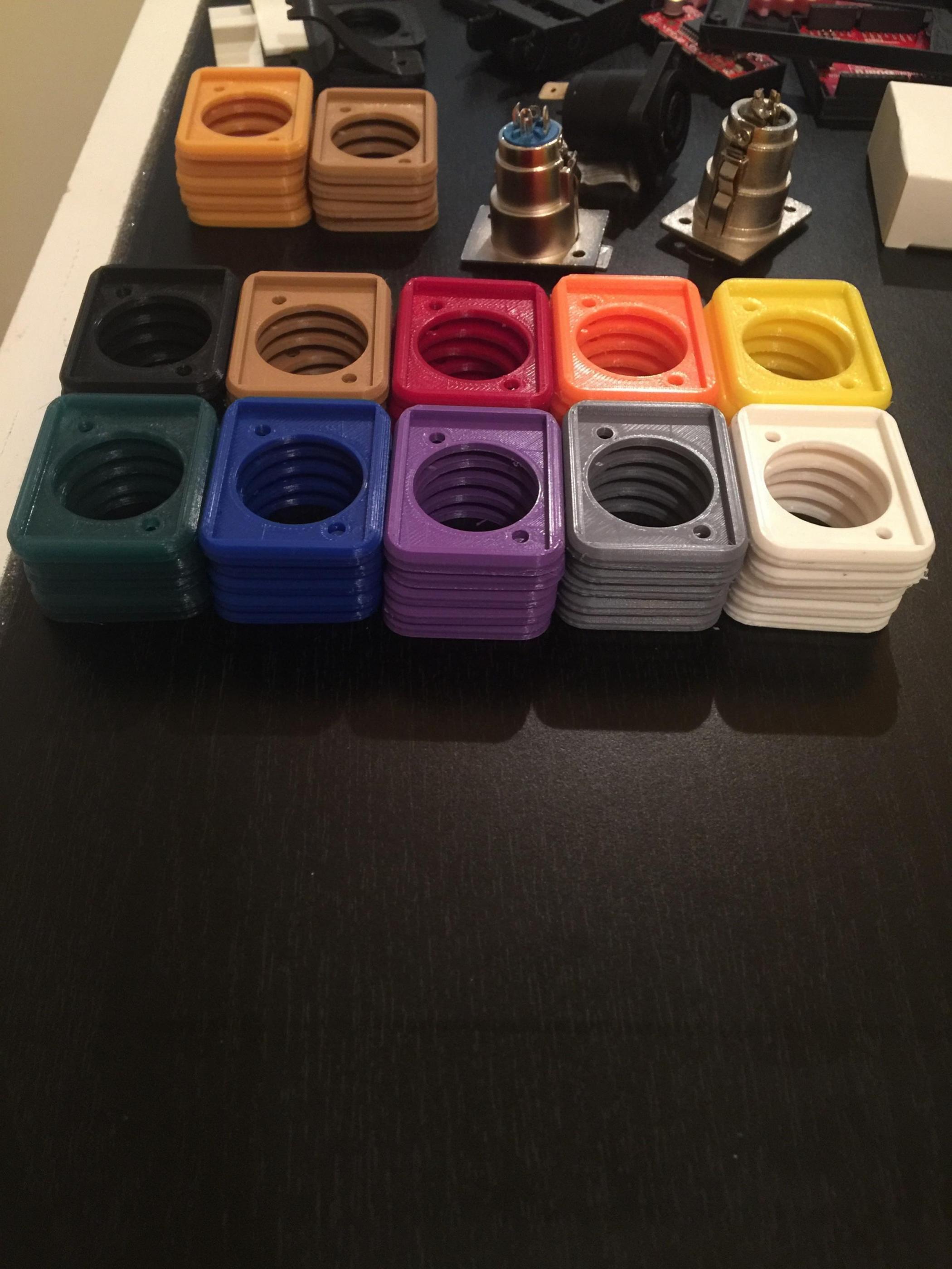

Ed, you need a 3D printer...not sure why the pic is sideways...
ps..those were printed at lowest resolution, if I use 120 micron slicing, it gets much better print quality just takes longer.
ps.. I have an 8 input mixing panel, a color coded snake 25 feet long..I recently purchased 1000 feet of belden (sumptin) and will make a 125 foot snake, the stage end will be a section of aluminum C channel (for weight) with 8 xlr holes. I have 8 snake to mic cables, and just got the colored heatshrinks to code them and the mics.
Did a reception talk with 7 speakers, and during the Q and A, it would have been great to see the mic colors from the mixer, as the speakers were not used to public discussions so I had to drop all mics except the person answering the question.
jn
