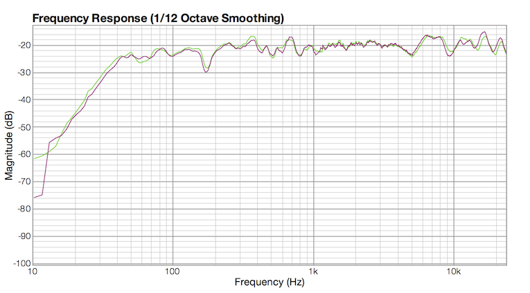

Well, you make my point further. This is bad loudspeaker data from Stereophile. ONLY near field measurements (or anechoic) are supposed to be used to measure the speaker itself. No one is interested in someone else's room's affect on any loudspeaker being tested. And rooms are not all the same. It is useless info about the ESL its self, otherwise.
The ESL is quite flat as I also measured.
THx-RNMarsh
Measuring quite large panel speakers (to get something comparable to the frequency response of "normal" speakers) was always a challenge.
Measuring in the extreme nearfield will result in a curve with downward slope.
There was a reason why big panel speakers response was often given as a 1/3 octave graph instead of the usual one.
But AFAIR JA shows frequency response curve is the averaged result of a family of curves taken on different angles. Loudspeakers with higher directivity above 10 kHz will therefore always show less level in that region.

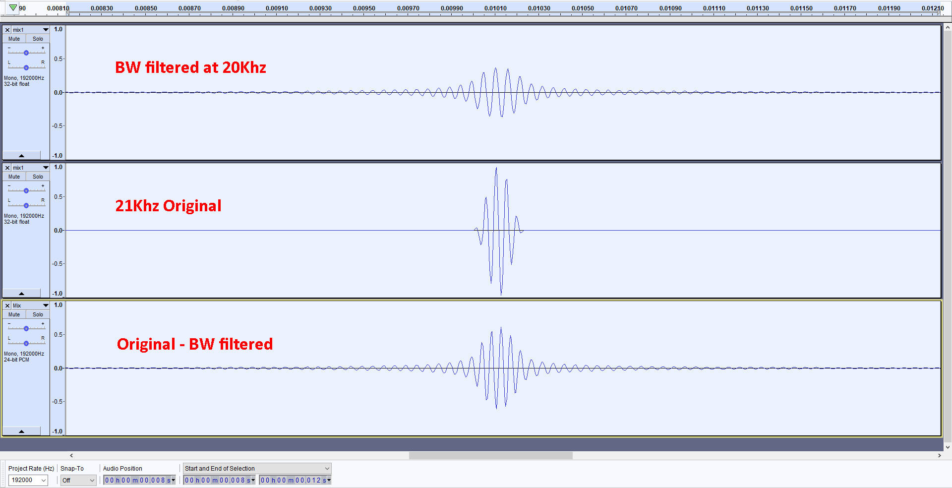

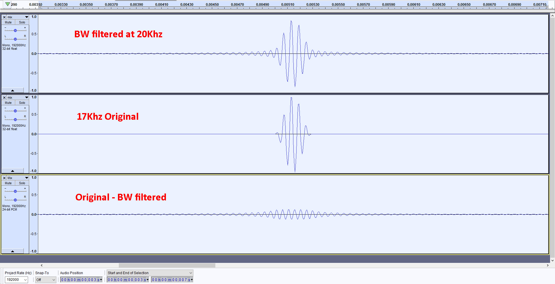

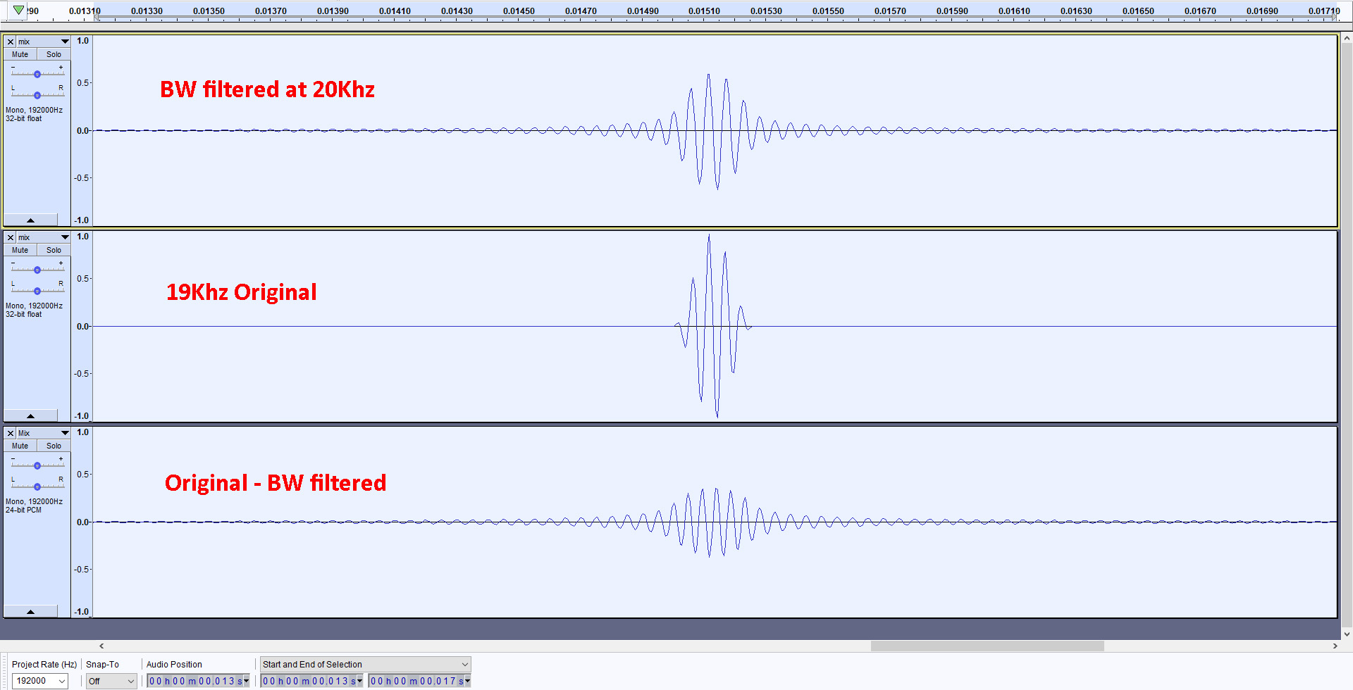

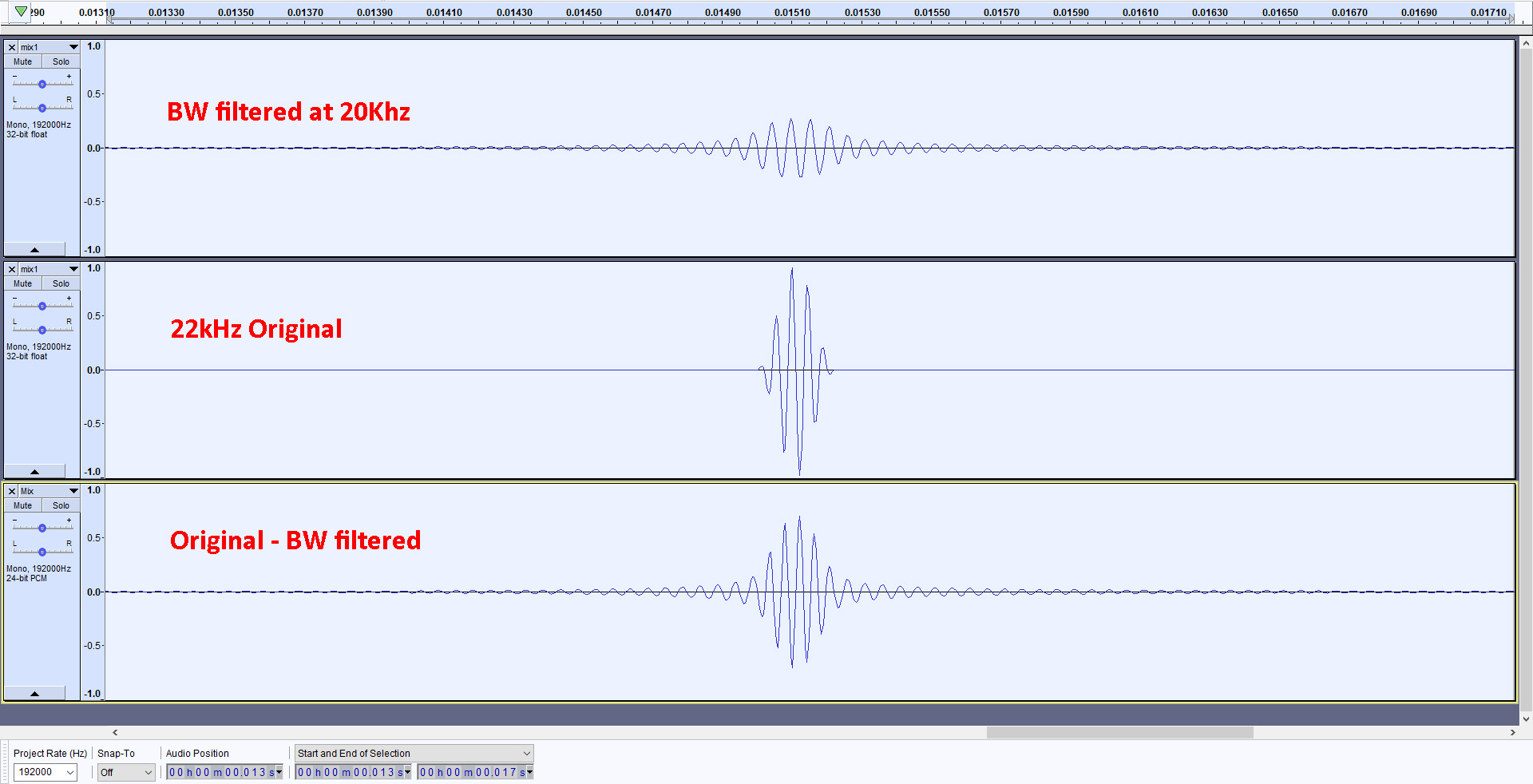

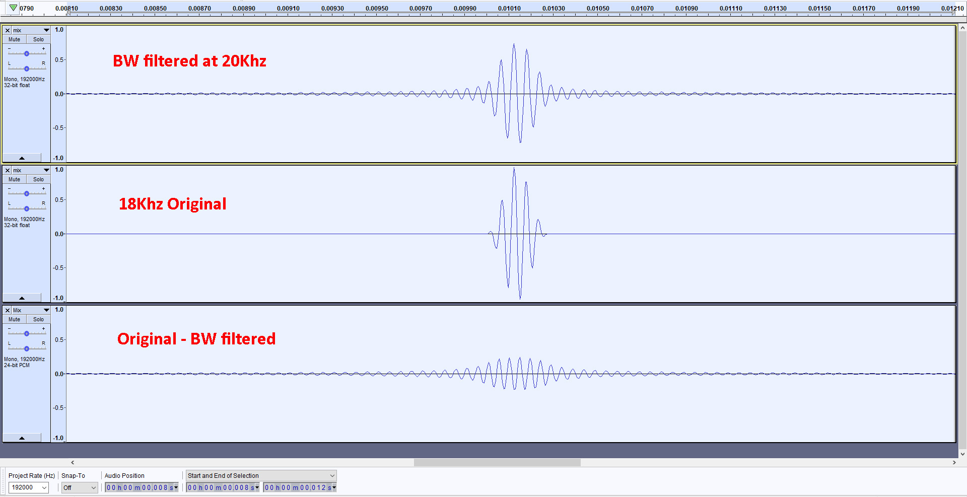

I have made another set of sims, this time by using a ratio of 5 between the raised cosine and sine to get the sidebands at a higher level as the factor 20 in my previous sim.
Since my Brick wall filter is at 20Khz, I have chosen for sine frequencies of resp 17Khz up to 22Khz, each 1Khz apart.
What you can see is that all content below 20Khz remains, including the sidebands.
The difference signal, being the removed part by filtering, shows the sum of the Gibbs exitation plus the content above the 20Khz Brick Wall filter.
I don't see anything where I could even suspect that the sub 20Khz signal is crippled in any way, apart from the Gibbs additions, in this case at 20Khz, but for a 44,1 CD at 22,05Khz, beyond our hearing limit and thus completely harmless.
Hans

Han's,
Your 20 kHz plots are a perfect example. Look at the before and after plot. The filtered 20khz has a different frequency. If you overlay orig and filtered, you will see the frequency shift very clearly.
This is the exact same phase walking effect that occurs when two sines beat.
And yes, I used the term Gibbs envelope to describe the form of the Gibbs. Another new term is phase walking..the effect which occurs when a sine is added to a another of different frequency. I demonstrated this earlier, showing that the frequency within each lobe for two sines added was the average frequency but that it flipped sign each lobe. IIRC, it was 17.5 added to 22.5, and I overlayed 20khz to show that exact effect.
So, the envelope modulation of a below Fs signal has two sidebands. If one sideband goes above Fs, the filter will remove that, and as you are demonstrating, the resultant output will have a different frequency content as well as a different envelope. If you were to run with continuous modulation, you will see that subsequent lobes will flip phase, and that an FFT will not show the within lobe frequency, but only the two sidebands.
For my exponential envelope modulation, it should demonstrate a time varying frequency shift. That is why I chose it. It's all about metrics, the ability to measure.
In addition, you have demonstrated that the lower frequency output also has a wider envelope.
These are significant differences, and are caused by having frequency content so close to Fs.
Jn

Isn't that exactly what was envisaged in the first place ?Han's,
I still don't get where you are heading to.
There are technical things one can describe and measure, but in this very case we are looking at Audio signals that may or may not be crippled by filtering the signal above our hearing limit.
That a seemingly frequency shift takes place has everything to do with the subtraction of the "above Brick Wall" and the addition of the Gibbs frequency, both being above our hearing limit, that's it, I see no further magic.

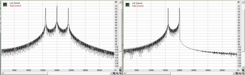

No It doesn't.If you were to run with continuous modulation, you will see that subsequent lobes will flip phase, and that an FFT will not show the within lobe frequency, but only the two sidebands.
See both spectra below, in this case a continuous signal composed of a 20Khz sine modulated by a 4K raised cosine, before and after 20Khz brick wall filtered.
Hans
No It doesn't.
Hans
It's not "seeming", it is frequency shift. Overlay the before and after filter and examine the zero crossings.
As I said, the FFT does not see the resultant frequency of the output. You have demonstrated exactly what I said.
