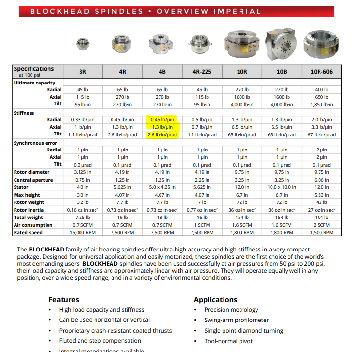

The air bearing is ideally suited to ultra-high-speed shafts where shear in a liquid lubricant would be excessive. In these systems the viscosity of the air is sufficient to provide entrainment and a hydrodynamic cushion (see Streibeck curve). Studying this characteristic of hydrodynamic bearings shows the slower the tangential velocity of the shaft relative to the bearing and lower the viscosity of the lubricant, the thinner the lubricating film.
A 10 mm shaft diameter turning at 33.33 RPM only has a tangential velocity of 17 mm/s, extremely slow. Also, the lubricant is air which has a viscosity 3000 times lower than that of typical oils used as lubricants. This likely results in an air film of a tens or single digits of microns.
This is not such a good idea in TT bearings, either for the tonearm or platter. They must be linked together as tightly as possible to eliminate any differential movement. Radial differential movement in between the platter and stylus is a good description of the desired cartridge output signal. Due to the low viscosity of air, the radial tracking forces will likely be able to modulate the air film thickness, so the differential relationship between the platter and stylus will not be fixed as it needs to be. This would seem to apply to air-levitation platter systems as well.
Of course, I could be full of s#!t...

No you are not.The air bearing is ideally suited to ultra-high-speed shafts where shear in a liquid lubricant would be excessive. In these systems the viscosity of the air is sufficient to provide entrainment and a hydrodynamic cushion (see Streibeck curve).
For low rpm applications, static air bearings might be used, which require external air supply pressurization system (pump noise? Complexity?).
Hydrodynamic air bearing (foil bearings) do not require external pressurization system but rotor shaft rotational speed has to be very high.
The only place I have seen air bearings on aircrafts is at the shaft of the air-cycle machine (a component of the cabin cooling air conditioning system) revolving at >10k rpm

Yeah the blockhead spindles are very nice from what I've read (haven't seen one in person). My original comment about precision spindles was meant in all of its tongue in cheek, as I'm 2500% sure the mistracking of the groove itself in the record would greatly outdo the runout of even a modest bearing setup. Not that, in general, the folks macing precision machines make turntables. 🙂
George -- while the air compressor itself is obnoxiously loud, the air bypassing our high speed spindle at work is very quiet. So a compressed air tank or a large pressure tank that lasts long enough wouldn't be beyond reason if someone starts with the presumption of an air bearing TT. I'd see much greater value in making a "TT to end all TT's" for commercially capturing (and touchup) of antiquated vinyl with no masters around. Get as good a digital capture as you can.

if you need an exceptional bearing the blockheads are wonderful. I have used them in magnetic disc trackwriters and on turntables. Andy Payor solved both the compressor and the dry air problems pretty well for a consumer table. The bearing doesn't use a lot of air so the compressor is not that large. it still needs a large box and should be remote if possible. The vacuum holddown works well but everything needs to be clean before you flip the switch.
