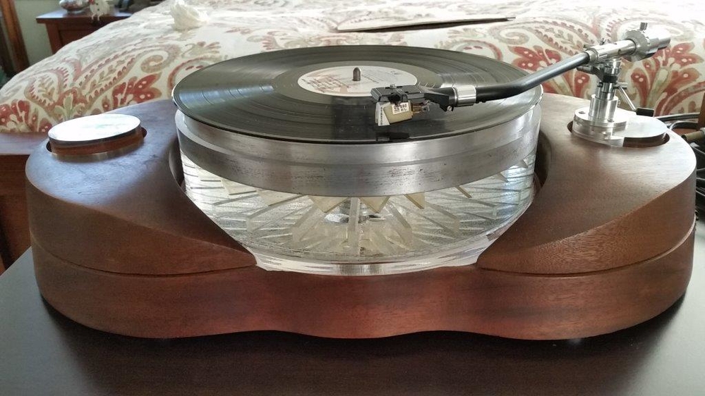

A for effort Howie. 🙂 I could joke how I've been wondering why some of the more extreme TT designers haven't gone to hydrostatic bearings for the platter (allusions to some/a lot of precision instruments), but I digress. We'll get back to cables or the fact that people are deaf/imagining things/misguided in some fashion/etc soon enough.

A for effort Howie. 🙂 I could joke how I've been wondering why some of the more extreme TT designers haven't gone to hydrostatic bearings for the platter .
Of course they have. I can think of a couple of air bearing plattered TTs Air Force One - TechDAS High End Turntables 79kg of excess*
There was also one that used hydrostatic drive. Basically a plastic torque converter you put a record on.
*they did an even sillier model which came in at over 300kg.
Rockport built turntables with the Blockhead Spindles – Professional Instruments Company air bearings for a number of years. They were really expensive but worked pretty well.
