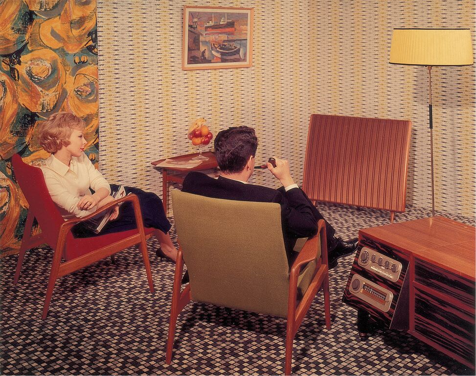

If you look at the original advertising posters for QUAD as attached you can see the ESL is stuck in a corner, possibly for bass reinforcement but that is going to mess with the performance of a dipole, even with the rear wave damping the ESLs had.
If you look at the radios George posted, they were designed for as wide dispertion as the form factor would allow and certainly not to appear as a point source. It seems they wanted to 'fill the room' and maybe that's whats' needed.
Interestingly a number of archivists and restorers of old recordings do add some reverb at the end of the process and claim their customers prefer that. Acoustic recordings in particular were very dry as the horn had to be close to the orchestra but I do also wonder if that helps with the issues noted by Pano and the Late Mr. Heyser with sending the same signal down two channels.

This goes against what Mr Heyser wrote which is in itself interesting and in my mind suggests the stereo speakers are not optimal for the job. I have a feeling you need a very wide dispersion with mono, but no facts to back that up.
