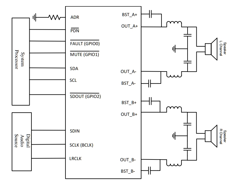

You certainly have my setup beat regarding dynamic headroom! I'm running the paltry tas5825 with maybe 10X less power available to the speaker.
However the tas is digital input and I assume the way the board is designed, it receives an I2S stream directly from a bluetooth module. (it does have an analog input I assume provided as a convenience, so I wont bet my life on it; however by spec it's definitely a digital input amplifier)
The output works the same way as the 3255, a H bridge with each leg sitting at 50% duty quiescent. I assume the 5825 converts the input data sample word directly to a PWM value; (attached diagram)
So in using this kind of amplifier, I dont get to choose my own DAC; that happens within the amp itself...it is a DAC, albeit one that outputs +/- 25V and current at the ampere level. Hopefully I've conveyed my understanding right.

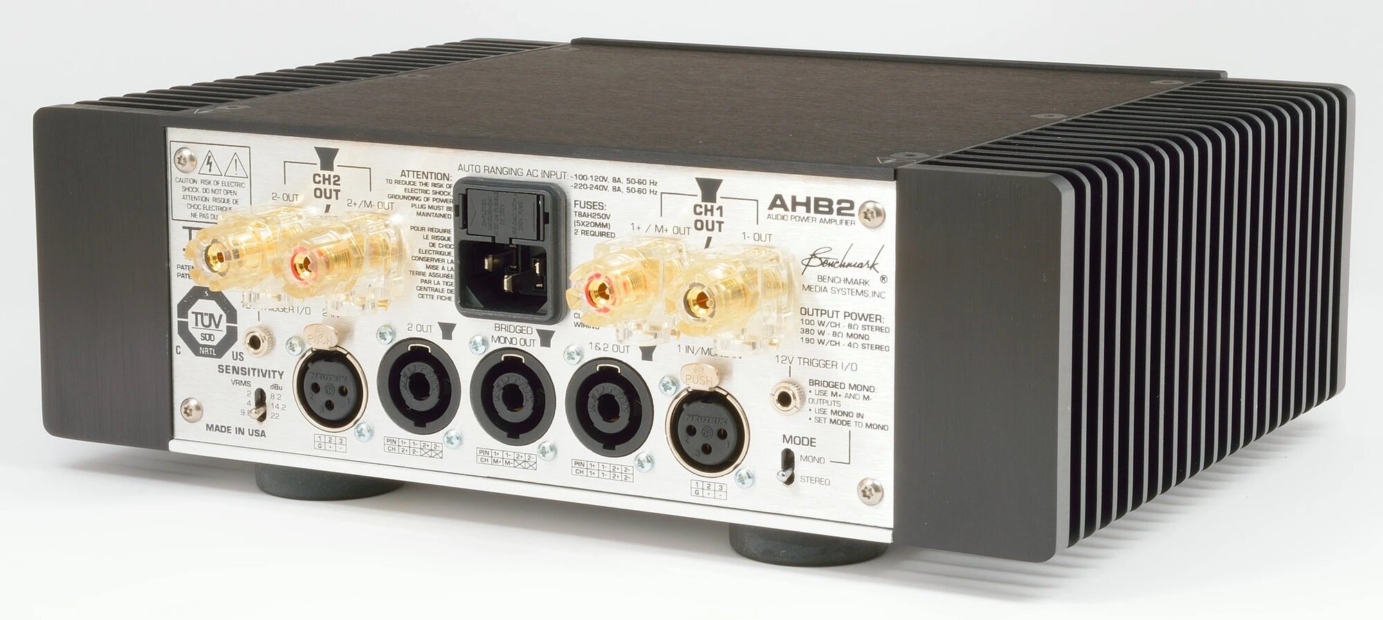

I think the main advantage of the Speakon connector is that it’s pretty much foolproof in a studio or touring band/roady type environment in a way binding posts of any quality are not. So it gets my vote for that but I’d be a bit surprised to find it on the back of a high quality amp.
...I’d be a bit surprised to find it on the back of a high quality amp.
Surprise!
In the (near) future your speaker will probably host a webpage like your router does, where after set up - you promptly forget it. (I dont know which "channels" my G and N bands are operating on, off the top of my head) Or maybe instead of fooling with cables and dc blocking caps, you now fool with numbers in a webpage tab.
TI was running a gig for a while where each board was $75. About $40 for a PSU+accessories was hard to argue with. I definitely need less power and a 3251 would have been a better match (if purely specmanship).
Anyhow, I know some of the TASxxxx series talk about it being a DAC + TPA32xx amp all-in-one, but that wasn't mentioned in yours. Doesn't matter, necessarily.

But no obvious disadvantage unless you are welding! I've used hollow bananas for the last 25 years (same speaker cables for the same time) and they've done the job but I've always considered the audiophile banana plugs that you shove bare ends into and screw down as a poor solution. Gas tight connections are good for anything that stays put for a long time...The speakon has some clear benefits but no obvious performance advantage over a good binding post.
I'm not welding. I also like to have the amps very close to the speakers.but none too compatible with large gauge wires. Certainly not the same as soldering a 10 AWG wire to the back of a big brass post.
You have all the fun toys!I can attest to passing 3000 amps through a binding post on a regular basis with a very low duty cycle and short (100 uS) duration showed no deterioration over many years.
Given my use cases include small beings co-habiting the listening space (and hiding behind my apogees when naughty) I have to consider risks and there is less chance of sparky bang with a speakon. A wipe of deoxit should prevent too much oxidation as well. But we all have different needs.
