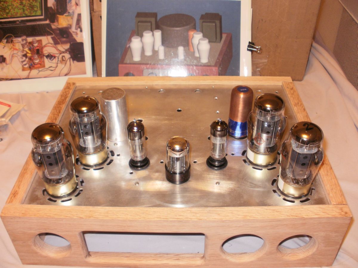

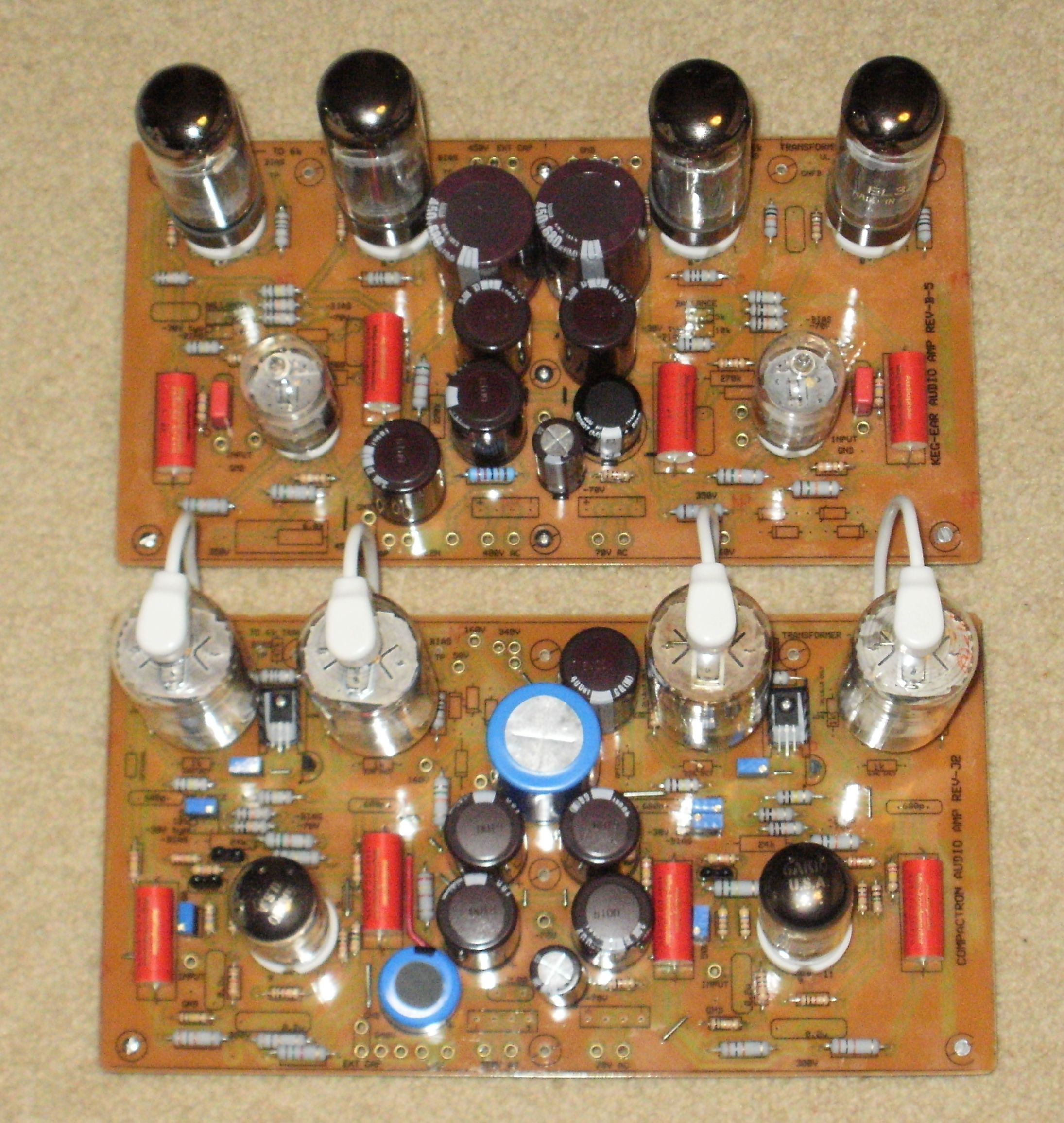

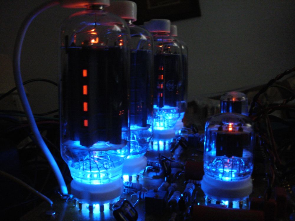

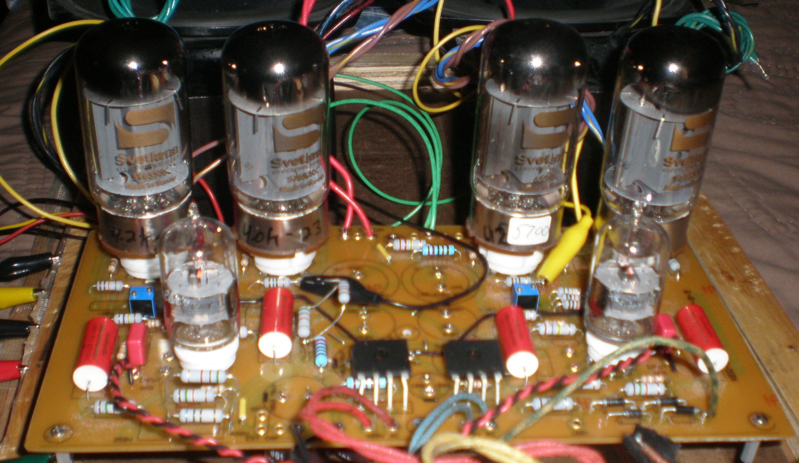

I consider the most important choice is the output transformer and them match output tubes and power transformer to it. Attached are a few photos of home designed PCB based amps made from the toner transfer etch method, one is 6550 based ( UL and triode) with Hammond 6.6k outputs and the other is a 6LB6 based ( triode) with Hammond 6.6k outputs.
Also there is a ST70 clone, at least that is where it started. The only ST70 parts in it now are the bias adjusting pots, everything else is modified. 1/2 PCB like the St70, but 6SN7 for the first gain stage with a LTP and constant current sink for the 2nd stage, 1/2 point to point wiring like the ST70.
If you do not want to do wood work, sheet metal work you can buy a complete kit, just some assembly required, or a complete white page everything from scratch. It doesn't really matter what you do as long as you learn and have fun while doing it. The enjoyment lasts for yrs as you enjoy the sound stage and clarity that a tube amp presents.
