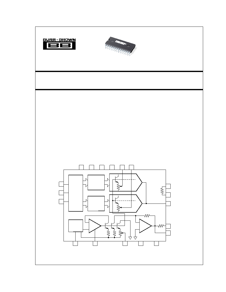

Luigi,
I found the data sheet. It is attached here.
Read page 7 of the BB data sheet for the DAC- last two paragraphs.
What you may be hearing is most likely, your transformer saturating with RF from the DAC. The data sheet suggests that the DAC be followed with a high-order filter (a very steep slope 24-36db/oct-9th to 12th order LPF around 22-25kHz)which is probably what you bypassed in the Yamaha. If you have access to a scope you will see all kinds of HF artifacts mixed with the audio signal.
What do you mean by balanced? You only have +signal and GND as outputs. To feed a balanced transformer input with an unbalanced source means you are unbalancing the input. A true balanced signal is + signal, -signal and GND. The negative (or 180 DEG phase reverse) is produced, usually by an inverting op-amp/ driver. This is a separate topic from trying to get a DAC to work without a LPF of some kind.
I get the feeling that you can't really do what you want to, in this case. Perhaps the better way to go would be to optimize the output section of the Yamaha unit with the best parts money can buy. Also, get rid of any electrolytic caps in the audio path or design a "servo"-style output which eliminates DC and the need for caps in the audio path in the first place, etc, etc. Op amps are not that evil, if done correctly.

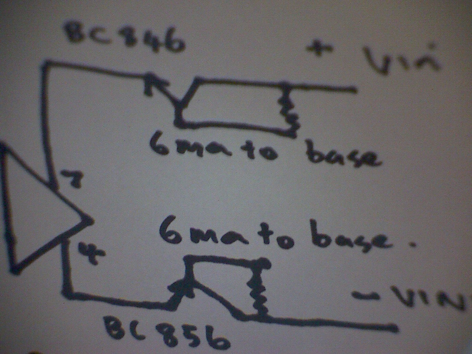

My blog page has plenty of info about op amps and mod's
opamp - opamp construction
Supplying power supply with surface mount transistors in a emitter follower configuration all on board the Brown Dog adapter is my latest venture, See schematic and blog
Stereo separation improves immensely,
Happy listening
Cheers / Chris

Well, went through your blog. using pass transistor makes sense.but then I have seen in old amps and preamps, that mfg used different powersupply for each channel. Also is recommended to use a pair of pass transistor stage for each channel instead of using it with every op-amp.
I got a more doubt after reading your blog. what was the selection craiteria used that made the new generation opamp sound better over the one of yesteryears. unity gain bw? noise? CMRR? PSRR? slew rate or something else?
Hi Aucosticraft
This idea, has provided lots of discussion in the Solid State section of the Forum under Powering Opamps. It is causing a lot of comment particularly concerning " subjective- what people are hearing " vs measured what is revealed by oscilloscopes.
I am providing some scope measurements later today, from the same circuit connected to a Marantz CD80.
My thoughts on how to describe it, and you would think someone after 58 years of transistor use would have connected a transistor this way, is that its closest description is that of a transistor connected diode, however it seems to improve with resistance between the collector and base, as I have designed, and improves again with load being drawn from it.
It also follows V+ V- less transistor junction, alluding ( where there has been much heated discussion ) , where I initially described it as an emitter follower, about its correct description. I have amended website description last night, awaiting better clarification
Subjectively when involved with opamps it improves consistently the spatial stereo information, that in my experience of op amps is a very good sign of improvement.
Cheers / Chris
