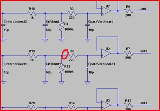

change the ratio of R5:R6 to see what happens when Mooly tells you to adjust the attenuator.
Try R5=1k0 and R6=19k.
Try R5=19k and R6=1k0.
Try R5=19k9 and R6=100r.
compare the three RF attenuations.
Now add a tiny inductance before each interconnect Cpara. Try 10nH.
This will create three cascaded 2pole RF attenuators.
Compare the RF attenuation.
Put one of the 10nH before the 1000p at the RCA.
Change the 1000p to 47pF
Change all the inductances to 100nH.
compare the RF attenuation.
I think you should be aimimg for F-1dB >=100kHz for inaudibility.
Andrew,
I did all those before I put the 1nF at the RCA jack. I understood it was not the proper way but it was purely a test to check if an RF shunt changed the sound or not. Moving it to the RCA jack eliminated the possibility of the troublesome 34pF at the +/- inputs of the opamps.
See below. I have added the inductance approximate to the interconnect lengths and set the volumn pot at 12k//8k (normal listening level), 19k//1k and 1k//19k. No significant high frequency rolloff. Again, I listen to music at around 12k//8k level.

I can't read the attenuation plots, but it looks like there is over a decade of movement in the RF roll-off frequency.
Now remove that 1000pF and put back in the 1k+68pF
1nf is too high to use on the output of an opamp (in practice).
Mooly,
Sorry for the confusion: The CD player opamp in the drawing does not exist in real life. It was a convenient thing for modelling a circuit. The Marantz SACD player uses HDRM or something. In any case, there is a 200R series resistor at the output of the HDRM first, then the output capacitor, then a series 50R, and a shunt 1000k to ground.
Let us say the CD output is an opamp connected to a series 200R resistor. In that case, would the 200R be sufficient to damp any possible overshoot / undershoot on a 1nF load?

either change R2 to 250r or add in the extra 200r series resistor.there is a 200R series resistor at the output of the HDRM first, then the output capacitor, then a series 50R, and a shunt 1000k to ground.
It won't make much difference, but 250r and 1000pF without any of the other RF attenuators gives RC=0.25us.
It's OK I suppose, 1000pf at 20khz has a reactance of around 8k ohms... most opamps will drive that.
I'm losing the plot a little bit here, your latest simulation has more coils and caps and potential interactions than a front end for multiband tuner lol.
If you suspect RF is entering the chain, one of the most effective quick fixes is to slip a ferrite bead over a resistor feeding the input to the first stages.
Shown in red here on one stage.
Mooly,
Adding more coils and caps in the simulation was done for Andrew on his request.
