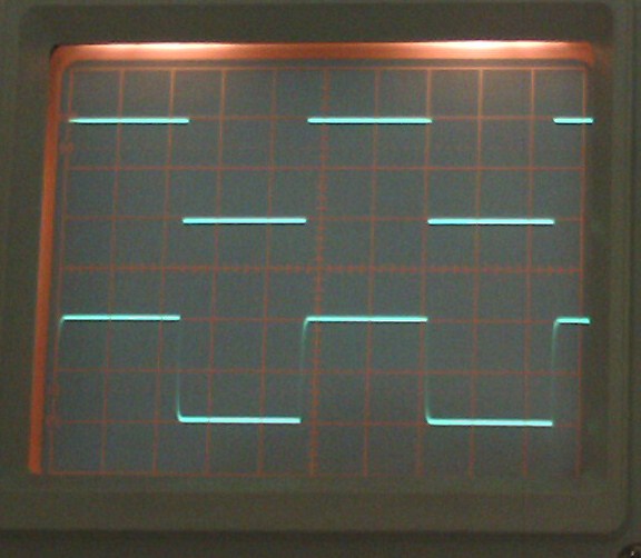

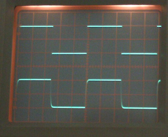

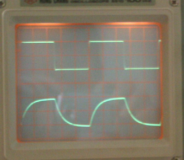

OK, here is the real measured and photographed effect of Bills 100 ohm + 68pf network.
Top trace is the "input" to the 12K + 8K "volume control" and the lower is the output at the junction "wiper" of the network.
First up for reference is 1khz and no cap, then 1khz with the cap. Then we have 10 khz with and without the cap and finally 20khz with cap... the top trace in all these shows the same as "no cap" anyway.
Now before you all get excited and say that the 10 and 20khz shows some roll off and limited rise time due to the cap remember to put this in perspective. So finally here again is the shot of how CD (any player) reproduces a 1khz square wave within the confines of a strictly limited bandwidth of around 20khz that the CD specification imposes.

So the effect of this RC network I don't feel can be audible as such... if it's really changing the sound as much as you say then something else is going on. You can't even really say that the effect would cause a loss of HF energy over several octaves as the reduction across the audio band (and well beyond) is just to small.
Dunno Bill 😉... you are going to have to measure for real your set up and confirm and identify what's really happening.

Wow, Thanks a million for taking your time doing and posting those. I am indeed excited.
However, I have not been able to understand them fully.
First did you mean 1k + 68p instead of 100 ohm + 68p after a 20k pot? Or, does your circuit contain 20k pot, or a resistor divider of 12k + 8k, plus 1k and 68p? - If a 20k divider is in the front then it does not matter much if it is 1k or 100 ohm anyway.
Secondly, is the top trace produced by one channel of the scope connected to the "input", and the bottom trace by another channel connected to the output, i.e. top of the 68p? So what is the exact meaning of "the top trace in all these shows the same "no cap" anyway"? The cap will still inflence the input, only with a corner frequency higher depending on the voltage divider values.
If the top trace is "no cap" and generates perfect square wave, do we see that the bottom traces are distorted, except picture 3 (10k with cap?)
How come picture 2 (1khz with cap) shows inperfect SW, picture 3 (10khz with cap) shows perfect SW, picture 4 (10khaz without cap) shows inperfect SW?

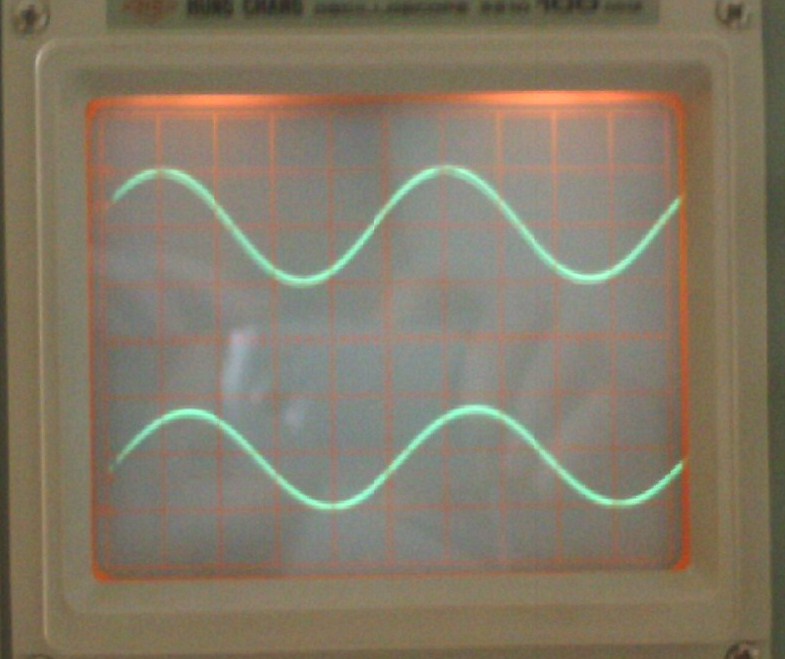

Does the last picture show the input and output of a CD player fed with perfect 1kHz SW? I failed to see any abnormalties. By the way, I have a collection of SACDs and they go much higher than 20kHz according to the SACD players specs. Indeed, when I do my subjective tests I use SACD mainly.
In any case, I trust objective measurements a lot more than subjective evaluations. But first I need to understand those pictures.

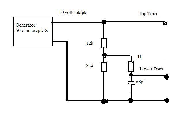

A confession... I used 100 ohm... don't ask me why, I scribbled the circuit down correctly... and thought I'd remembered it correctly as 100 ohm. duh 🙂
Anyway, the effect of changing the 100 ohm to 1k has no effect that you could see in a picture... the result is the same... and yes I tried it for real. Had it been different I would have repeated the shots, but there's no point, the difference was to microscopic to show in a picture.
What I did do while I was trying that (with the 1k) was measure the -1db point. I say measure because this is a real result taking into account the scope probe capacitance which adds to the 68 pf cap anyway (It's only a few pf for a 10 to 1 probe).
I set the voltage to 4 volts across the 68 pf cap at 1 khz and the output fell to 3.55 volts at around 197khz 🙂 I'm working in peak to peak measurements on the 'scope but of course if you convert to RMS it's the same.
This picture should clarify the measurements. The generator output is 50 ohm. I used an 8k2 rather than 8 k. Top trace is always the output of the generator. The bottom trace is the voltage across the 68pf cap... the signal that you are feeding to the opamp.
Edit... In all the shots above in the earlier post the pictures appeared out of sequence for some reason... if you hover your cursor over each then the description should appear... it does in IE8 anyway lol. If not this is the correct description/order.

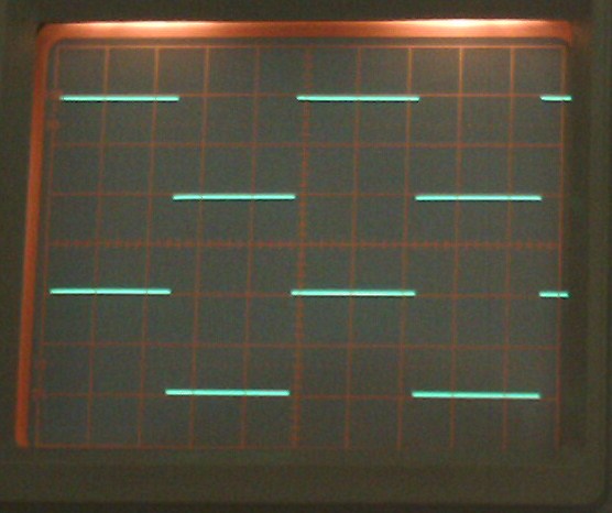

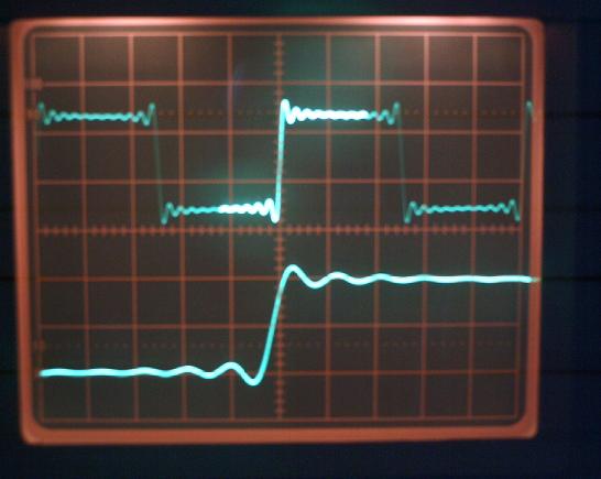

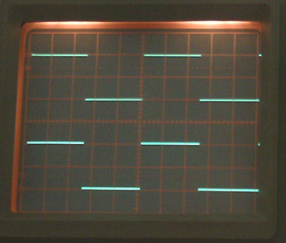

First piccy is 1k and no cap.
Second is 10k with cap.
Third is 10k and no cap.
Fourth is 20k with cap.
Fifth is the CD
Sixth is 1K with cap.

Thanks for your clarifications of the photo sequence and your nice drawing. Yes 100R or 1k should make little difference.
However, I am not sure if we could logically come to the conclusion that the 1k + 68p is inaudible.
If your "with cap" and "without cap" graphs all show identical square waves then a conclusion can be drawn that the 1k + 68p is inaudible.
However, the situation is that, other than the 1k graphs showing identical square waves with and without caps, at 10kHz and 20kHz the "with caps" graphs clearly show distorted square waves. We can only come to the conclusion that the 1k + 68 has not introduced distortion at 1kHz, but we can not conclude that it has not introduce distortions at 20kHz, indeed, the opposite is true - we can conclude that the cap introduces distortions at 10kHz and 20kHz (but if the distortion component is purely phase shift then such distortion is inaudible).
We understand that the rolloff above 20kHz introduces some tiny phase shift below 20kHz, which (partially or fully) contributes to the distorted square waves. This is expected. We also understand that phase shift at these frequencies is not audible. However, we have not established that the distorted square waves all come from the phase shift alone, but nothing else, unless the measured distorted square waves match exactly to mathematically derived waves introduced by the exact amount of phase shift of the 1k + 68p at 10kHz, 20kHz.
I am not saying that the 1k + 68p introduce distortions other than the phase distortions, as I have no evidence to suggest that. In other words, your "inaudible" suggestion may come out correct. However, I am only doing LOGIC here, that based on the graphs we still can not conclude that the 1k + 68p has not introduced other distortions (on top of the inaudible phase distortion) at higher frequencies.
