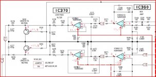

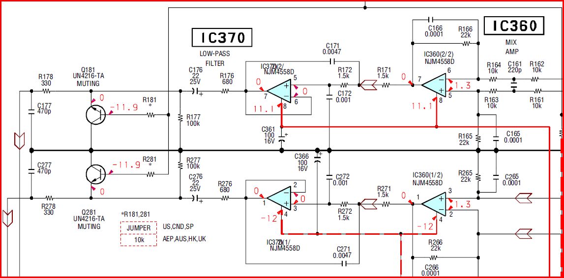

Don't forget C317/318/319 320 on the main PCB are used to provide a low impedance path to audio... more important at hf when the open loop gain of the amp is falling.
Muting transistor... never had any (serious) kit that used that arrangement so can't say one way or the other. In theory they are "non existant" when off, although some may argue that a varying signal might alter the junction capacitance etc thereby affecting the signal, particularly if fed from a high source impedance... just remove as a test to see 🙂
Diode bridge is fine... I see it has a snubber network on the secondary winding. That's good... I also like to add a small (0.047uf approx) across each individual diode too in the bridge. Diodes cause something caused "commutation" noise as they come in and out of conduction... I first came across that on a small Hitachi radio that buzzed on audio on FM... a single cap across the transformer secondary stopped it completely.
Opamp decoupling... well the correct way is not to feed supply variations into the grounds, however you are stuck with the PCB layout as is so. I would add a small 0.1uf or so directly across supply pins, not supply to ground.

You know what? I think I won't touch the Pioneer. It's good as it is (listening to the Jayhawks' "Hollywood Town Hall" right now)...and I voiced my DAC with it. if I want something different, I'll buy the Yulong amp.Don't forget C317/318/319 320 on the main PCB are used to provide a low impedance path to audio... more important at hf when the open loop gain of the amp is falling.
Yeah, I knew about commutation noise in diode bridges. I used to bypass them too.Diode bridge is fine... I see it has a snubber network on the secondary winding. That's good... I also like to add a small (0.047uf approx) across each individual diode too in the bridge. Diodes cause something caused "commutation" noise as they come in and out of conduction... I first came across that on a small Hitachi radio that buzzed on audio on FM... a single cap across the transformer secondary stopped it completely.
Good to know, thanksI would add a small 0.1uf or so directly across supply pins, not supply to ground.

Ohhh.... you mean you won't even try a different opamp lol
If you are happy keep it as it is 🙂 .... but then again, you are a tweaker 😉
I'm ashamed 😱Ohhh.... you mean you won't even try a different opamp lol
Alright...gonna make the parts order now 🙂
That's more like it... I think I would just try the opamp first... then listen
Also... make up a test lamp (100watt filament bulb) that you can put in series with the mains to the amp. Just to try each time you mod it... just in case anything untoward has happened, solder blob, short etc... it saves the amp self destructing. Test with that with no speakers connected, then remove the bulb before listening... if you leave it in the amp can't draw enough current and may behave unpredictably.
Also measure the DC voltage present at the speaker outputs before you reconnect them... always be sure.
Thanks...but I don't think I'll follow the lamp suggestion. Usually I'm pretty precise in soldering...instead I'll definitely measure DC voltage across the speakers after any opamp change, just as the good praxis commends. 🙂
