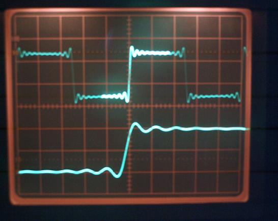

With all opamps you MUST correctly deploy them... and that means making sure the compensation etc is optimised... otherwise the tests are meaningless.
You could take 10 opamps and drop them in a simple test circuit and aply a 5 khz square wave and all would look different on the scope... you MUST compensate the devices. Even the stray circuit board capacitance has a huge effect on the overall result and must be allowed for in the final design.
As to offset voltages. You just don't understand the way opamps work to say that the LT1364 has a huge offset and will kill headphones...
Noise is probably the least important parameter for anything other than head amps/mic amps etc and even then the lowest noise devices aren't always what they seem in audio. Once again it comes down to optimising the design and something like the NE5532 or LM833 will give just about the lowest noise possible at the impedances we use for audio.
Andrea... you mention slew rates... have you seen what a 1khz squarewave from CD looks like... any player will show this the same. By the time you get to 6 khz or so it's triangular.
This is 1khz off disc 🙂
