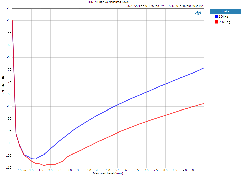

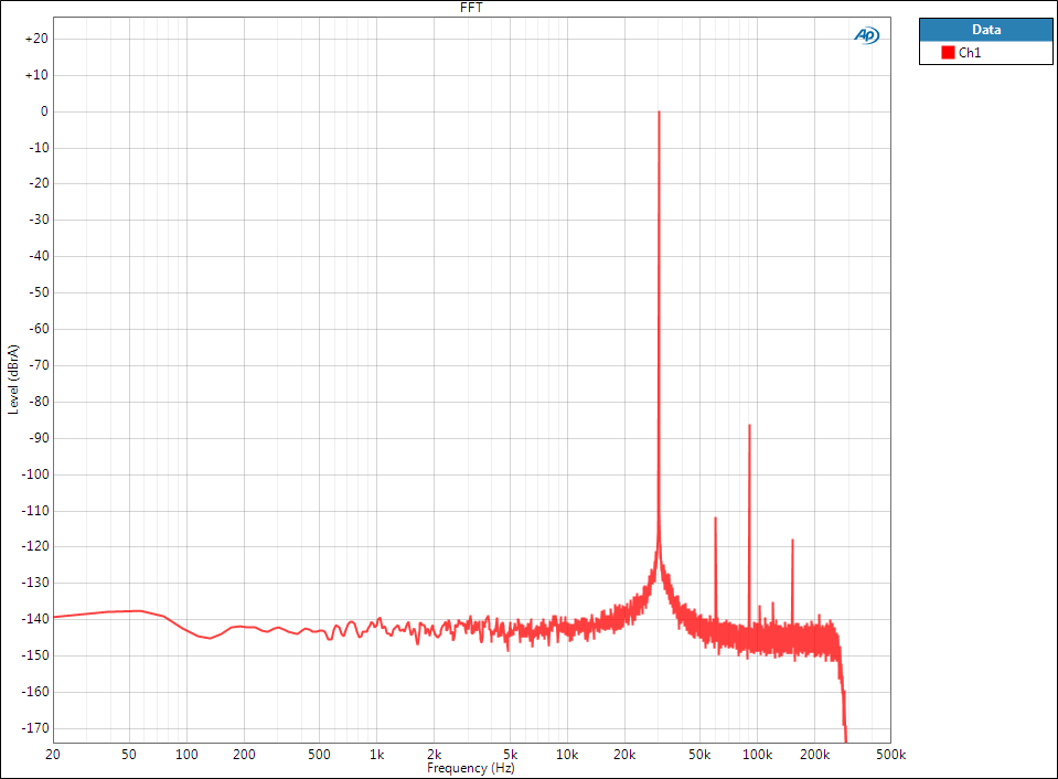

As JCX points out, input stage distortion starts well below slew rate limit, and is a function of input differential voltage. Here is a plot I took this afternoon of an OPA227, in a gain of one, 100kOhm load, +/-18V supplies, 250kHz measurement bandwidth. I measured the THD+N for increasing output amplitude at 20kHz (red) and at 30kHz (blue).
At 30kHz, the slew-rate limited amplitude would be 8.626Vrms (12.2Vpk). But notice that there is no sudden change in the THD+N at this point. The THD+N just continues its rising trend that began even at modest output voltage levels (1.25Vrms). At 20kHz, the slew rate limited amplitude should be 12.94Vrms (18.3Vpk) which is outside the test range. However, again, there is a rising trend of distortion with amplitude.
Looking at the FFT for a 5Vrms 30kHz fundamental shows the telltale 3rd and 5th harmonics indicating input stage distortion. The input stage transfer function is a hyperbolic tangent, which only has odd harmonics (The 2nd harmonic is large signal distortion from the output stage).
The transconductance of a differential pair drops significantly as the differential voltage increases. This can be linearized with degeneration resistors but in op amps designed for DC precision these are avoided as they increase offset and noise. Other techniques can be used to flatten the gm vs. differential voltage curve, such as slew-boosting. In a slew-boosted architecture the op amp increases the differential pair tail current in accordance with input differential voltage. But I don't think this technique was around at the time when the OPA227 was introduced.
