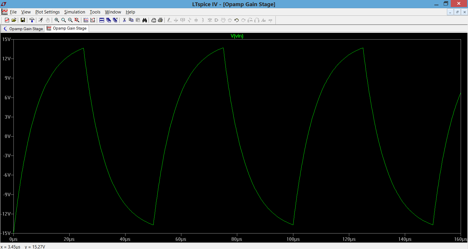

slew rate requirement has to be normalized to output Vswing - you need 10x as much slew rate for a 10Vrms output vs a 1 Vrms Vout swing
so it depends on application whether a 2.3 V/us slew rate is adequate margin over the signal slew rate to avoid increased distortion
and the increasing distortion with frequency is plotted in the datasheet for 3.5 Vrms - the 227 THD is 40x worse at 20kHz than 1 kHz
I think the slewrate of the opa227 is enough for Audio. Douglas Self wrote you nead at last 1.9V/us. And the advantage of the opa227 over the lm4562 is the Noise -109dbv, lm4562 -106dbv.
1.9 V/us would just cover a 20kHz sine at 15 volts pk/pk swing... max opamp levels in other words.
If you know the slew rate of the opamp and the maximum output level you require then seeing if the opamp can cope becomes,
f = Sr/(2pi * vpk)
So for an opamp of 1.9 volts slew rate and needing 15 volts peak swing we get 20160Hz which is Dougs 20kHz 'opamp level' figure.
A squarewave test would look something like this give or take. So the next question... is it enough ? and the answer is yes assuming a source such as standard CD.
