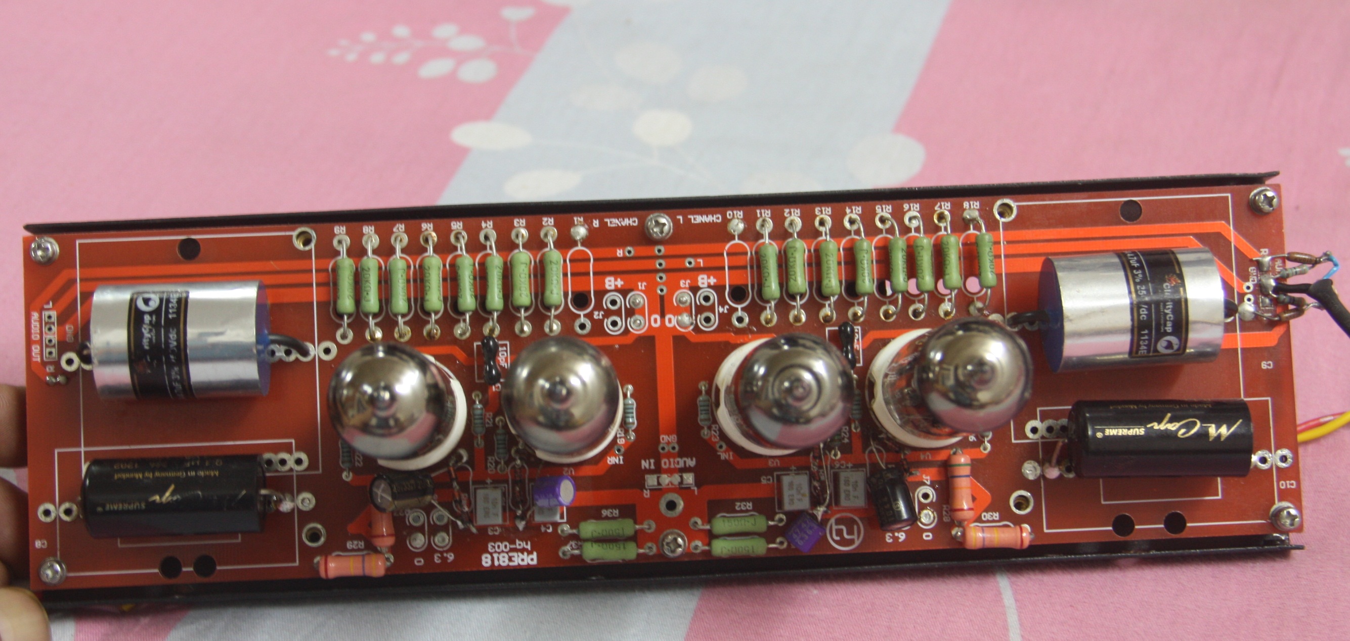

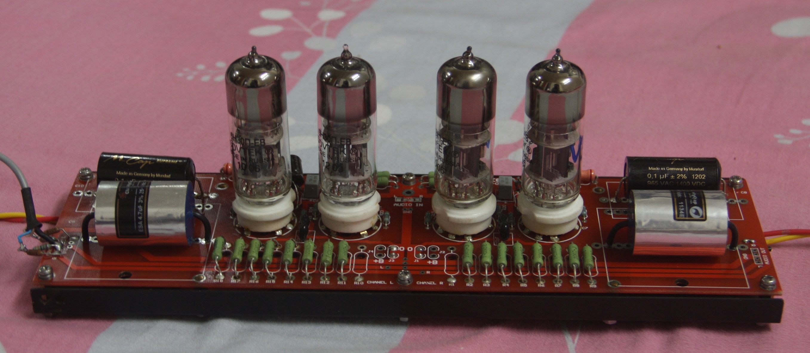

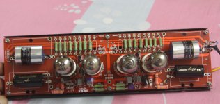

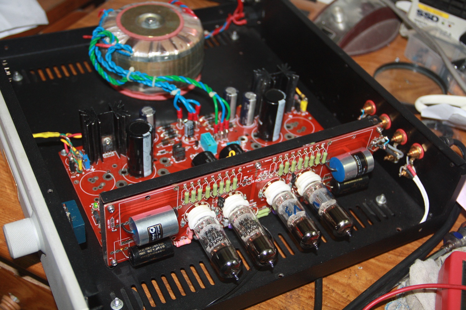

Yes, that is reference pre for my systum .
use 6h6, anode 150 v to 170 v, 5 -10 ma for 1/2 tube.
6h30 ,it best th choice. Thank

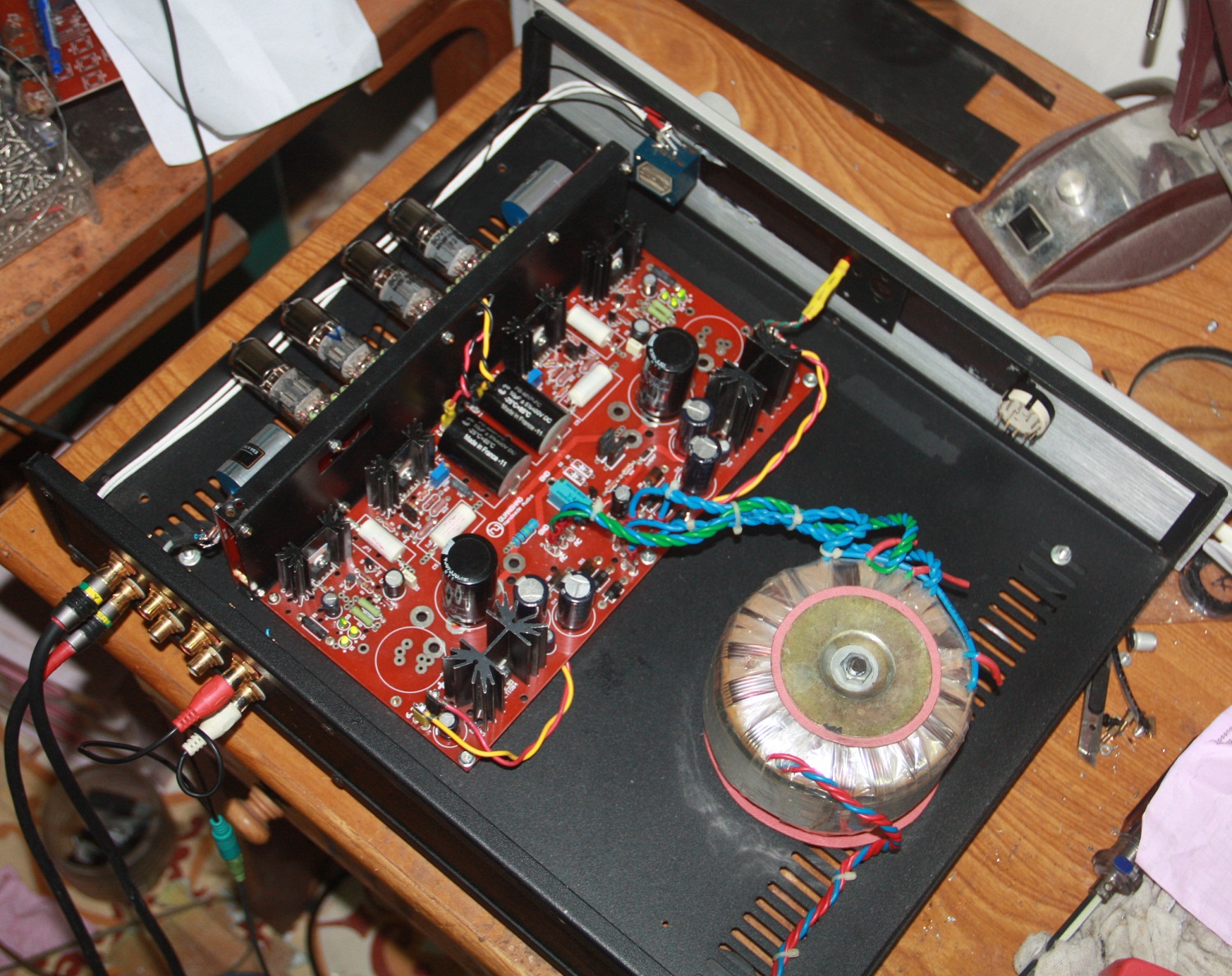

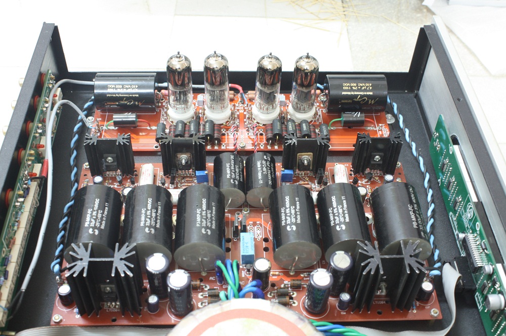

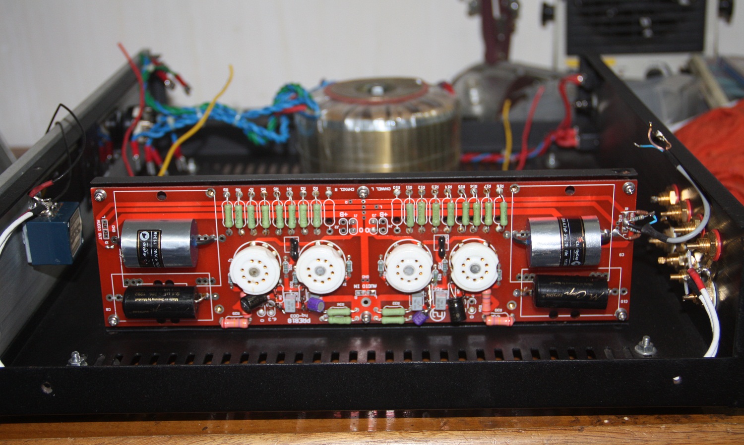

this is PRE 818 update, I use all Cap MKP for power supply, and use tube 6h30 DR + R2R volume control

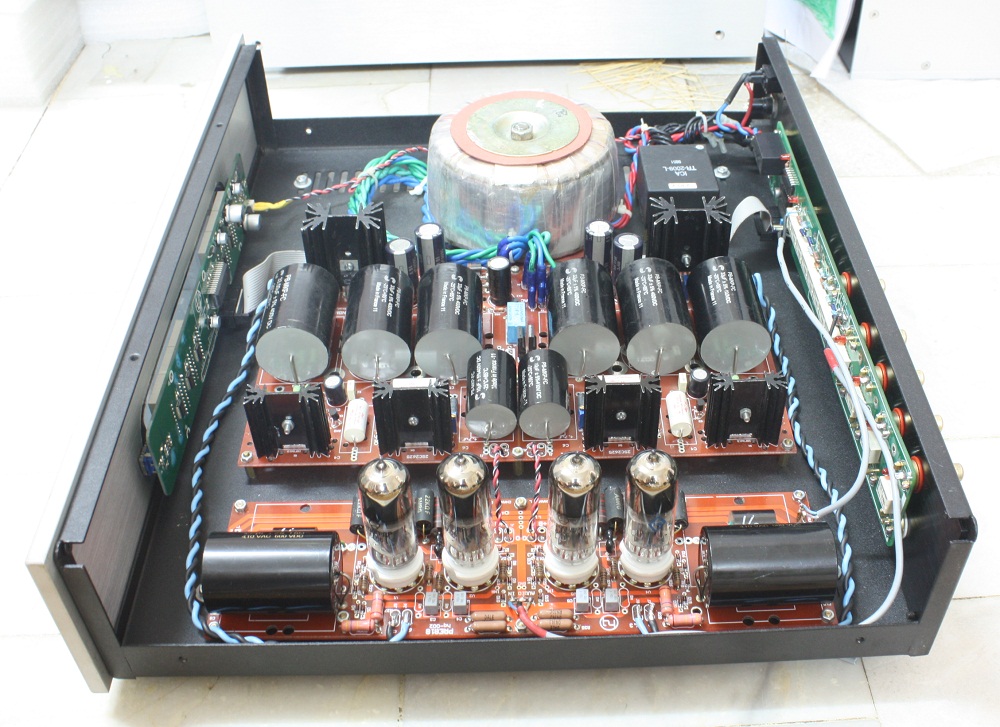

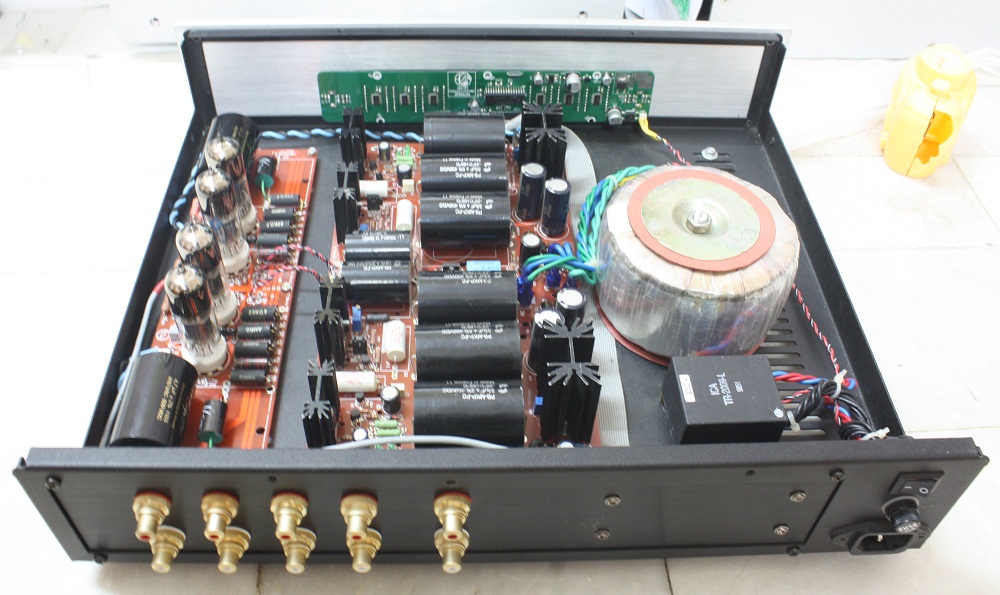

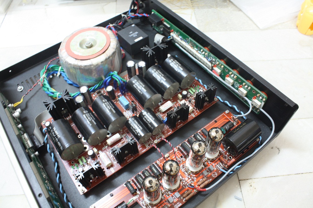

and new my pre update !

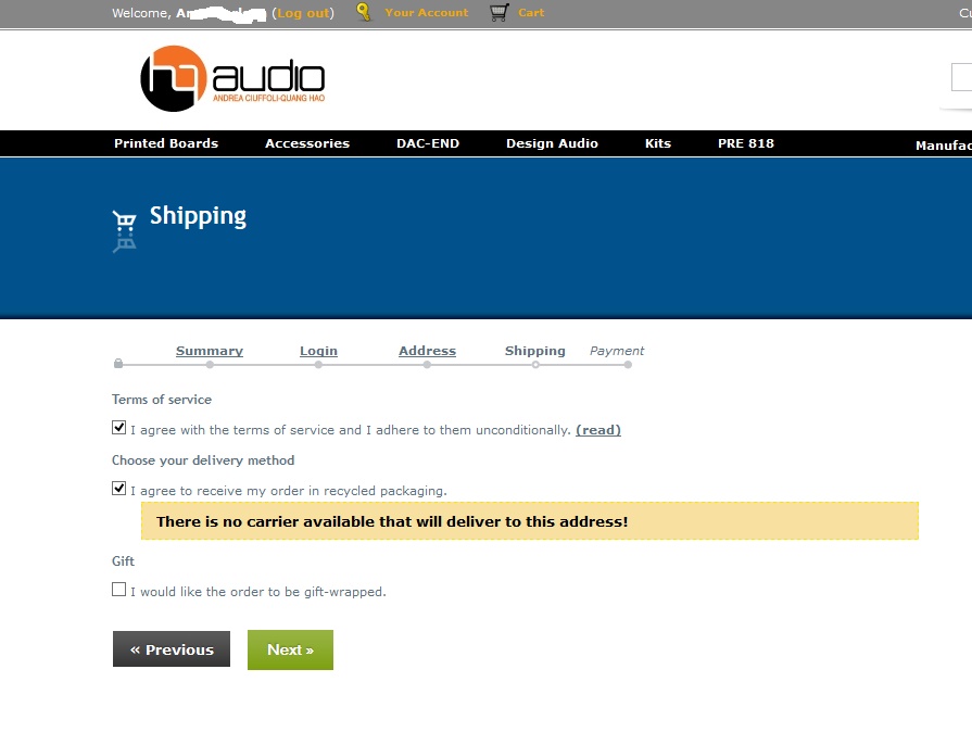

I have tried several times... but get error message trying to order anything from Quanghao.com
<<There is no carrier available that will deliver to this address! >>

Hi quanghao,
i have some questions. At the output is used a 4,7uf Capacitor. Why are you using this large value?
The capacitorat the grids are 1k. I think its the protection for oscillation. So this value is not critical. I want to use 150 Ohm, cause i have this in stock.
