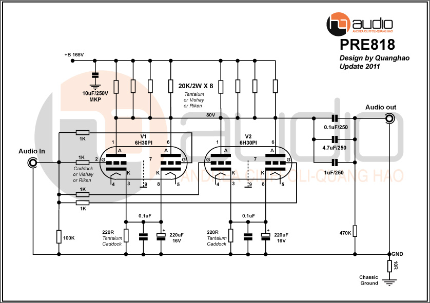

I looked carelessly at the schematic and did not notice the added capacitor from the grid to anode.
But I could not find that there would be 4 tube halves ( 2 x 6N30P) in parallel.
Is it really so ?
Dual triode and the schematic seems to indicate two tubes, each pin has two pin numbers associated - presumably this means there are 4 sections in parallel. I'm not sure, language and drawing issues confuse the matter.

You've just forgoten the "magical" deliberatly added 10pF that makes this preamp "the best" 🙄
Here is "The Better Preamplifier Of The Whole Know And Unknow Universe" :

Sorry, my mistake. I must have counted grid connections instead of grids!artosalo said:But I could not find that there would be 4 tube halves ( 2 x 6N30P) in parallel.
Your preamplifier will sound harsh and clinical, even though it will measure almost perfectly.Yvesm said:Here is "The Better Preamplifier Of The Whole Know And Unknow Universe" :
It's not really clear to me whether it uses 1 x 6N30 or 2 x 6N30, the tube is a dual and the schematic implies to me based on the pin# shown that there are in fact 4 triode sections in parallel.

hi quangho, mind sharing your rationale for paralleled tube sections? have you tried the 6080 at such levels of voltage and currents?
I think you need at least 6-8 sections in parallel to call it the "best preamp" 🙂

that is circuit of my PRE
i understand your circuit, what i want to know is if you match your tubes for transconductance between sections and between tubes?
or do you just stick them in like i do?

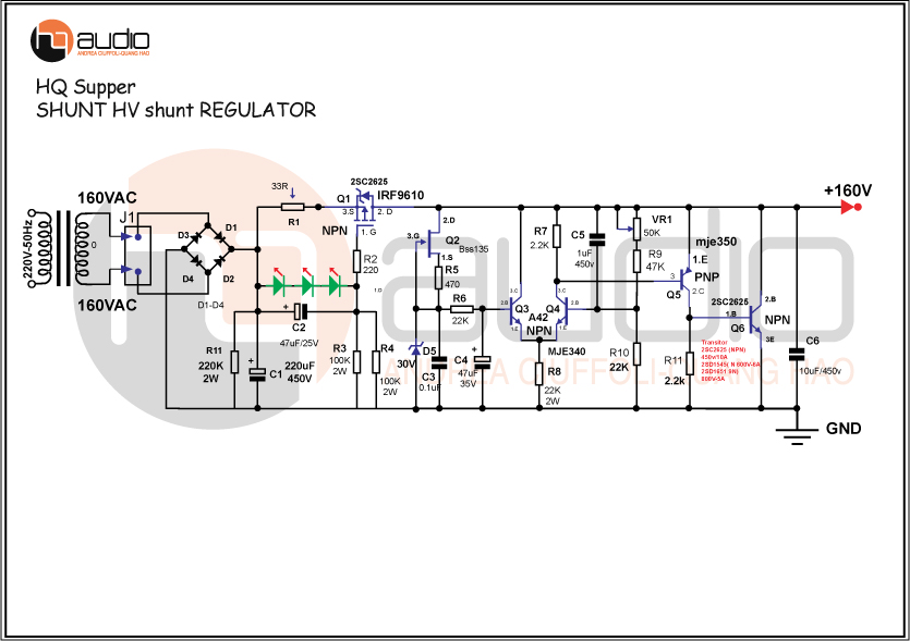

I use Hq supper shunt HQ regulate for My Pre
And use Salas CCS for it! I'm Thansk Salas very much!

please make it follow all the value!
The cap 10nF, if you not like it, you can remove it!
The supply you can use SSHV shunt! it is good!

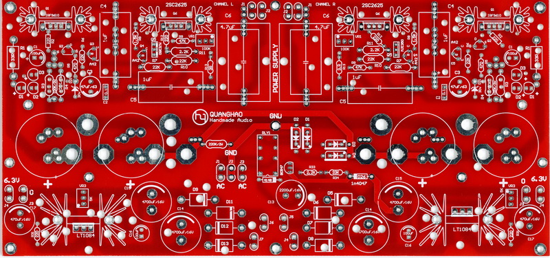

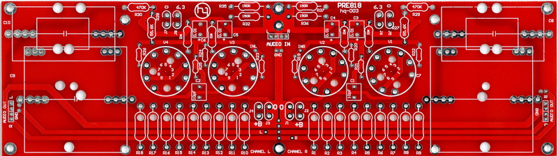

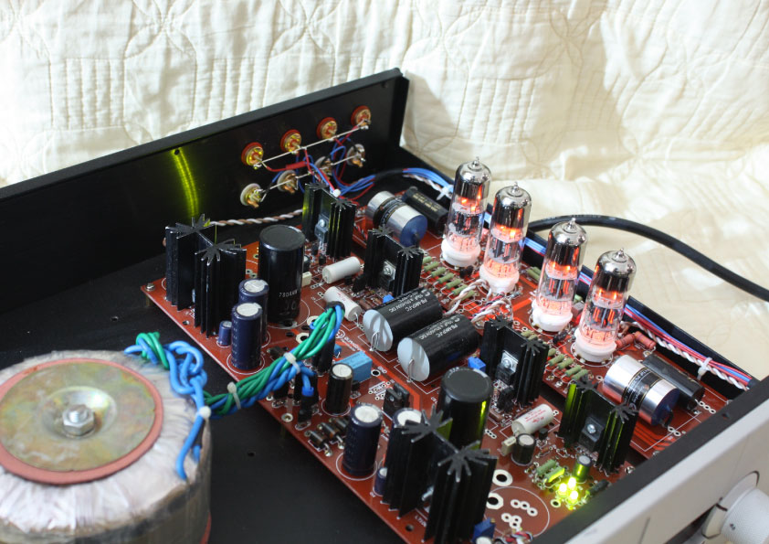

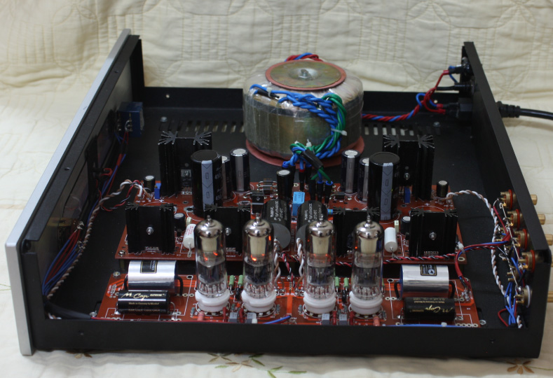

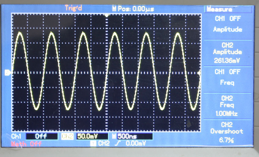

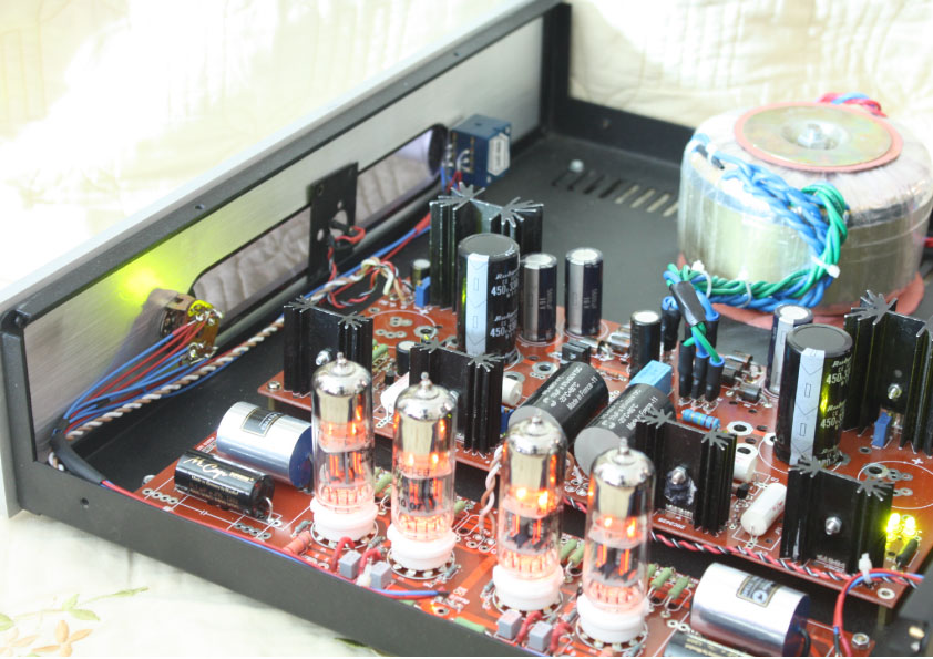

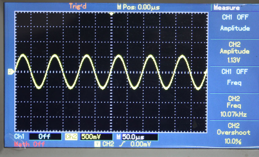

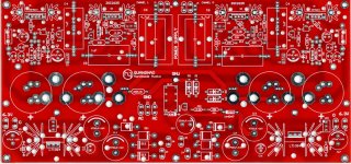

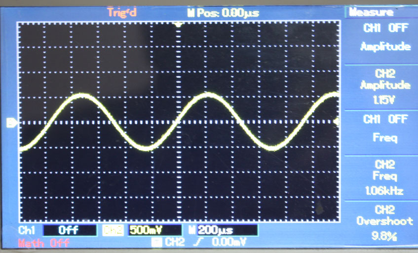

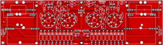

This circuit for PRE818, and some pictures, I have done it

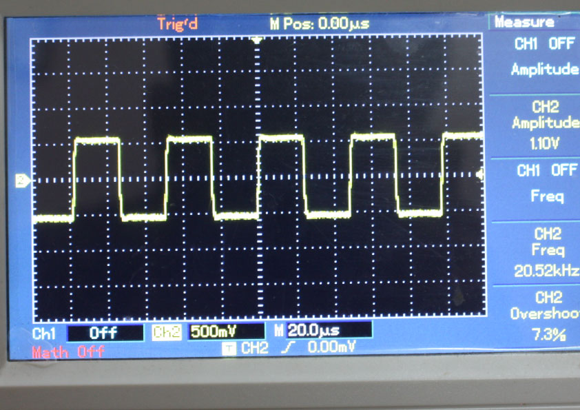

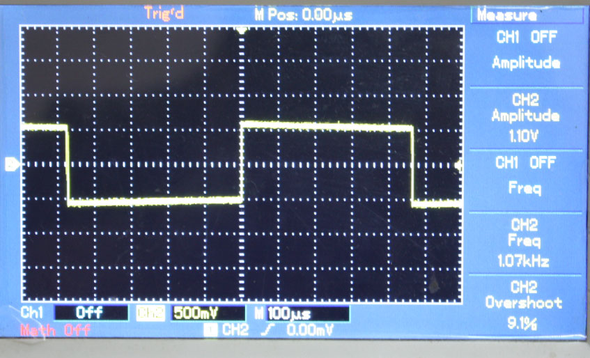

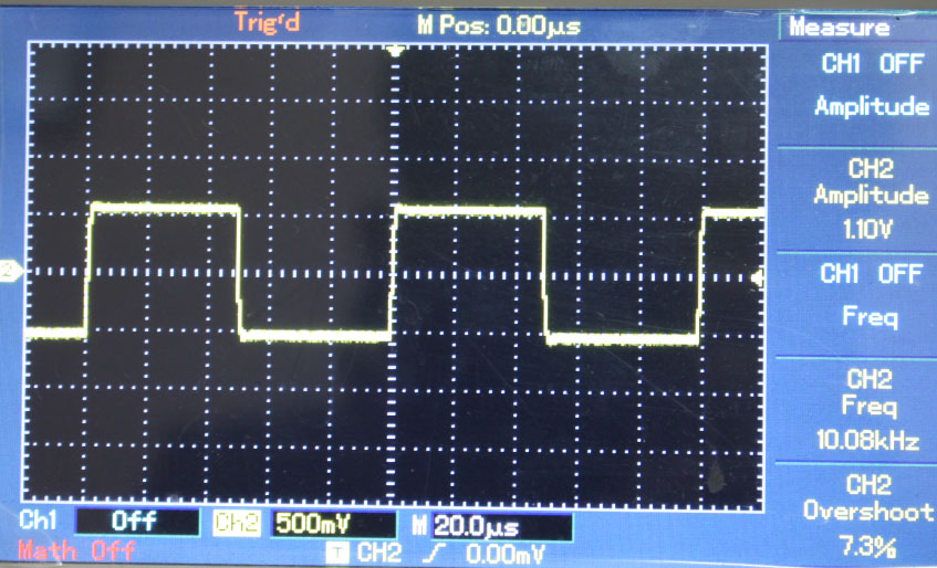

and some of my images measured Pre818
