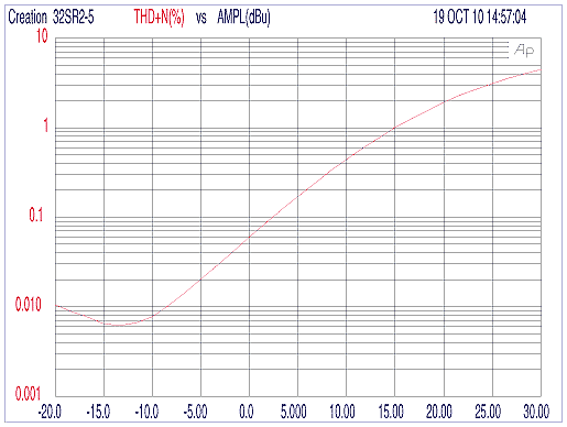

Interesting.!
You just have to listen to it to know distortion is not an issue here.
This is what I have from the manufacturer using an Audio Precision Distortion analyzer , for normal CD output of 1 volt as you can see the distortion is below .05% even at 2 volts which over exuberant Telarc and such used to get to, it's still .1% or less. And if you use the LDR's series and shunt arrangement as the mkII Lightspeed has it's even much better than this.
And what distortion that is there is 2hd in nature which is pleasing to the ear just like tube power amps which have more 2hd than this, and don't get me started on the distortion of speakers that is in the percents.

Hi george,
This is an interresting supposition. You are familiar with psycho-acoustics? And the fact that some times a distorted signal can sound subjectively better than an undistorted one?
The 0dB reference is set at 1V?
In this case I see 0.06% at 1V and 0.2% at 2V.
I personally live with such levels of THD in non-feedback audio circuitry (even more) but I would not class the results as "inaudible" and lower levels are achievable in zero feedback tube circuitry.
I may have ered here I believe it was at 60v not 2v this is the heading for that graph
" Figure 6 depicts a plot of THD+Noise vs. signal level for a NSL-32SR2s 60 V rating"
This newer graph "attached" shows distortions well below .05% at anything below 2.5v output and CD barely gets to 2v

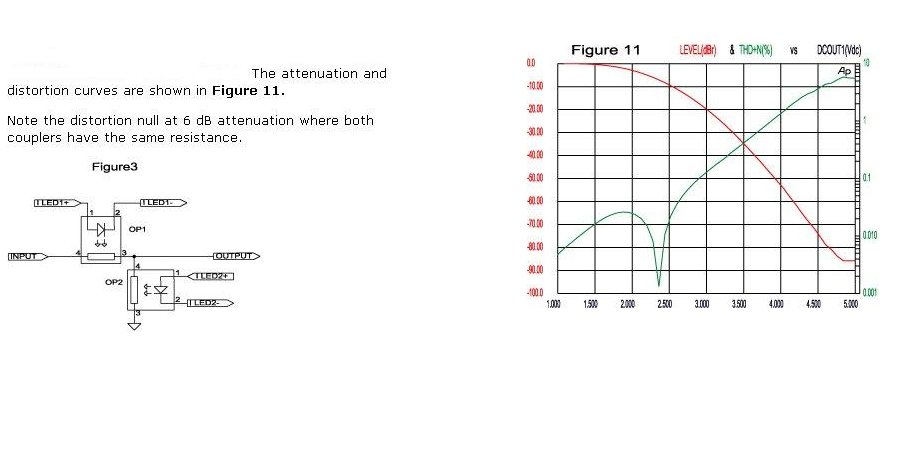

Cheers George

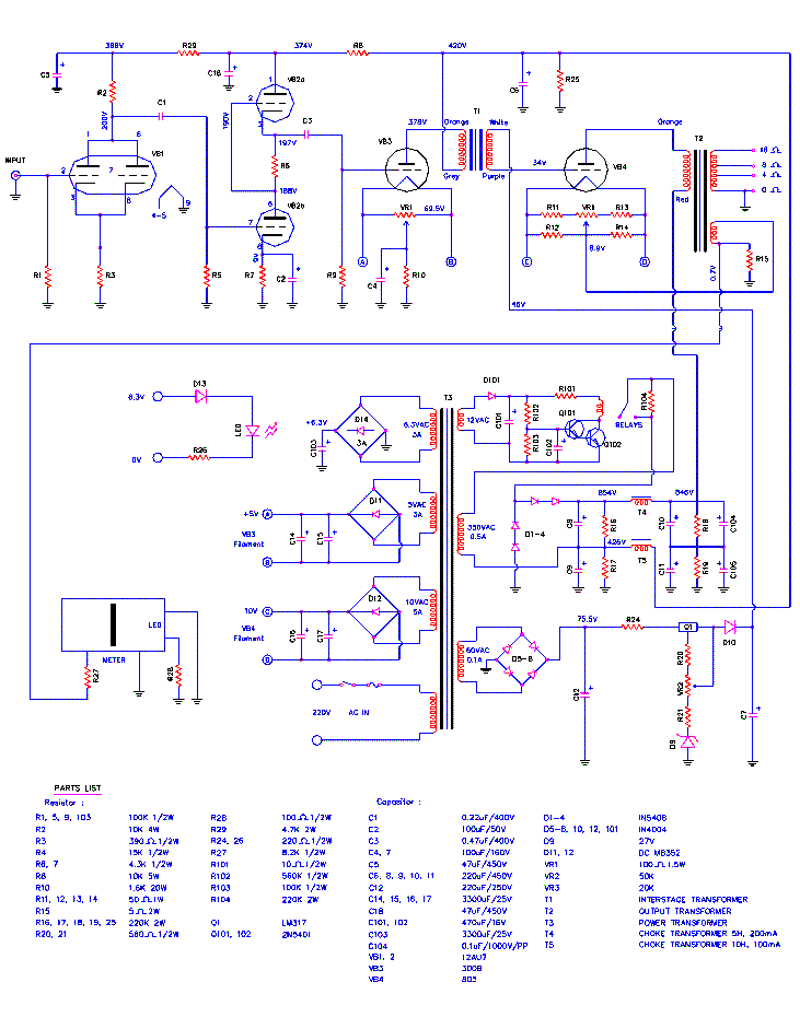

You may get a kick out of the 805's I built Thorsten, here is the poor schematic I have left, good one went with a computer crash.
Input = 13D3
Pre driver = 12bh7
Driver = 300B
Then the Interstage transformer
Ouput = 805 RCA
900v anodes!!!!!!!!!!! I got rid of them before they killed me.
Cheers George

I may have ered here I believe it was at 60v not 2v this is the heading for that graph " Figure 6 depicts a plot of THD+Noise vs. signal level for a NSL-32SR2s 60 V rating"

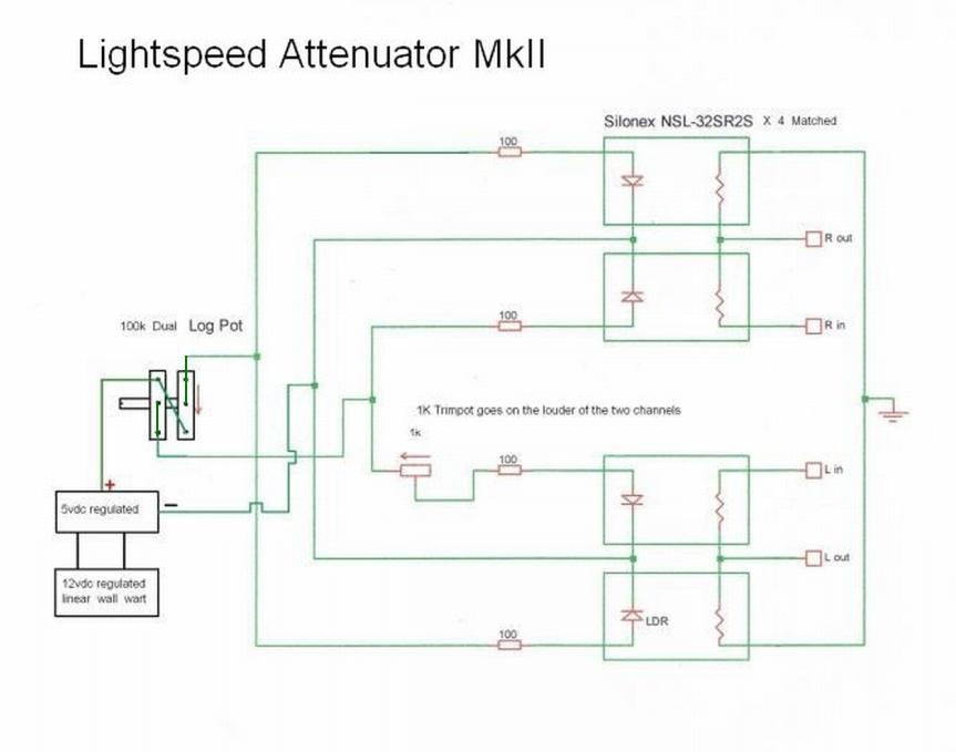

Ahhh, so this is actually not a measurement of your actual unit, but from the manufacturers website.
Looking at those I am uncertain you interpret them correctly.
I am not too sure either, as there is a fair amount of unstated conditions in the test data on the Silonex Website.
Looking at the new figure, it appears to use a signal level of 10dBu (2.449V RMS) and shows drastically rising THD as the attenuation goes up.
Minimum THD is at -6dB and near full level, with a 20dB attenuation THD is around 0.2% and at around -45dB attenuation we get around 1% THD.
